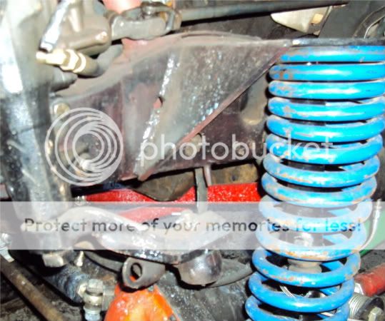

well thank you sir, but yeah mine was was very cheap, less than $ 20 for the materials for the coil buckets, panhard bracket and still had some small pieses left... plus mine was very basic and looks good i think... but if you do copy mine, make a coil retainer for the top too, you dont want the coil dropping out :annoyed:
i wouldnt try and modify the stock ones by spacing them away from the frame, thats booty fab lol
sorry for the dirty pic :(
