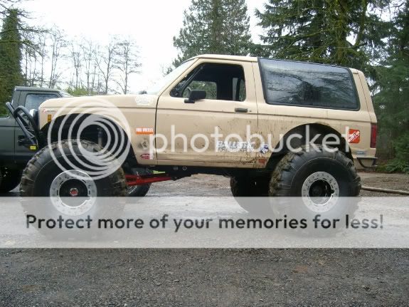

43" tires on a BII
Dont second guess yourself. You had a plan when you did your BII. Stick to it :) Besides, your BII looks like it could eat a jeep alive. Keep it just the way you have it!
I hate you.:thefinger: I'm just finishing up my BII and now you have me second guessing myself. Im sitting at about 8" of lift on 37s. Thinking I need to lose two or three inches and take more out of the fenders.
Looking good, cant wait to see it when its done.
-Jester
Dont second guess yourself. You had a plan when you did your BII. Stick to it :) Unless you are willing to relocate your axle forward, then you need that height for the 37's to clear the firewall. Hell, im scooting mine forward to the point of hitting the front grill to clear these. But then again, im willing to chop my BII up to the point of looking goofy to get it to perform better.
My axle is already forward, 6". It would be pretty easy to lose 2", lose the blocks in the rear and take 2" out of the front shackles. I'll have to see how it works, if it feels too tipsy I have options:D. I'm not afraid to chop mine, its not a daily driver it still frequents the pavement so it needs to be legal and somewhat comfortable.
Here is a pic of mine before any fender trimming.

Hijack: How is that D44 holding up with those 42s?
-Jester
havnt actualy broke anything, but i completly rebuilt it when i started, but i also know its weak, so i drivel like that lol, i didnt plan on running this size tire, but i got a good deal i couldnt pass up.. so for now it is what it is till i can get some money back in savings.. :)
one other thing though, my buddy is running a ranger with 42" iroks, and we have wheel hops bounced that thing a few times on the rocks and surprisingly didn't break it. so i dont know.. I JUST WANT A 60:bawling:
Your rig is not bad at all. A little tall, but nothing that screams "TIPPY!" Its about normal. Tell you what. Split the difference. Get bigger tires!
A quick way to tell your tipping point: Take a frontal picture of your truck at ride height. Draw a line from the bottom of a tire to the opposite corner of your hood. That is your safety margin. If that line passes vertical, then your going to tip. The taller the truck, the sharper the angle of that margin.
My axle is already forward, 6". It would be pretty easy to lose 2", lose the blocks in the rear and take 2" out of the front shackles. I'll have to see how it works, if it feels too tipsy I have options:D. I'm not afraid to chop mine, though its not a daily driver it still frequents the pavement so it needs to be legal and somewhat comfortable.
:icon_rofl:. That makes me feel better about my 37s on my HP44.
-Jester
Thats an option too, I have the gears for it(5.13). Great tip on the tipping point.
