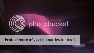

We have on one hand a converter that was (justifiably, in my mind) gutted because it was glowing red.
We have on the other hand a 4.0 that is getting 11 MPG.
Anyone think there might be a relation between the excessive use of fuel and the melted down converter?

See^^^^ real plugged converter on my truck
Gutted it, will replace after mileage issue is resolved.
