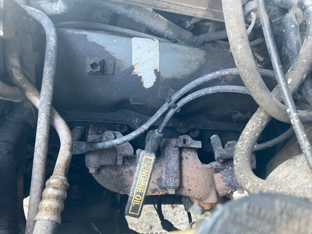

Was suspecting that my engine needed new o2 sensors, according to rockauto they are different for cali and fed emissions. Attached are some pictures of relevant markings. Note that I don't know if the radiator support is original, the vehicle was in a front end collision a few owners ago as far as I can tell and the support is black when the truck is green. There is a very EGR-looking device between the exhaust manifold and intake, though if it is indeed an EGR that is a stupid design to put the EGR before the MAF and air filter.
I also have codes 172 (lean bank 1), 176 (lean bank 2), 136 (not switching bank 2), & 411 (KOER low speed idle test fail), what are the most common problems to cause this?

High idle & lean codes really point to a vacuum leak in my mind.
That deal on the air snorkel is not EGR, it's basically just a little valve that allows hot air off the exhaust to get pulled into the engine in cold weather.
Glad to hear it’s not an egr

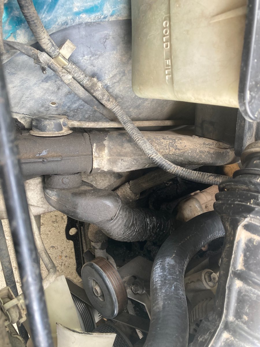

Something I forgot to mention is that I’m getting pretty poor fuel mileage, wondering if that fuel pressure could cause worse mixing and lower mileage. I have learned over the year that I’ve owned this truck that everything the last few owners did to it was done wrong (Chinese wheel bearings with finger tight locknut, broken clips everywhere in the interior, left with terrible front alignment for a long time, radiator replaced with junkyard one and lost the shroud, transmission fluid seemingly never changed, etc), so I’ve been looking over everything adjacent to the problems it has for poor work quality.
I'd expect it to work exactly once. Then the gas would dissolve a seal or something.
Could the radiator and shroud from an ‘02 SOHC fit? My friend is scrapping his that rolled off a cliff
