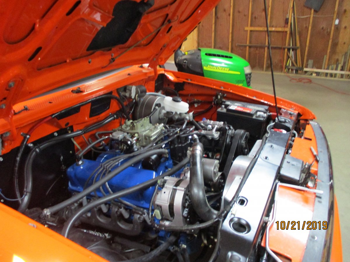

I think the 351 will correct the power situation in my 93. NH has OBD II emissions testing on everything under 8500 GVW that's 96 or newer, would a carbureted V8 swap be legal in Texas?
That does look nice. I had a bronco with the 351 and loved how it pulled. Just didnt go fast. Is there alot you can do to the 351 to get the speed out of it.
