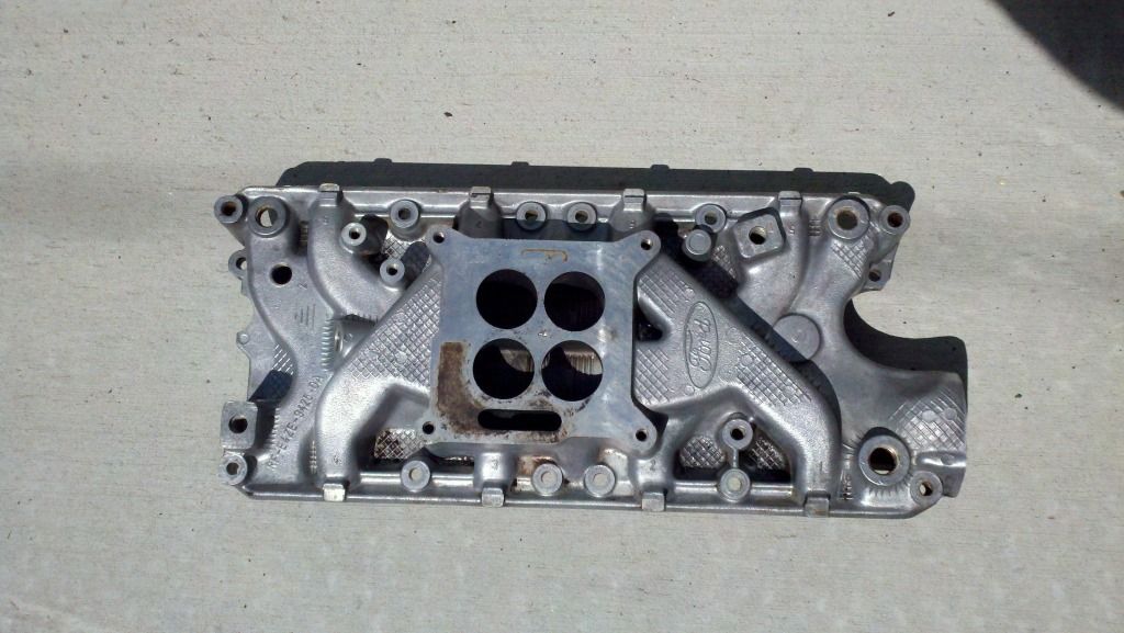

Just throwing this out there.... I have a really nice intake off of an 85 GT I am going to be listing in the classifieds.
