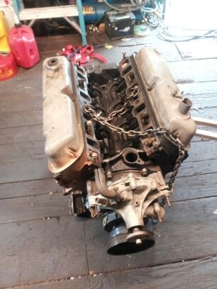

The motor is from a 95 f150 and the only reason I ask about the 351w heads is because a friend of mine said he had some he would give me to put on ... The heads I have are in really good shape and it's a roller motor ... Well it has the roller rockers and hydraulic lifters ( idk if it has the roller cam) most likely not but I only thought about it because I'm having a hard time finding a stock intake ( upper and lower ) and idk what intakes I can use because I just see a lot of people posting that there intake will only work for motors up to 93 and all sorts o different years I was under the assumption that a 302 efi intake would fit?

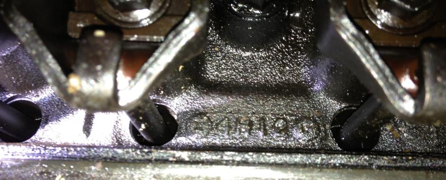

get a picture of the front of the passenger side head kinda close if you can.
likely its a normal truck head.

Ok I took a picture of it it has the numbers 23 and then a one inch gap 0 and then another gap and 06 this photo won't load and idk why and right next to the valve cover there's a T
This is the picture
  • 302 with 351 Windsor heads ?
Other pic

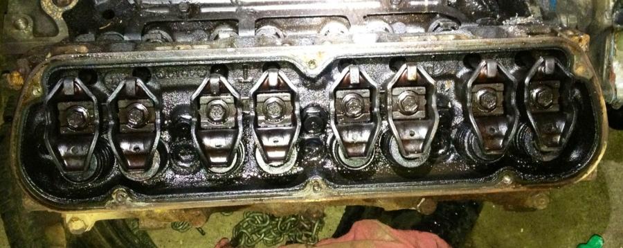

They are most likely E7TE's. Those pics you posted don't tell much. Have any pics under the valve covers?

The only thing I can find says 4h12
Passenger side head
1

Those are E7TE's. Really a decent head overall. IMO, your biggest restriction is going to be the cam. You can put better heads on it, but then you're bottle necking with the F150 cam.

I am not that up on 351W heads but the T in the corner means it is an E7TE cylinder head in 302 land.
IIRC the E7 351W heads are the same as the E7 302 heads aside from the bolt holes are bigger. E7 302 heads can be had really cheap.
