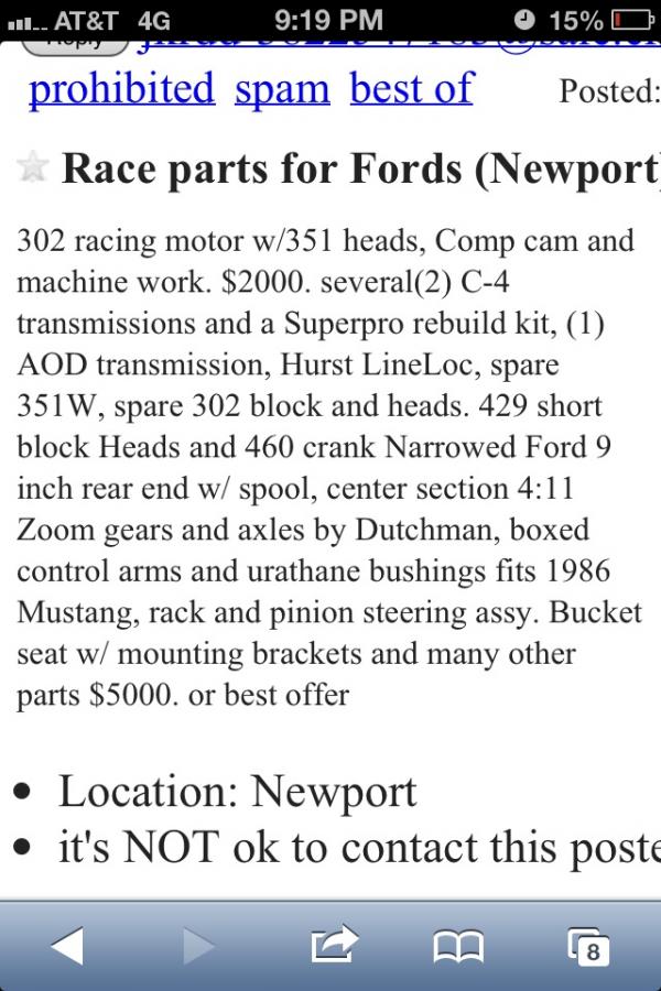

Ok so I thought you guys would like to see this lol I'm thinking about giving this guy a call to talk to him about the 302 race block with 351 heads .....

What is He calling a race block? Is that what He calls a roller block? And again, the 351 heads really depends on which heads they are.
Sent from the can - literally this time
He's saying its a 302 racing motor with 351 heads

The Windsor heads interchange, and the dowel pins in a 302 block will hold the 351 head in position just fine without accounting for the larger bolt holes.
on a stock engine sure.
anything abused or hi compression or pushing air will pop gaskets in short order.
