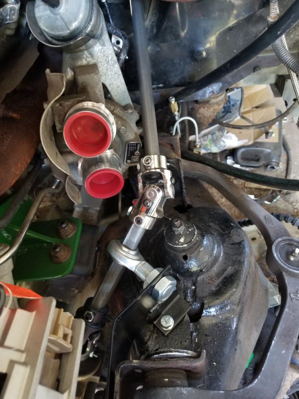

The steering is done, the double-D showed up in the mail on Friday.

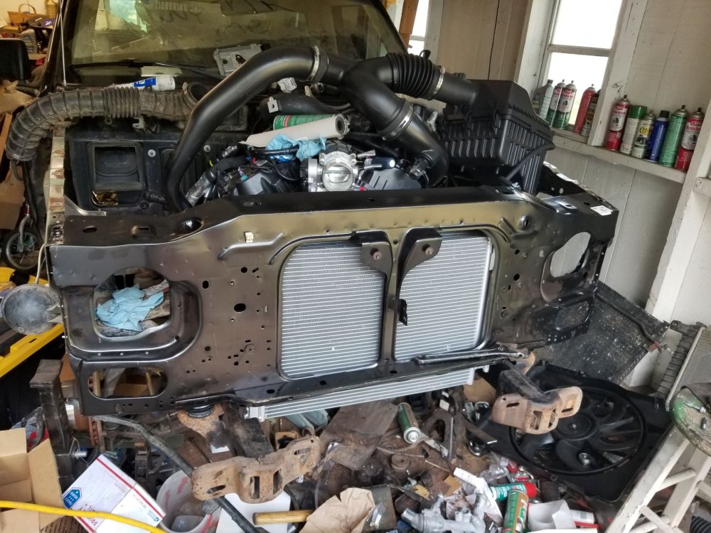

Radiator, A/C condenser, and Core support are all mounted. I only pop riveted in the core support. Figured if I ever have to take the engine back out again, it will be a lot easier to drill out pop rivets then spot welds.

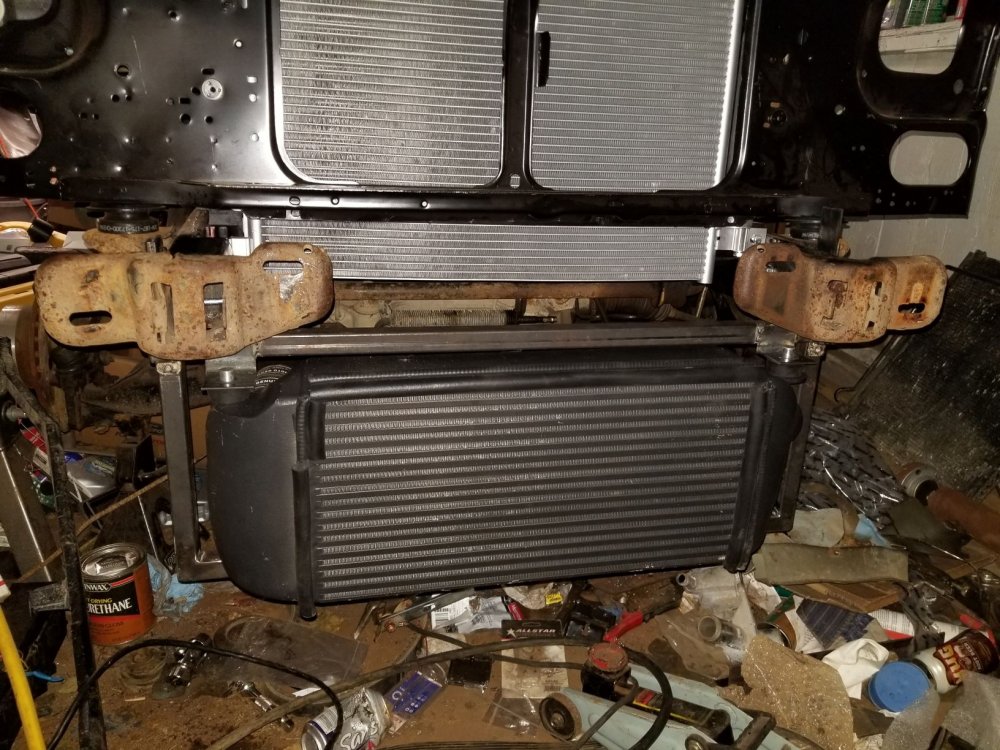

I am working on mounting up the intercooler now. Ford uses a o-ring seal on the outlet of the Intercooler making it a unique fitting (not just a band clamp), so I am trying to re-use the tube from Kit-bashed Mishimoto intercooler tube set. In doing so, the intercooler gets pushed way ahead of the radiator (almost right behind the bumper). From what I can tell, the only airflow it got on an F-150 was when it was moving, so I am not worried about air flow. Might make an Air-scoop in the bumper? just have to see.
hind-sight is 20-20... looking back, I should have just assumed none of the tubing was going to work. Then I would have moved the turbos and got the engine sitting lower and wouldn't have needed to mess with the steering like I did. I think it would have been a crap ton of work, but it would have been the cleaner installation. I would also try to find an intercooler that had a center outlet. the two hot side pipes would be on the ends, and dump in the middle. I might have also gone with the Taurus SHO intake as well. I would also try the 4.0L radiator, or make one that fits in the same envelope. Modifying the frame and making mounts for the radiator wasn't fun. Things I plan on noting for anyone else willing ( crazy (stupid)) enough to try the swap.
Intercooler mounted, not done, but mounted.

I still need to add a brace to keep it from being pushed back, then pull it apart to grind down all the sharp corners and paint it. Looking at this picture, it also looks like I need to spend an afternoon cleaning up the garage around the truck.... Didn't realize it had gotten that bad :blush:.
It's hard to tell from the photo, but the front of the core is nearly right behind the bumper mounts and bout 10 inches in front of the AC condenser? That F150 engine bay must be HUGE for the amount of space between the Intercooler and the engine.
Holy cow that's low. That'll make one heck of a nice coon catcher.

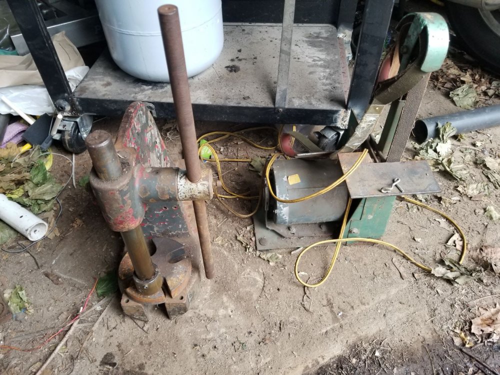

I may not have gotten anything done on the truck, but I did get "new" tools.
30249
I was told that it was a 1 ton arbor press, and from how heavy it is, it's probably about right :icon_thumby:. The other is a 1 inch belt sander. The sander needs a little work since it's on-off switch is plugging it in and unplugging it. They are rough, but I couldn't argue with the price; $25 for each of them.

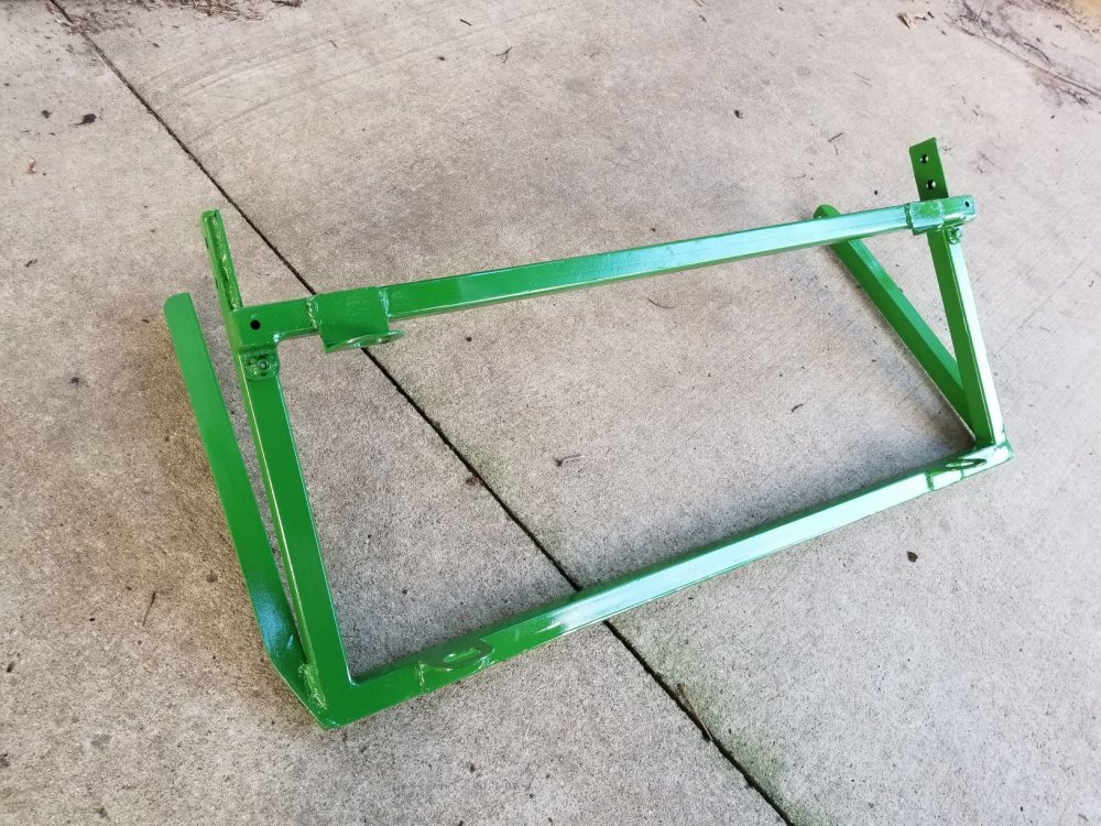

Painted and ready to go. I'll finish the installation tomorrow and start figuring out were all these tubes are going to go.

I like starting with nothing but a pile of steel and an idea to end up with this final, complex part. I just wish it didn't take so long to do. I just want to hear this thing run!

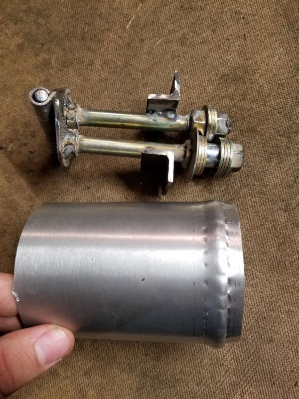

Some of the tubing I purchased had beads on them already, but a couple I had to buy without beads, or I had to cut the tube up, so I have to reform the bead. I have to do three beads in total. I tried calling my local speed/tuning shop, but they didn't have a bead roller. To buy a bead roller is $120 for a cheap one? Which, if I ever though I would need it again after this project I would have ponied up for. But I don't think I will need this tool again, so I made one!
30660
The contraption goes into my bench vise to apply the pressure. The original idea was that I would be able to roll it around on the washers, but there is just to much pressure. So I just ended up clamping - unclamping the contraption as I worked my way around the tube. Could have been better, but I am not going to complain about 5 bucks worth of grade 8 hardware and a hinge.
