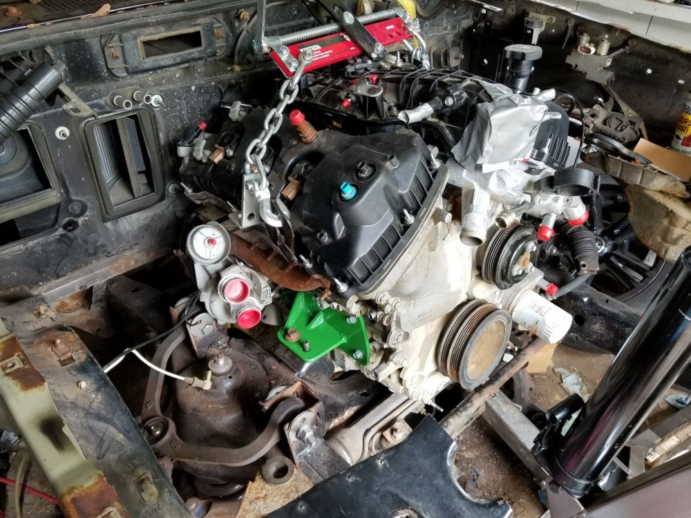

Here is the engine mounted. You can see the notch in the cross member if you look hard enough. You can also see how close the turbo is to the upper control arm. I Still have to figure out steering, the other turbo is right in the way. ooh yeah. I also got hardware to mount my throttle body, so that is on now (not pictured).

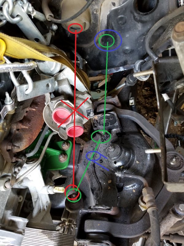

I HAVE A PLAN FOR THE STEERING!!!

The Red line was the original steering. It has pretty much a straight shot out the back of the steering wheel, down to a Universal joint at the rack. There is a turbo there now so that obviously won't work.
So to fix it, I am going to move the point where the steering comes out, supporting it with a bearing mounted to the firewall. There will be a Universal joint at the firewall, then another above the shock mount, then another support bearing ,then it finally makes it down to the rack....
Again, I am going on vacation, so I haven't ordered any parts for this yet, I don't want them showing up while I am out of town, but I think this should work.
The universal joint for the steering rack was the hardest one to find, mostly because it isn't your standard double D shaft. it's a ford triangle, or ford pyramid, or a Flaming River Power rack? What ever it's called, there aren't many options on amazon, and buying them from Flaming River is expensive.

your plan for the steering is common in some areas of the country where people run regular headers on v8 swaps in this chassis. in 98 we did a bbc swap with just 1 added joint to a 97 2wd flood truck that was otherwise brand new. with this style ranger column , moving it over on the firewall is much easier then the earlier fixed coulumns...which with older trucks cutting of the column inside with a collet/basket bearing and taurus parts work to move the shaft over on big block swaps. you take the factory reinforcing plate and move it over. i would wager you have it just right with the plan.

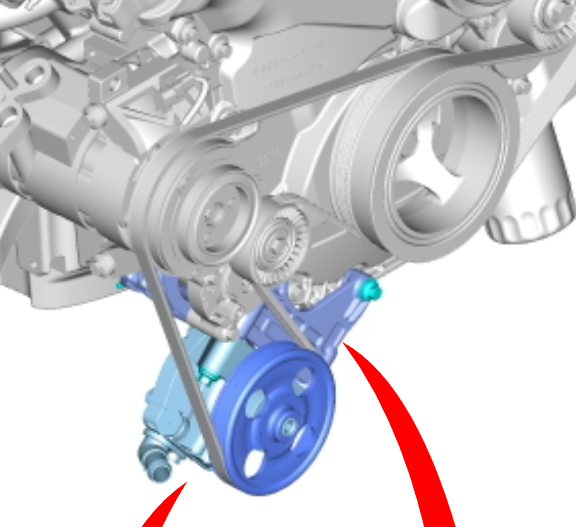

I don't think I would be able to use it stock. I don't think I have enough room to the sway bar, but I think I can use it as inspiration to make my own bracket.
28365
I think if I rotate the pump up a little, maybe move it out, I can get something like this to fit. That will need to wait until another day though. Now that I am back, I need to pull the engine back out, hopefully for the last time, and finish up the stuff where it's a pain having it in place, including all the cutting and grinding I need to do to make the radiator fit.

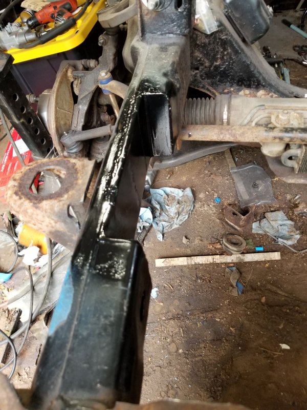

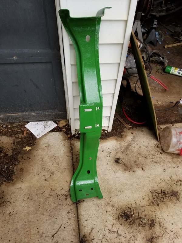

The first thing I did when I got back from vacation was to pull the engine back out of the truck, something I am getting really good at. With the engine out I could finish off the Transmission cross member. It worked, but I had to slot the holes so much that I wouldn't have been able to put a bolt onto the mount, and last time I checked, I need bolts holding the transmission.
29088
You can kind of tell where I added the bump out to let me bolt the transmission in place.

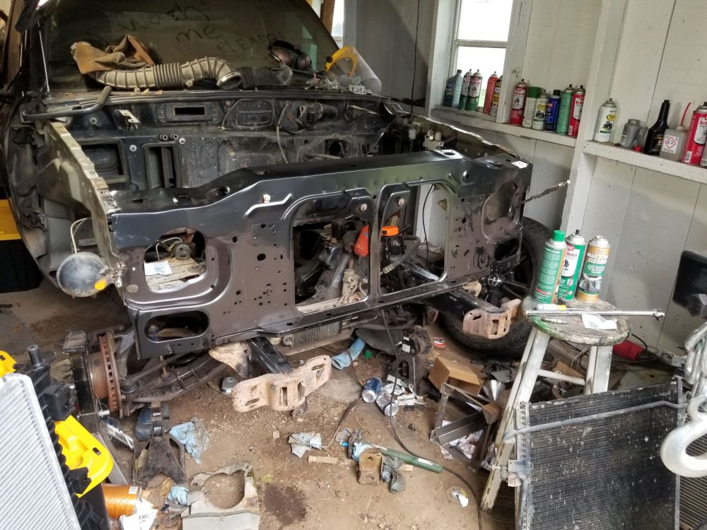

After that I went to town cutting/grinding out the old core support so I could start test fitting the new one in place. After going through one grinding disk, I got the old one out. New one looks pretty good if I do say so my self.

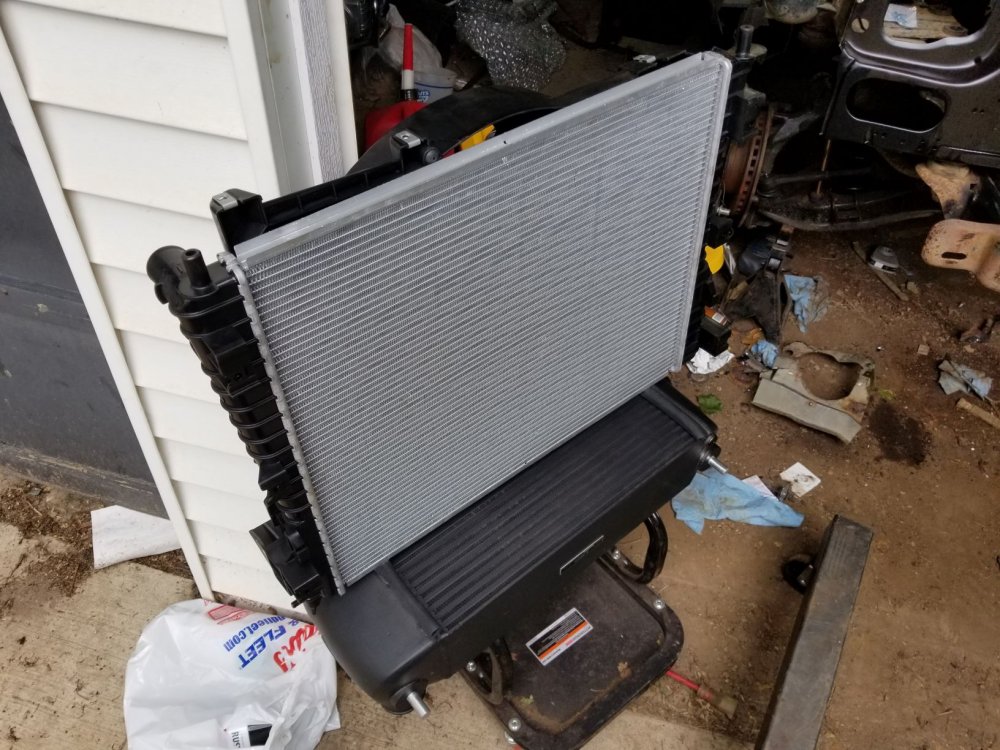

It also let me know what I needed to do to get my coolers in place
29091
That's my radiator and my intercooler. The intercooler is like 4 inches thick on it's own...
The bad news is that both are too wide. I have already cut and notched a bunch of other stuff on the frame, so might as well do that now.

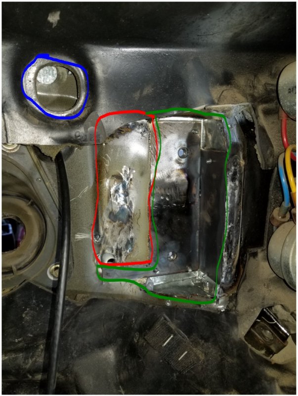

My new throttle pedal mount:
29275
The Blue circle is where the old cable poked out the firewall... I don't need that anymore so I have blocked it off.
The red square is the original flat spot where the old bracket was spot welded and was not nearly large enough for the new pedal. Not if I wanted any kind of gap/space between the throttle and the brake, although it would make the old heal-toe shift easier.
The Green is what I had to modify to get the new pedal to fit. Part of it is 1/8 inch steel welded in place, the rest is sheet metal riveted in place, and the whole thing covered in seam sealer on the outside. Only caught the foam on the inside on fire once.

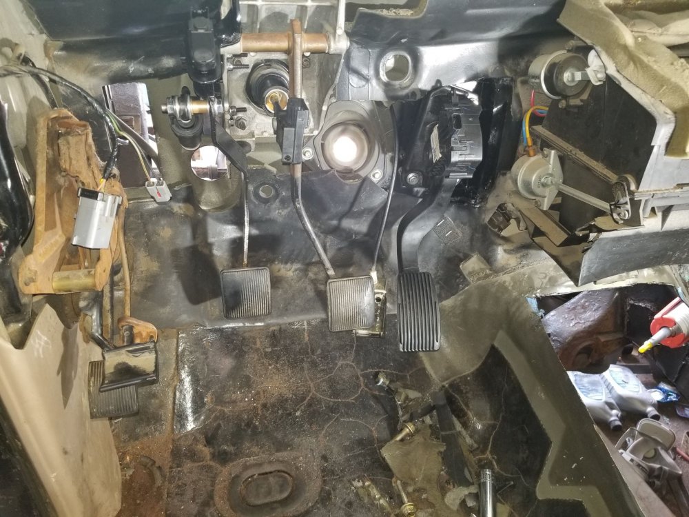

I am regretting the decision to use the clutch limit switches ford provided. They don't bolt in place, they snap in place :annoyed:. They snap into very specifically shaped holes that aren't round :pissedoff:, and it will most likely take me all weekend to make those holes with files :bawling:. Of course I could have bought a braket that already had all the mounts for the switches (ford provided the part number) but it was out of a focus and from the pictures I didn't think I could get it to work with the ranger setup.
Pedals are installed
29544

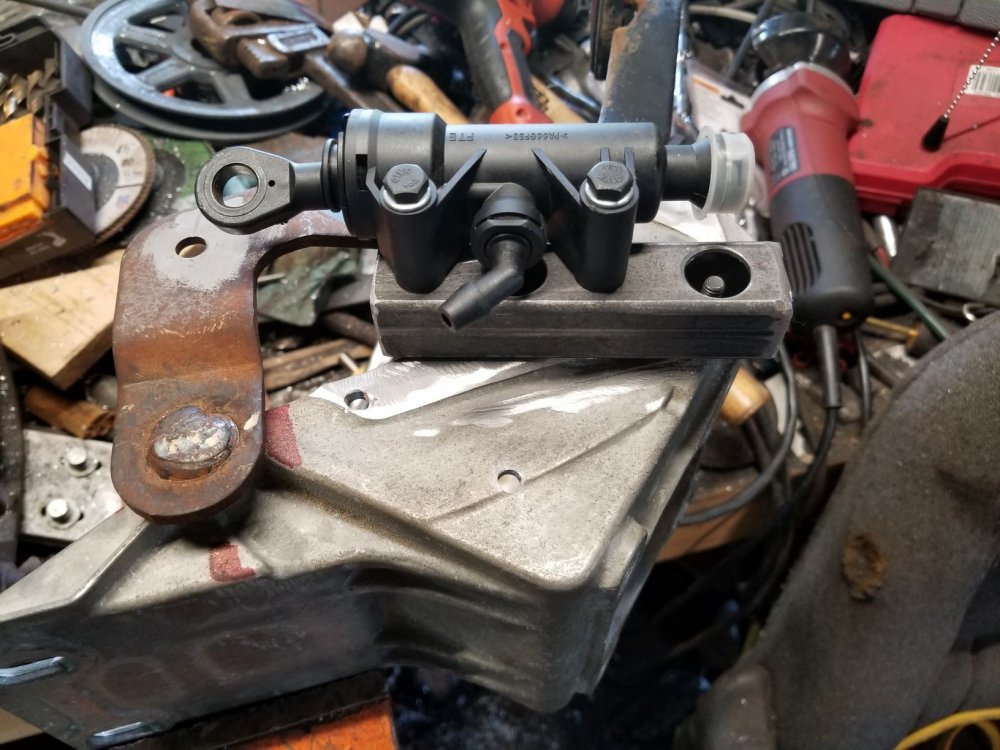

With the wiring done, I put the dash back in place. I put my steering column back in so I could start mocking up my steering, but before I could make real progress, my McLeod clutch line showed up and I just had to see if it fit. That was a huge pain to get done, I tried to massage the floor to make it fit, but ended up ripping a hole in the sheet metal (pry bars will do that). Since I already had to repair holes, I just made them larger so I could actually get my hand in there to install the fitting. The fitting is on the slave cylinder, the line is in the master, I am waiting for the exhaust to route the line and then I have a clutch.

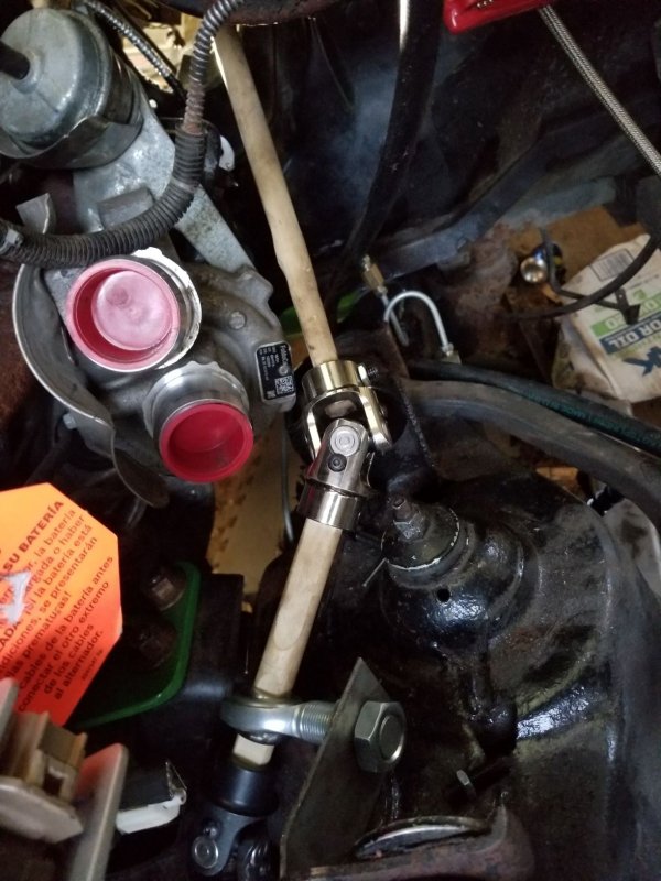

I did get back to the steering though, and it's mocked up. Need to make a permanent bracket for it thought. There are a lot of rubber components in the suspension near by, and from experience, I know the frame has a bunch of seam sealer or glue or something that doesn't like heat, so I am trying to avoid welding on the frame. So that leaves me with two options. The mostly likely correct way, and the way I am going to do it.
The correct way would be to remove the upper control arm, make a plate that bolts to the back of the upper control arm mounts, and then use my bulk-head bearing to support the shaft. The way am actually going to support the steering shaft is a bracket that comes of just the from control arm mount, then bolts to the top of the frame with a nutsert and call it good enough.

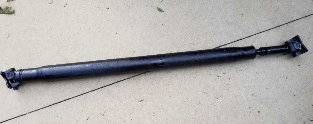

Steering is Sort of done... Technically, the bracket is finalized and painted, but I am with-holding pictures till I get the Steel double-D shaft. The real exciting part for this week is that I have a new driveshaft.
29899
it's halfway installed just to make sure it's the correct length, but I don't want to finalize the installation until after the first start. The drive shaft shop took my original drive shaft and added the slip joint and flange.
