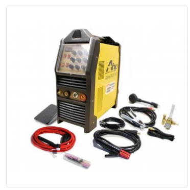

So that's what I did, I bought myself a new AC/DC TIG welder so I can weld aluminum. It's also a new semester and I have free time again. So between those two things I have a renewed interest in the truck. I also have goals for getting it running (notice I didn't say done :icon_thumby:). This year the Hot Rod Power Tour and Hot Rod Drag week are coming within a couple hours drive of my house. Closest it's been in maybe three years? So I want to be able to drive the truck to those events.

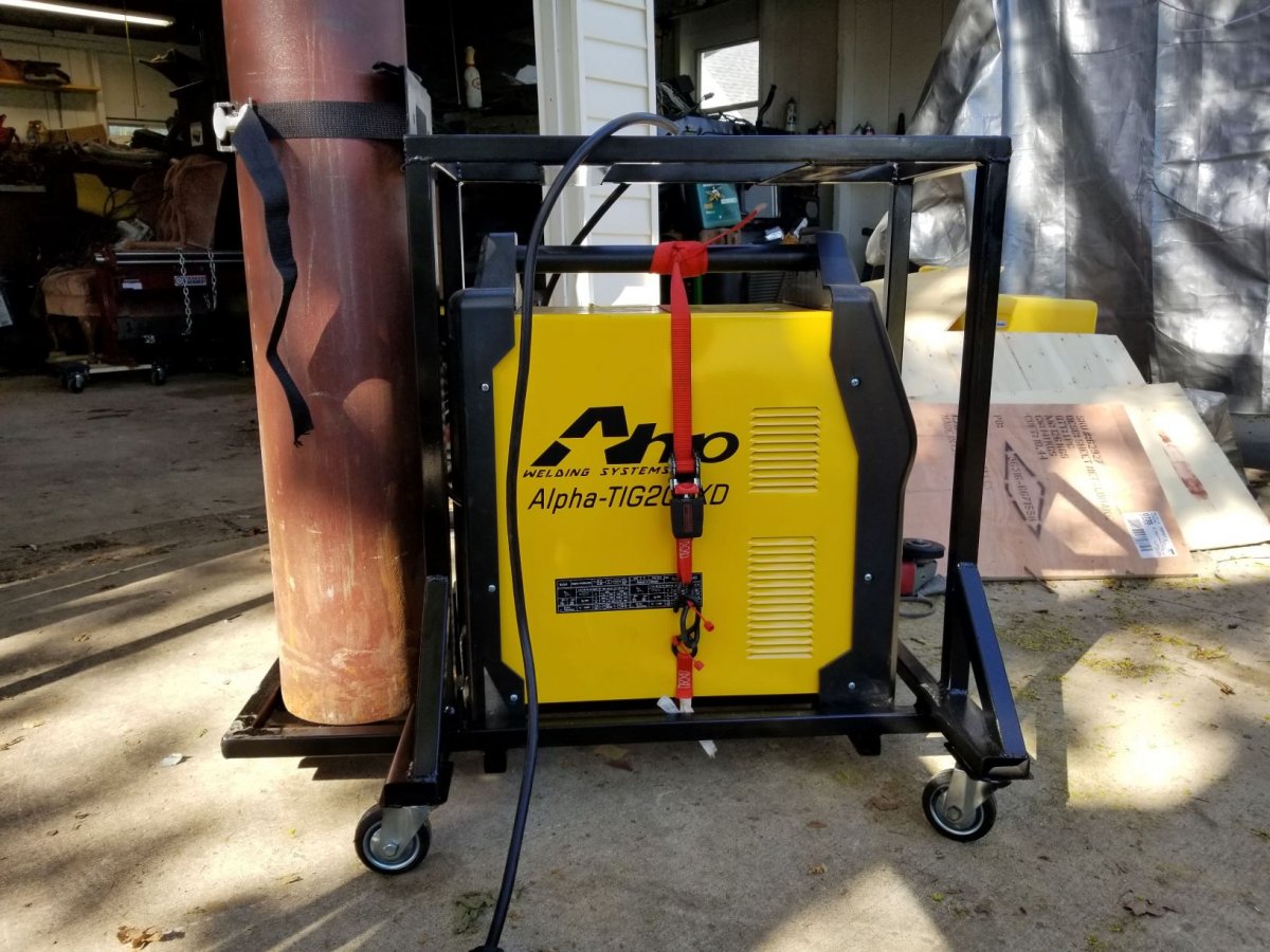

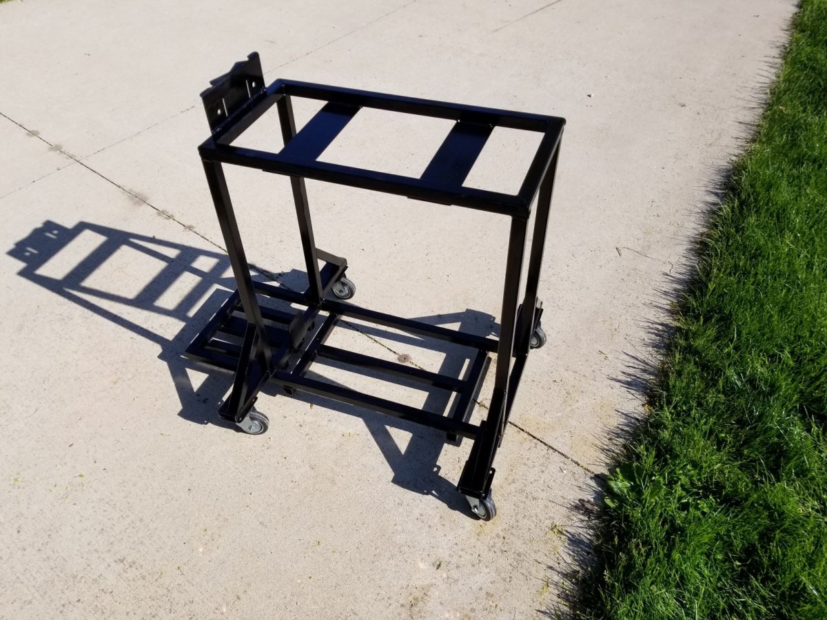

Weld Cart Done!
42561
42560
I might need some counter weight on the front... but for now it seems okay. My goal was for someone to see it and say "well that seems a little over kill". It took my 300 lbs without any issue (I may have gone surfing across my driveway :LOL:). The welder is about 50 lb and the bottle another 70ish (didn't weight it, that is a guess from the internet), so it should be more than strong enough. I have added a piece of quarter inch plywood on the top and it's going to get a couple of Ikea bins for storage. Might end up adding some hooks for cable storage.

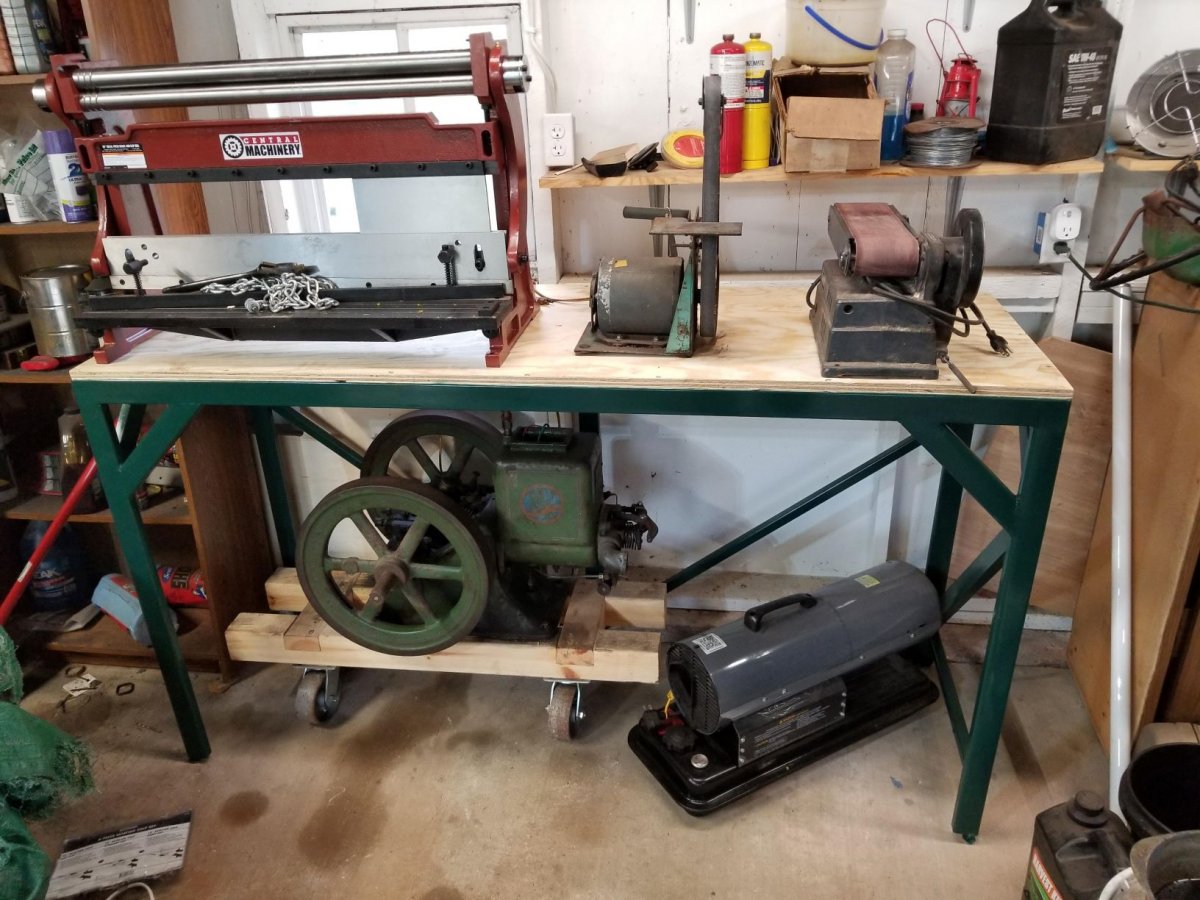

The new work bench is well underway, but I am going to wait till it's done to post pics. The weather around here has been cold and rainy, but it's supposed to improve later this week. I have to pretty much empty my garage to get the bench in place, so nice weather is a must.
All the Automotive videos I watch have me feeling guilty for not working on the truck, so I am looking forward to getting back to it... there is just to much clutter at the moment.
I have successfully joined two pieces of aluminum together... all I can say is that TIG welding is an art that takes practice and experience; spending a hour messing around in the garage doesn't yield pretty results.
The Garage Clean up and Organization went OK though. There is still work to do, but I am waiting on some stuff from amazon to clear up more space in the garage (the grill is getting kicked to the patio once a cover comes). Here is how the work bench turned out:

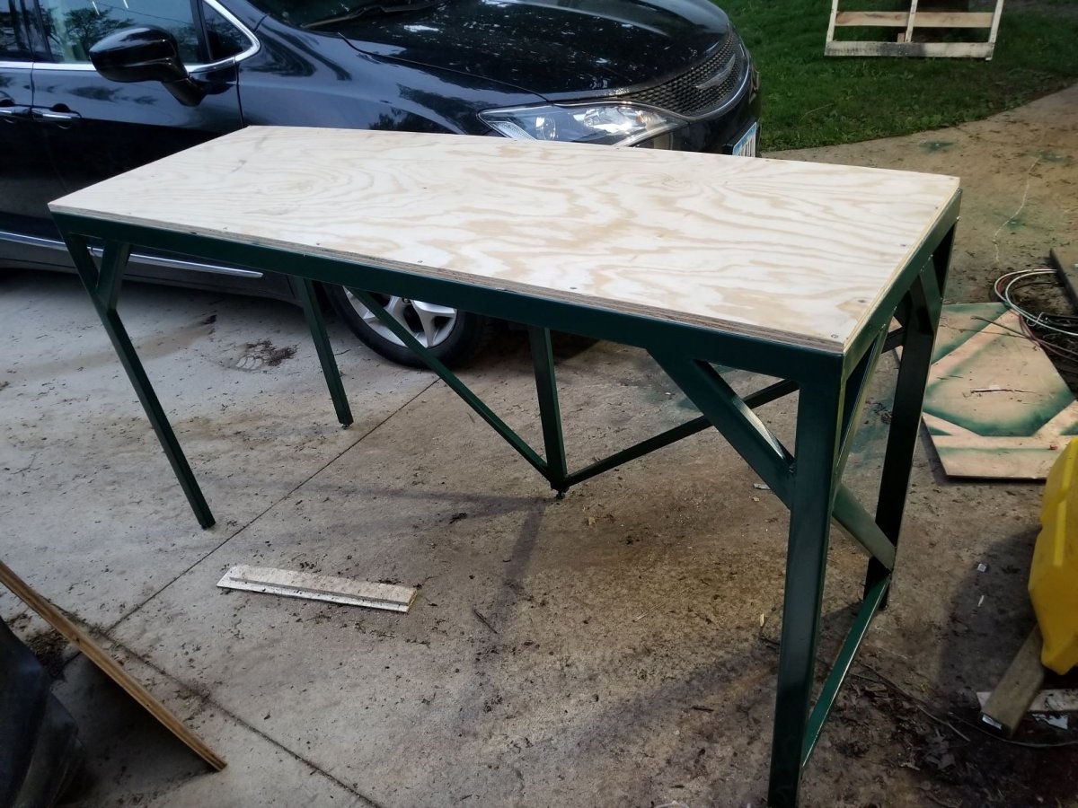

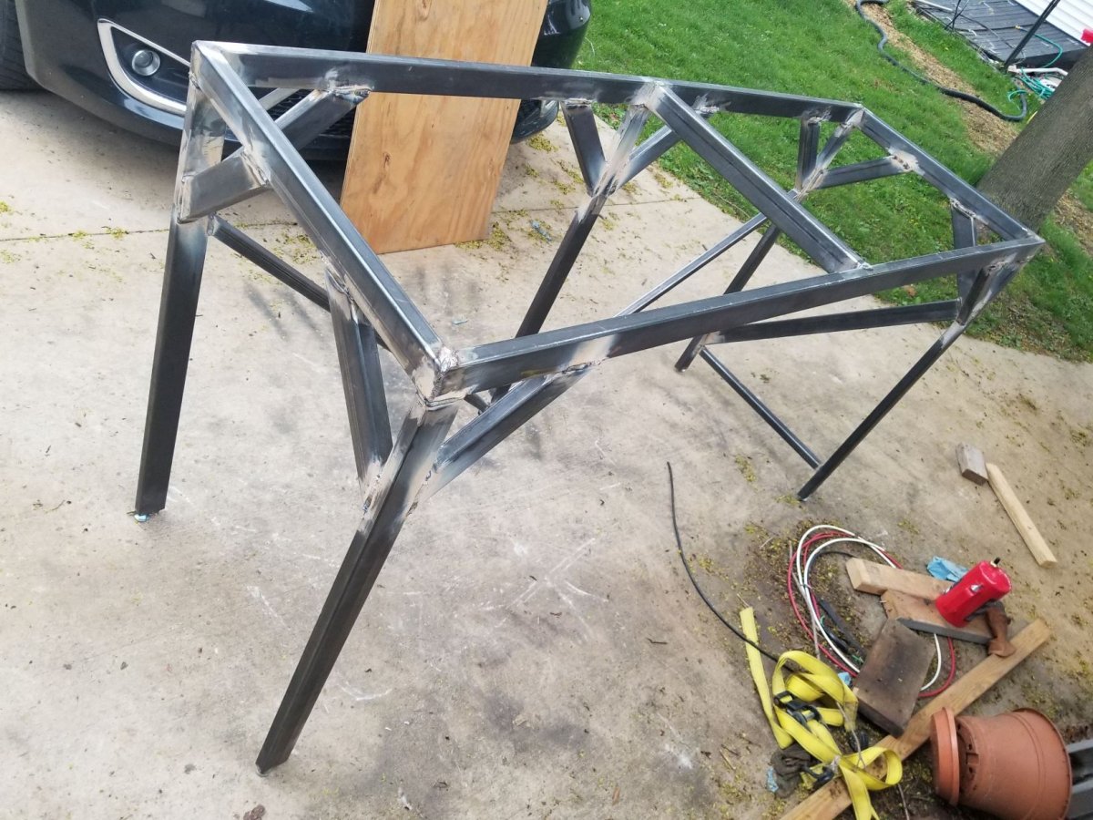

Finished welded: I ended up having to add more bracing then I had intended to straighten out a bad warp in the top. I was trying to build a 2x6 work bench on a 2x3 welding table. Should have built it on the drive way to start with. Oh well, I will know better for next time.
42890
Painted with the top fastened down:
42891
Finally in place with all the tools on top: I still need to bolt them down, but that will happen when I go to use them.

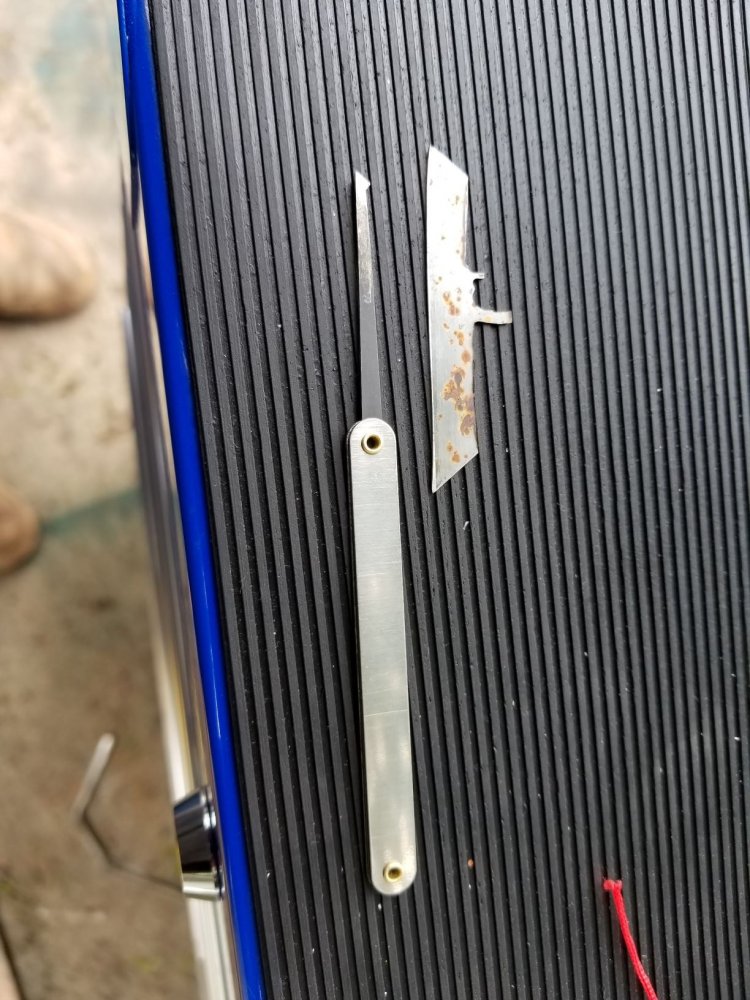

Within 10 minutes of owning the toolbox, I learned the hard way that you can lock the box, then shut the draw that contains the key...
Fortunately I know how to pick locks, I am not great at it, but you basic masterlock I can get into. Tubular locks like the ones on the toolbox are stupid easy to open if you have the special tubular lock pick, but I didn't have one, and I wasn't going to go out and buy one. But you can still pick it the hard way if you can make a little tool to tension the lock. You can see it there in the tool box picture.
42894
A couple little prongs ground into an old razor blade (I ground the edge off too) did the trick and I got the tool box open.

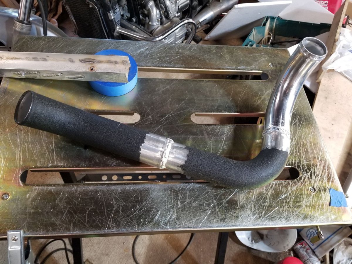

Speaking of worth every penny. This my friends is what a $2000 intercooler pipe looks like:
43095
That is about how much I spent on the welder, welding supplies, and the garage electric upgrade. The welder will get used again for the intake, but I haven't gotten that far yet. Everything else I have used the welder for could have been done with my MIG welder. Granted, it wouldn't have been as pretty, because I guaranty I would have burnt through the exhaust tubing I plan on using for the exhaust, but it could be done.
Still not showing my welds :blush:. There were a couple decent stack of dimes, but nothing photo worthy. It doesn't leak and that is what matters.
