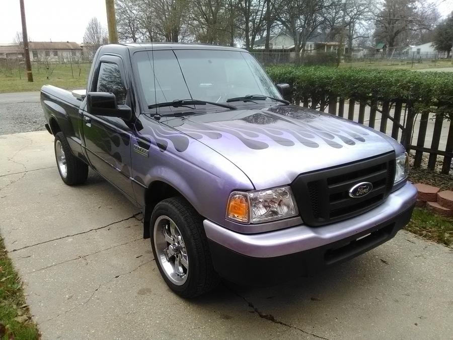

Gonna get a pic in the daytime, you'll love the paint job!
Yes it's paint, no it's not vynal nor a wrap.
