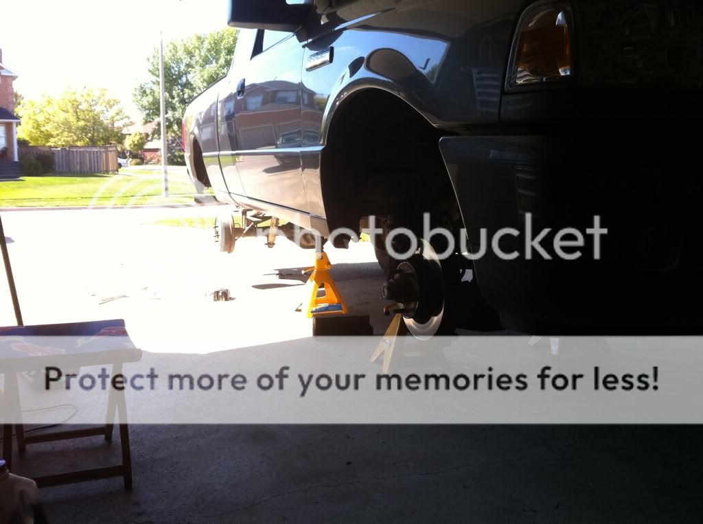

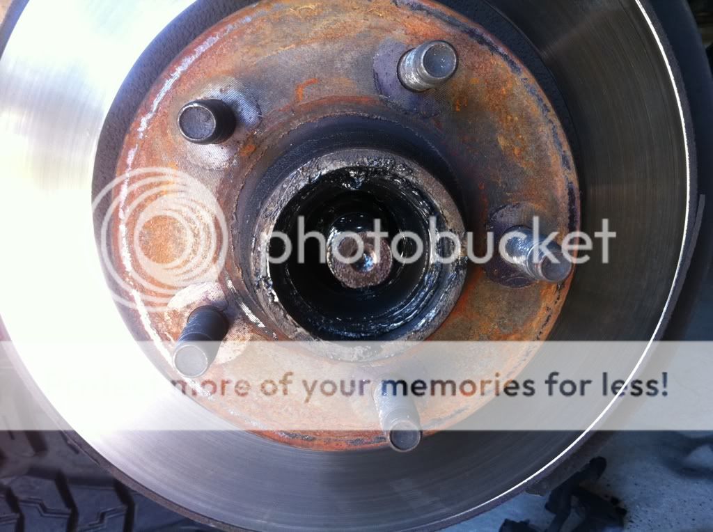

alright guys, the parts are in!

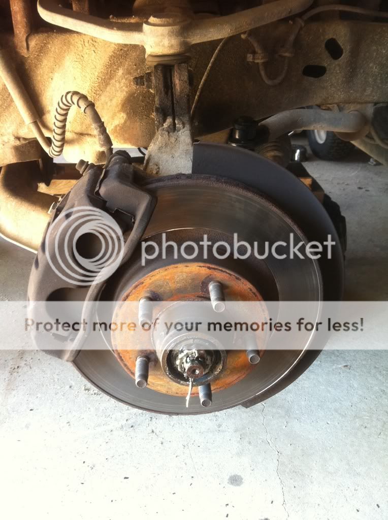

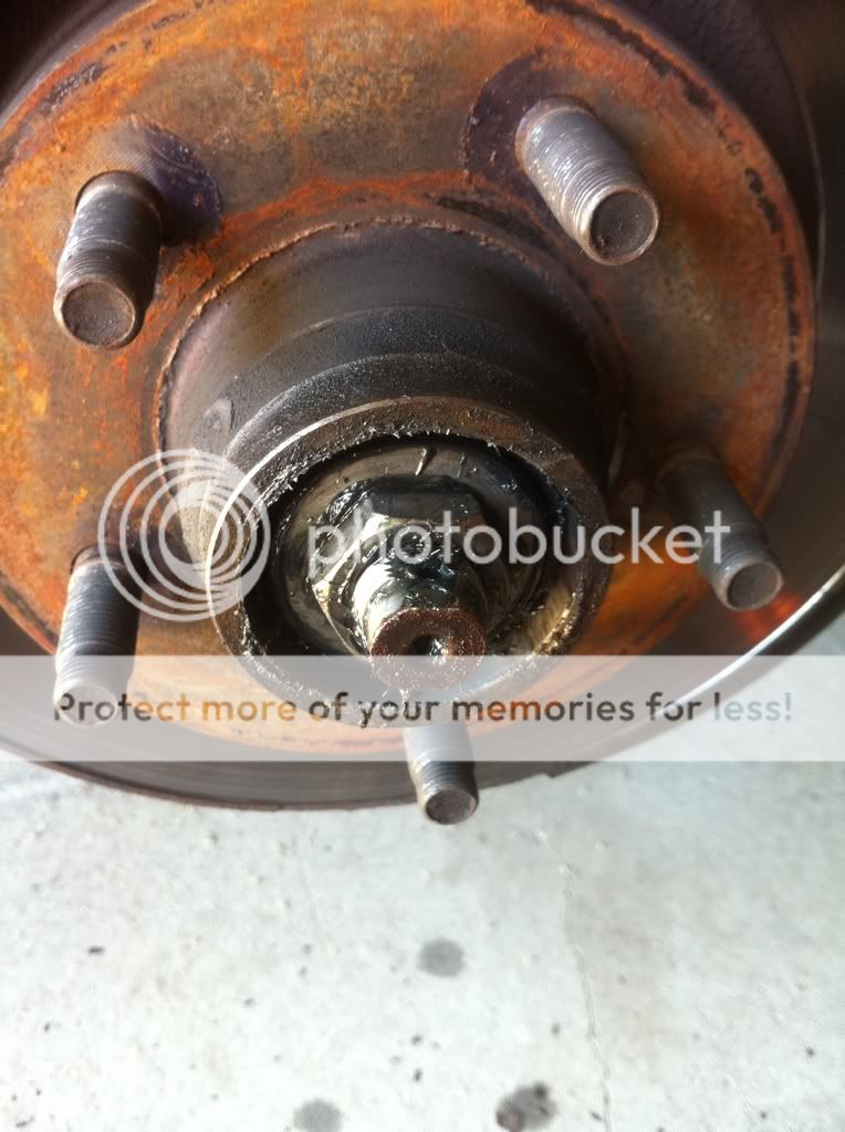

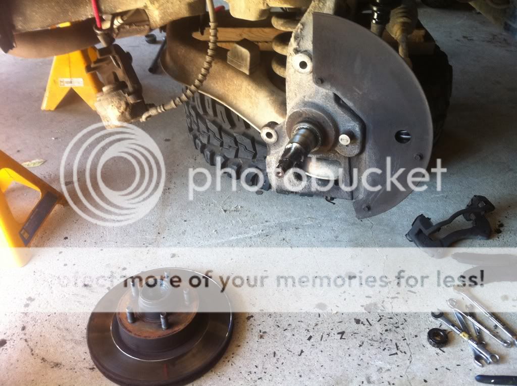

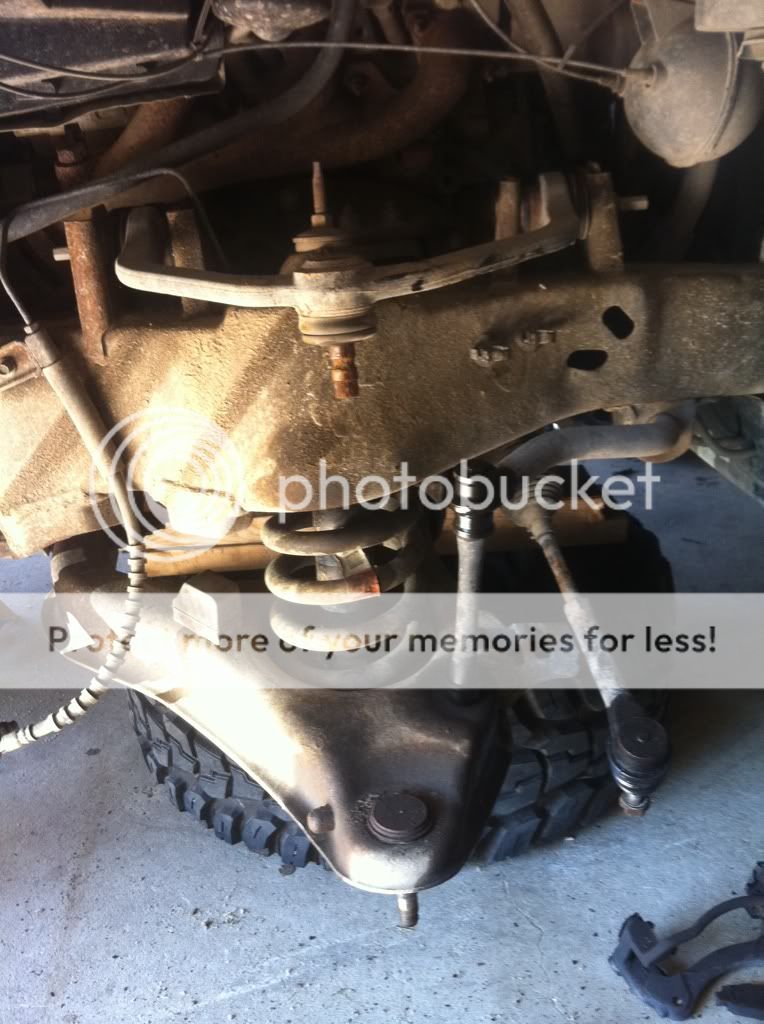

in order of work done!

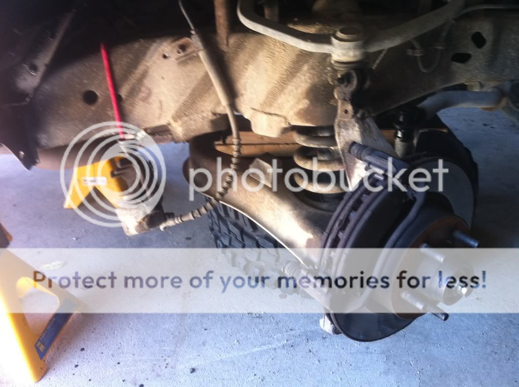

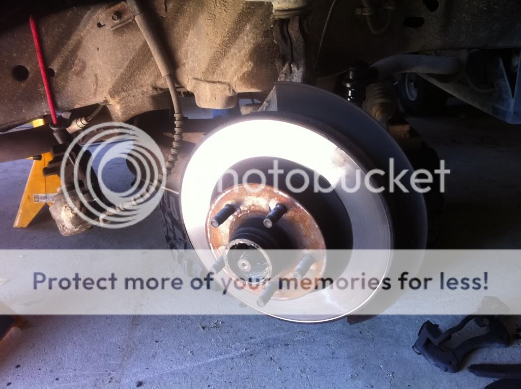

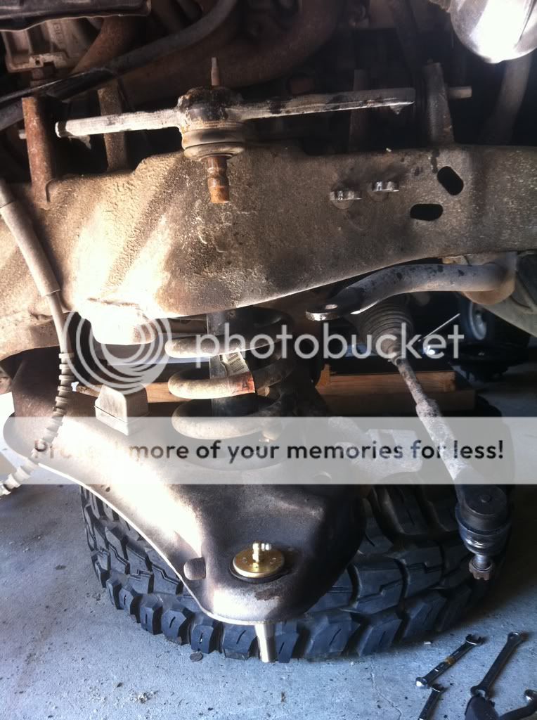

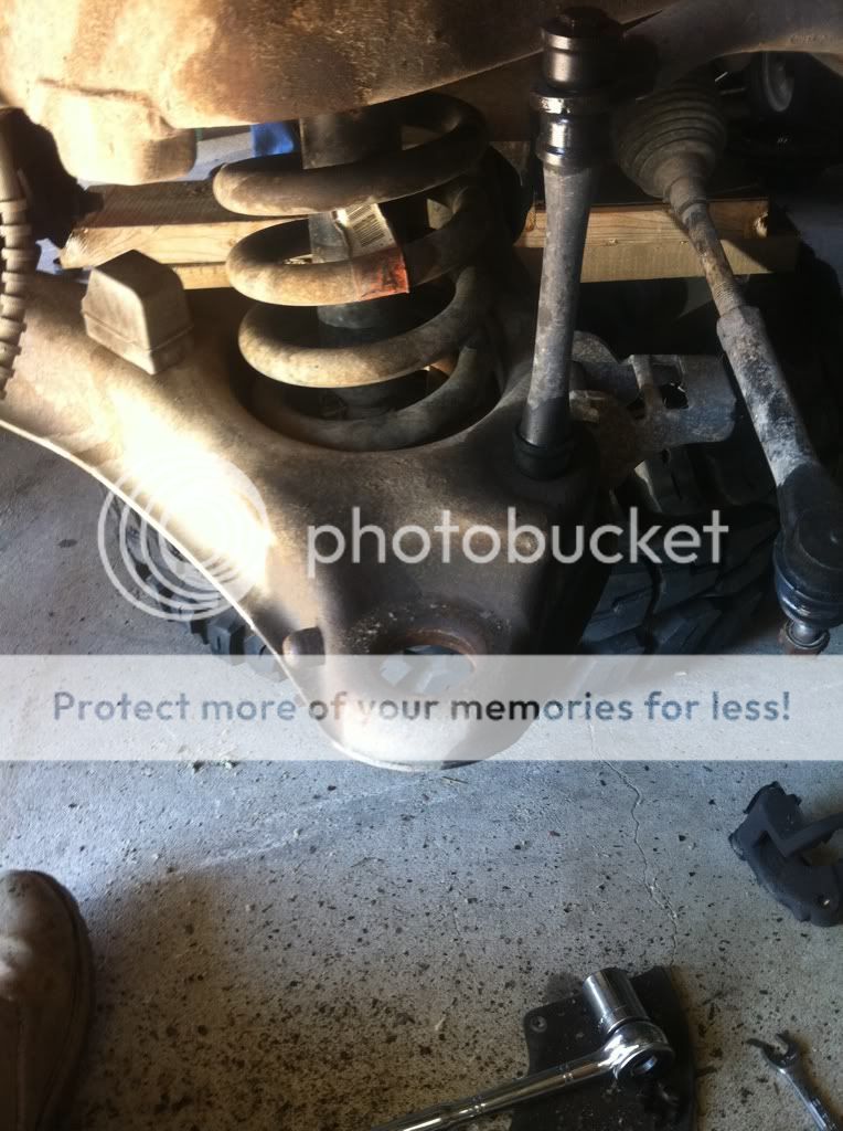

Before:

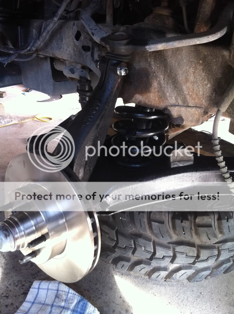

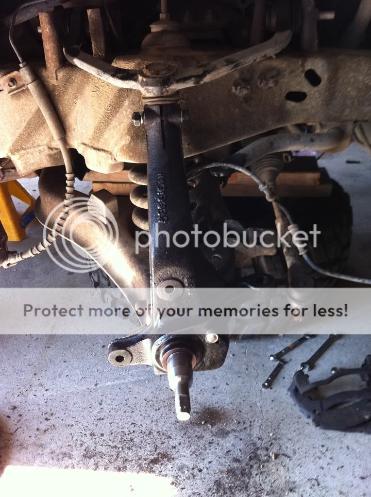

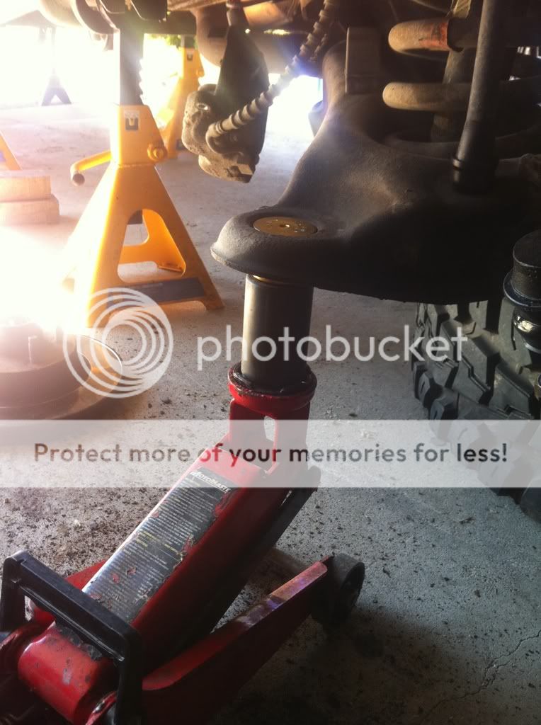

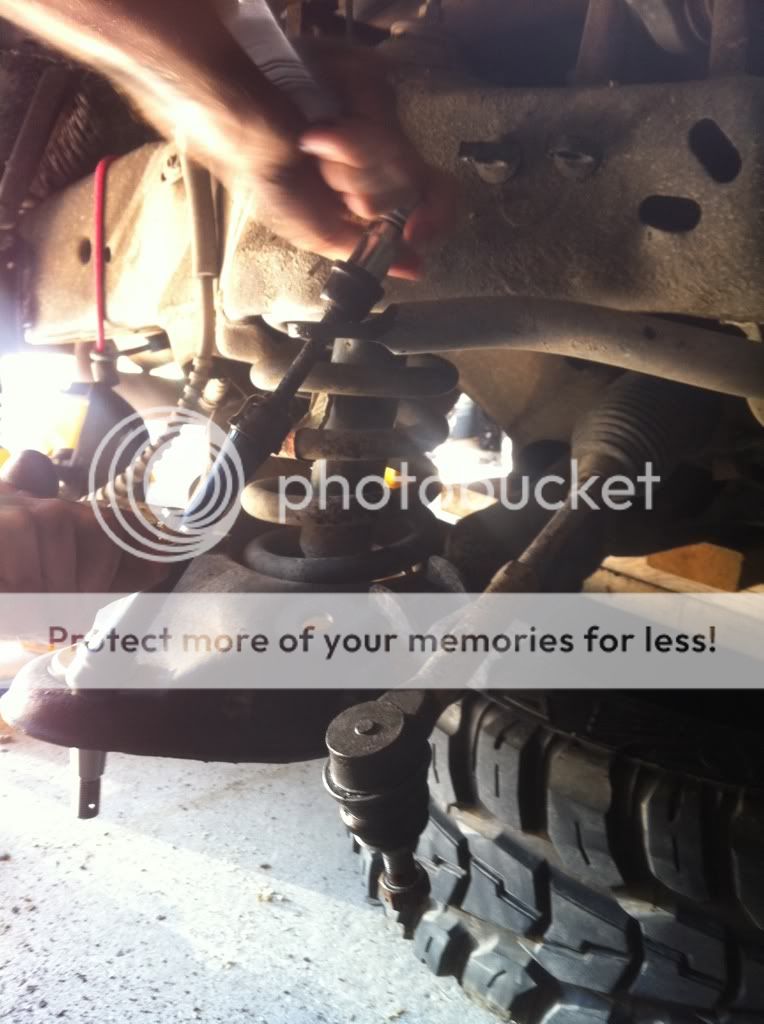

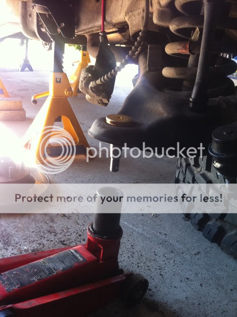

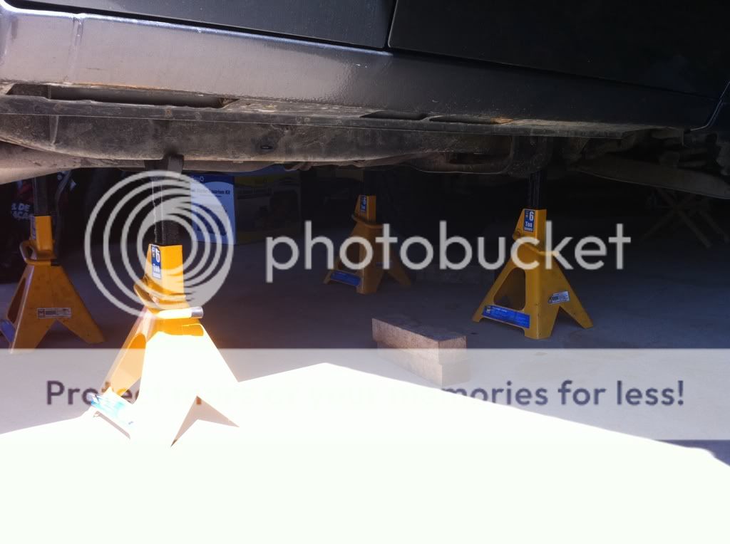

Install:

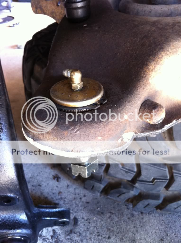

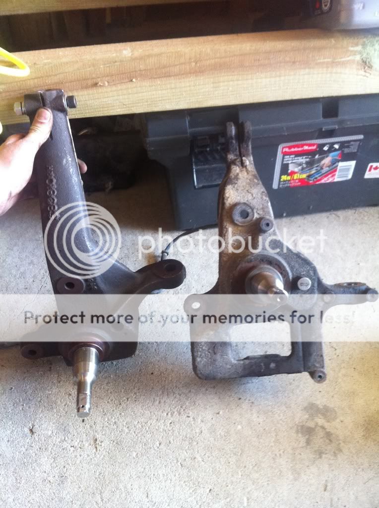

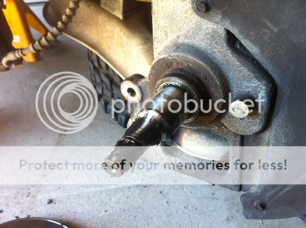

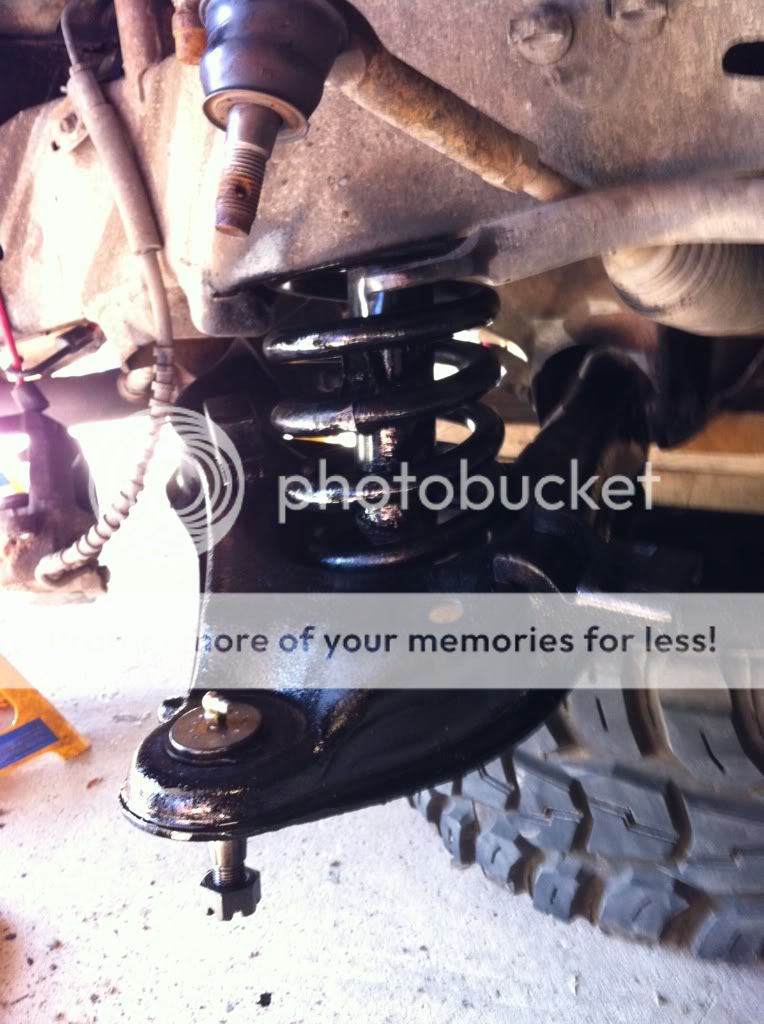

original on the right, Doetsch on the left:

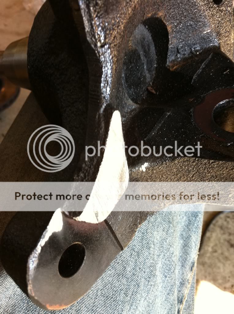

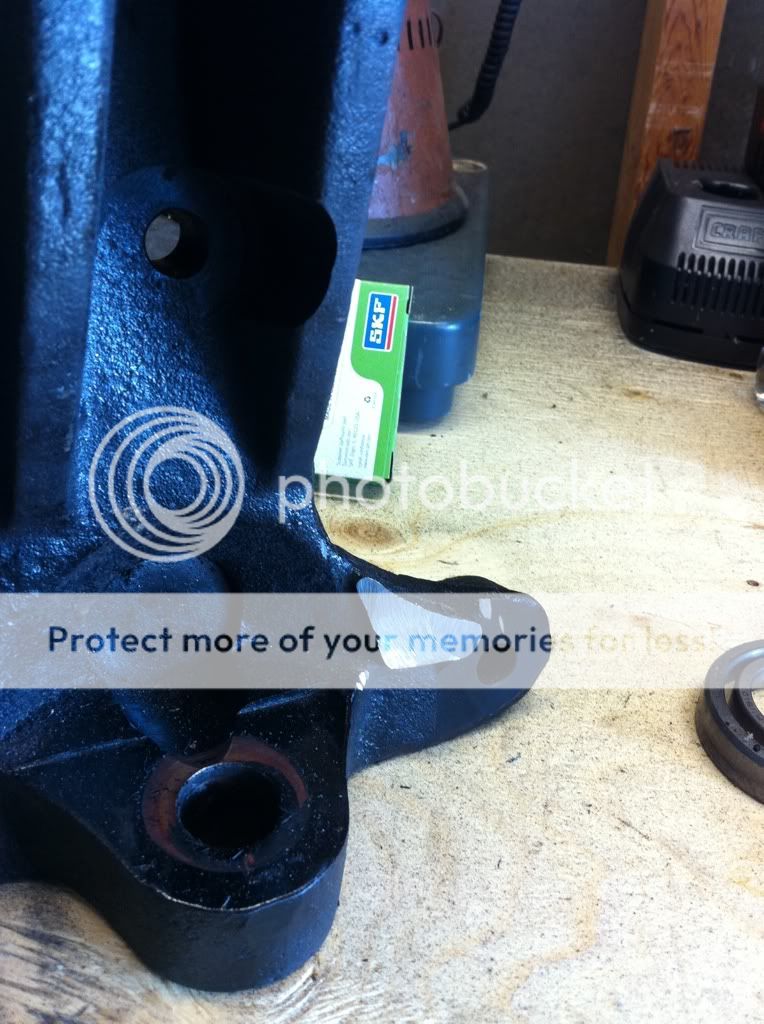

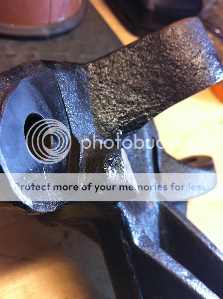

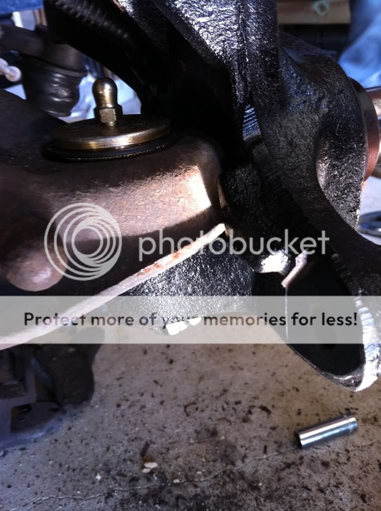

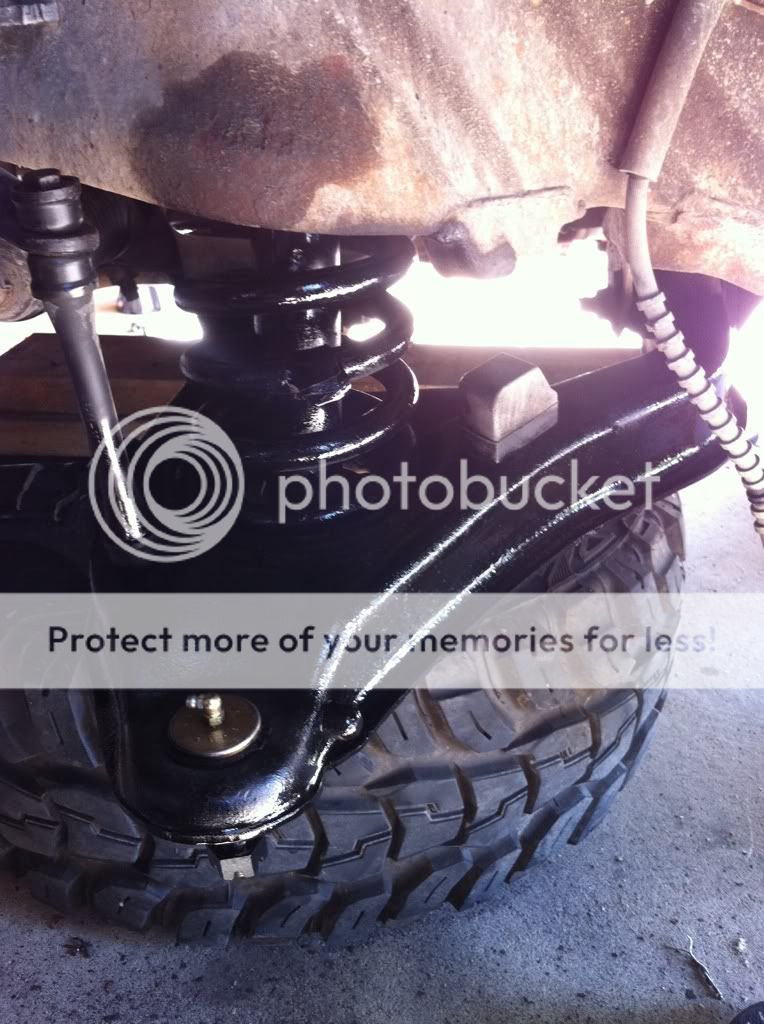

Had to grind the spindle and control arm to get free movement. this is the hardest part.

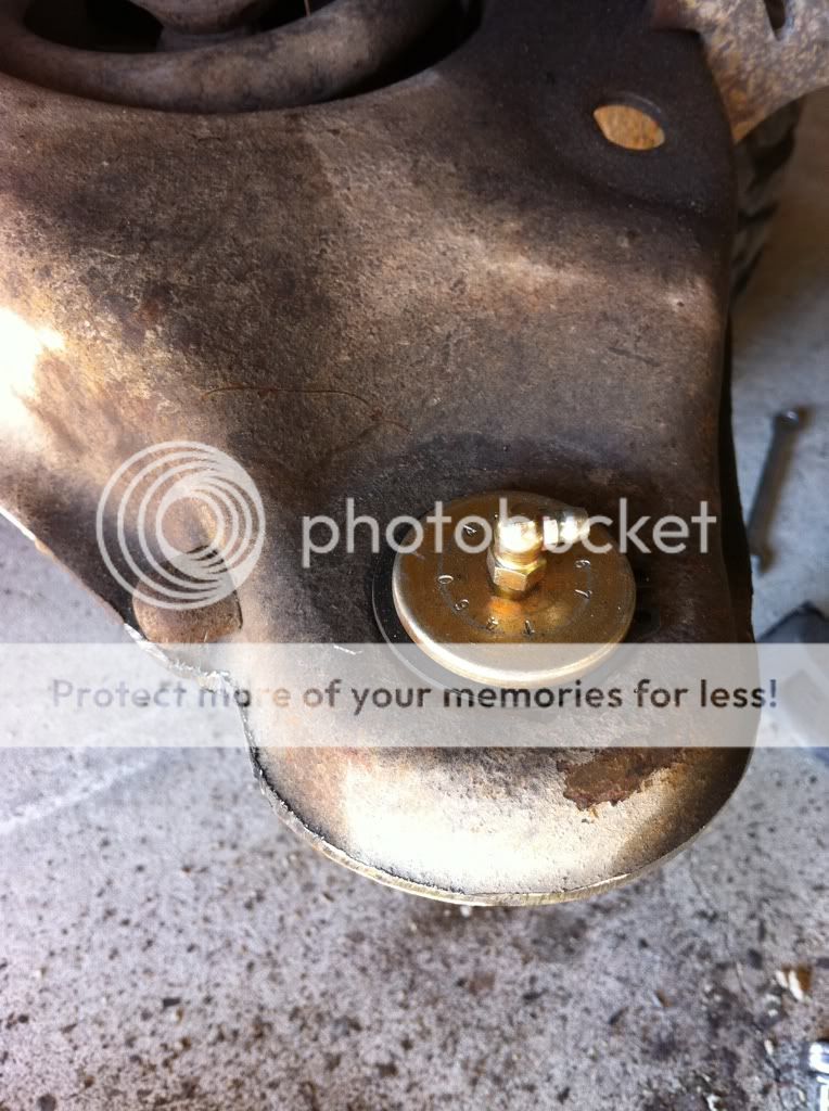

quick coat of paint:

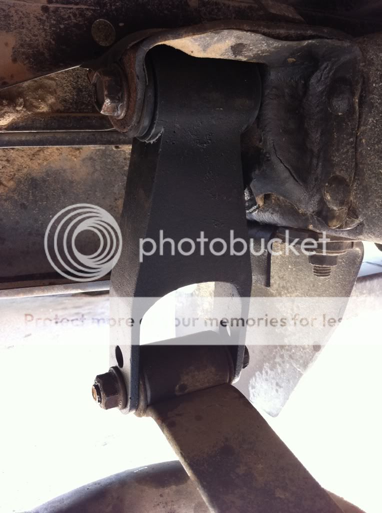

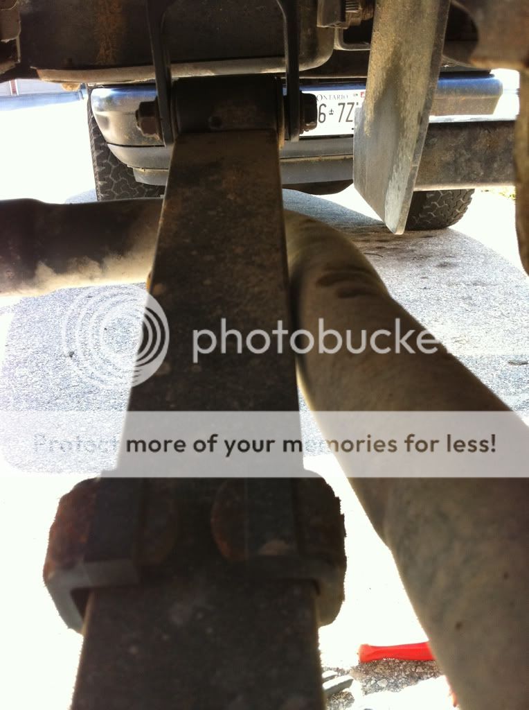

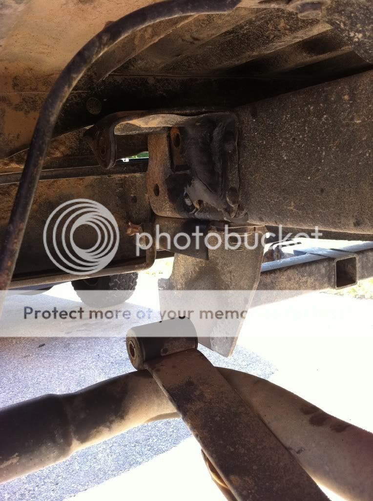

The back:

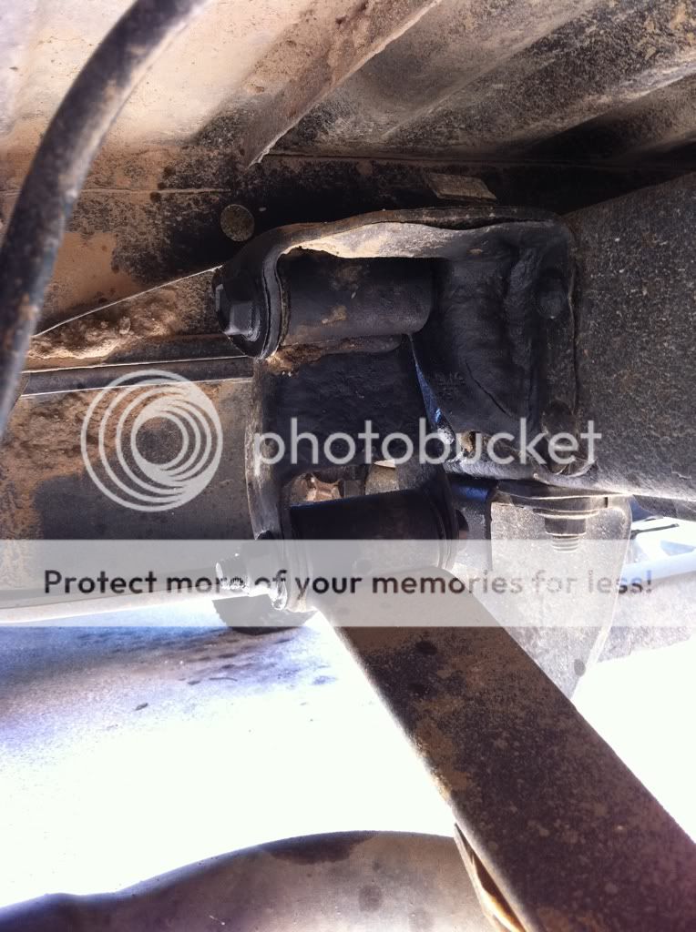

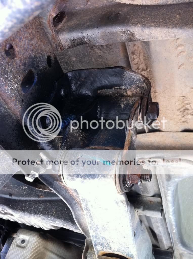

Had a rubbing issue. you gotta bend the bracket toward the fender. also, to get the shackle bolts we had to disconect the shocks, as the hitch was in the way.
new shackle, 2 inch setting:

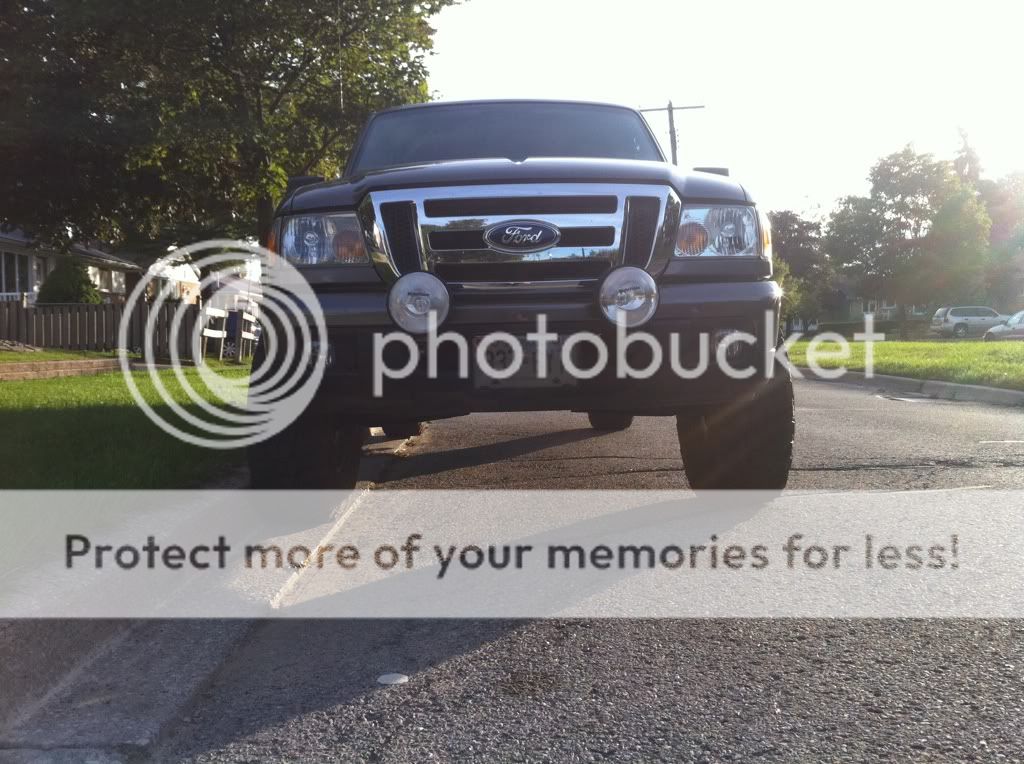

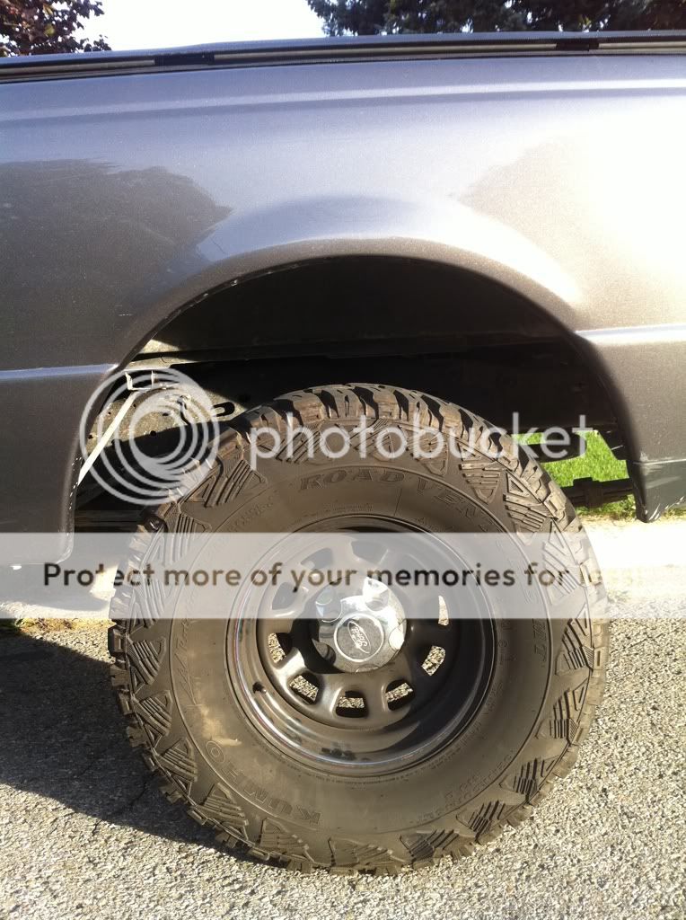

on the ground:
Looks good man! Solid job. :icon_thumby:
Did you have any troubles with your tailpipe getting in the way of your new shackles? Some people have to cut their's because the shackle is too long.
The tail pipe was touching, I bent the hanger to allow the room for the longer shackle.
The exhaust doesn't touch now.
We had a good time doing the install. Wasn't overly hard. Just time consuming.
Sweet. And what did you grind the spindle and control arm for?
clearance for turning. would move 15 degrees without the mod. i basicaly made my own steering stops, as the stock ones are no longer used. the fitment is pretty good, just needs some modifications.
Man that looks pretty good!
thanks!:icon_thumby:
Looks great man! Really makes me want to lift my truck right now haha.

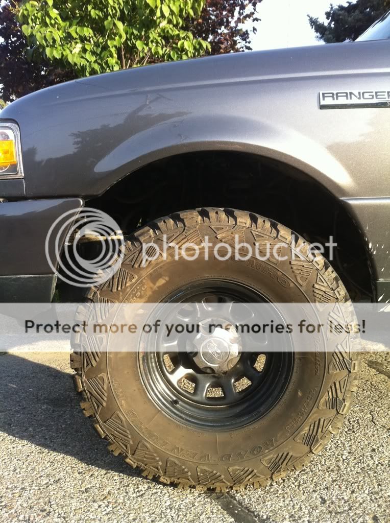

how much clearance did you gain? doesnt look like much then again pictures never do justice as in person does haha nice looking truck man love the color too
a full 3 inches over factory. the rear clearance didnt change as its based on tire size. im gonna guess in the neighbourhood of 20-24 inches in the front.. ill measure though.
