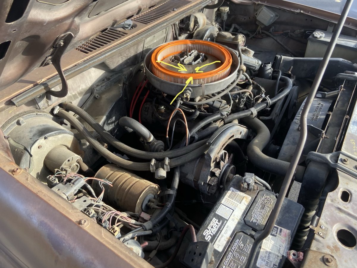

Speaking of vacuum leak.. There’s a vacuum line that stubs up within the intake.. and within the circular air filter, beside the circle cutout for the carburetor. Should this have something attached to it? (See attached)

It's been to many years since I've looked at one of these... I think that might be a thermo switch for the air pre heat door in the snorkel. I don't believe there is anything connected to it from the inside. @19Walt93 worked with these and has a super memory... he might know for sure.

Sometimes a hot idle device is added, which is a small bimetal thermostatically activated air leak intended to increase idle speed on hot engines. This could be mounted in the air filter housing. It looks like what I'm seeing in your picture, but it's hard to tell. If that has failed open then it would be your high idle problem. Plug it and see what happens, it's no big deal to run without it for a while. If you plug it disconnect the hose and plug it at the line, covering that exposed tube won't work.
A larger tube may run into the air filter which could be the fuel bowl vent. That would not have anything on it.
The hot idle compensator isn't in the air cleaner, it would mount to the back of the carb. The piece in the air filter shouldn't be capped. Vacuum should feed one side of the vacuum valve and the other side would connect to the air cleaner vacuum motor that allows warm air to be drawn into the air cleaner during warm up.

Something else I noticed in your picture... The air cleaner snorkel is missing the flexible coupler between the air cleaner and the cold air intake. This would allow heated air in the engine compartment to be drawn into the air cleaner opposed to drawing in fresh air from the front of the vehicle. You should look into sourcing one of those...
