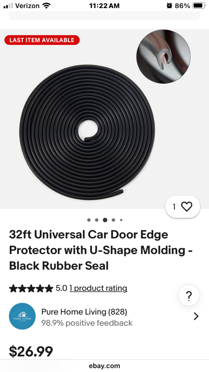

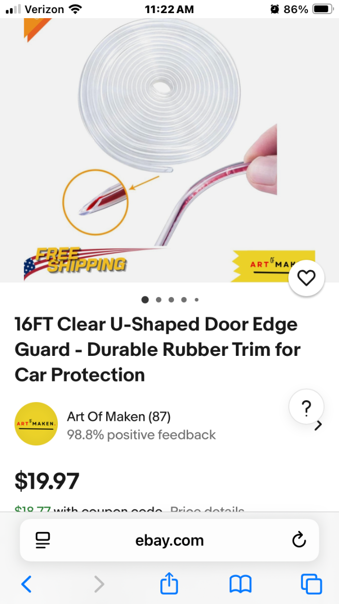

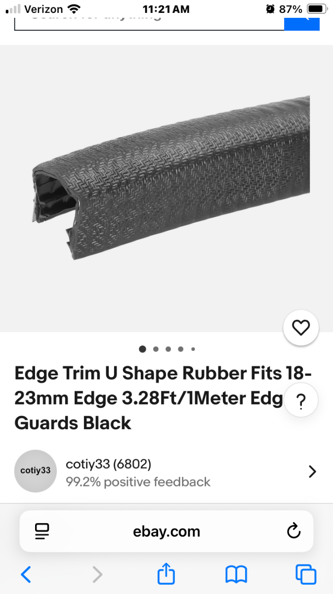

I’ve bought it before, but I couldn’t find it in a three minute search, but there was a vinyl (not rubber) C channel available by the roll that slips over the edge of the glass. My thinking is if the windshield is just glued in, why not put that C on the windshield before you glue it down which should protect the edge. Probably should put a little bit of the glue inside that C channel as well so you don’t get any drips migrating around the inside of the channel.
We used it on some of our commercial vehicles back in the day on the side windows. When you put it on the glass, you may have to warm it with a heat gun to go around the corners without warping and making waves on the face, or you may have to do little tiny diagonal cuts, so it will mold/curve correctly.
I’ll try to look again and see if I can find it
This kind of stuff

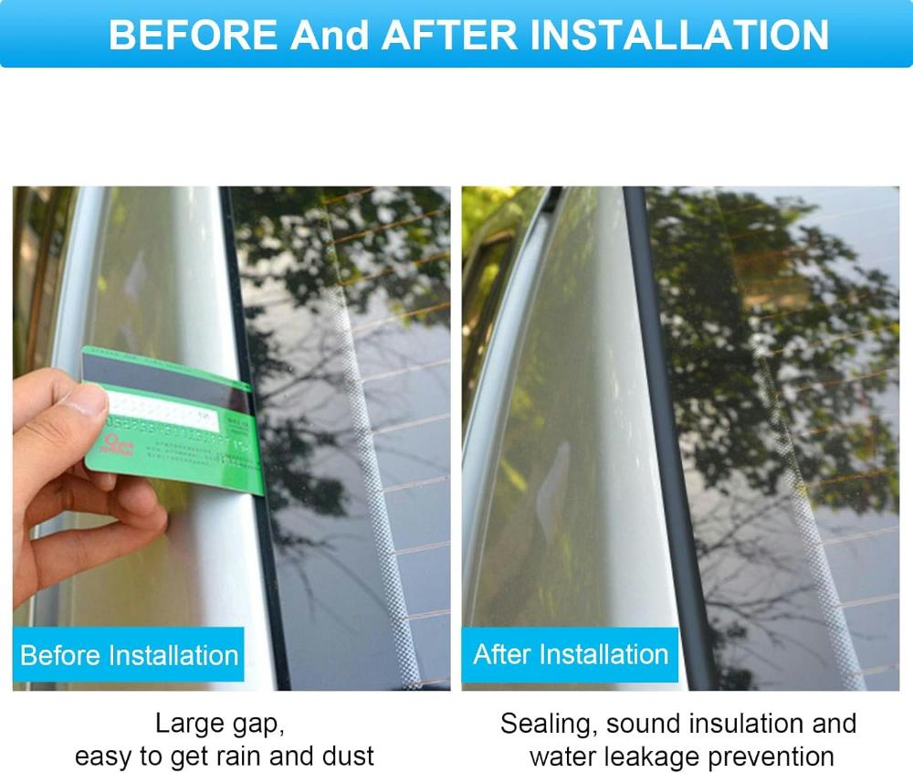

I just did a search and found that there's actually a bunch of companies on Amazon offering Rubber Windshield Molding to go along the edge of your windshield.
When I finally get a new windshield, this is going to be my next mod!
