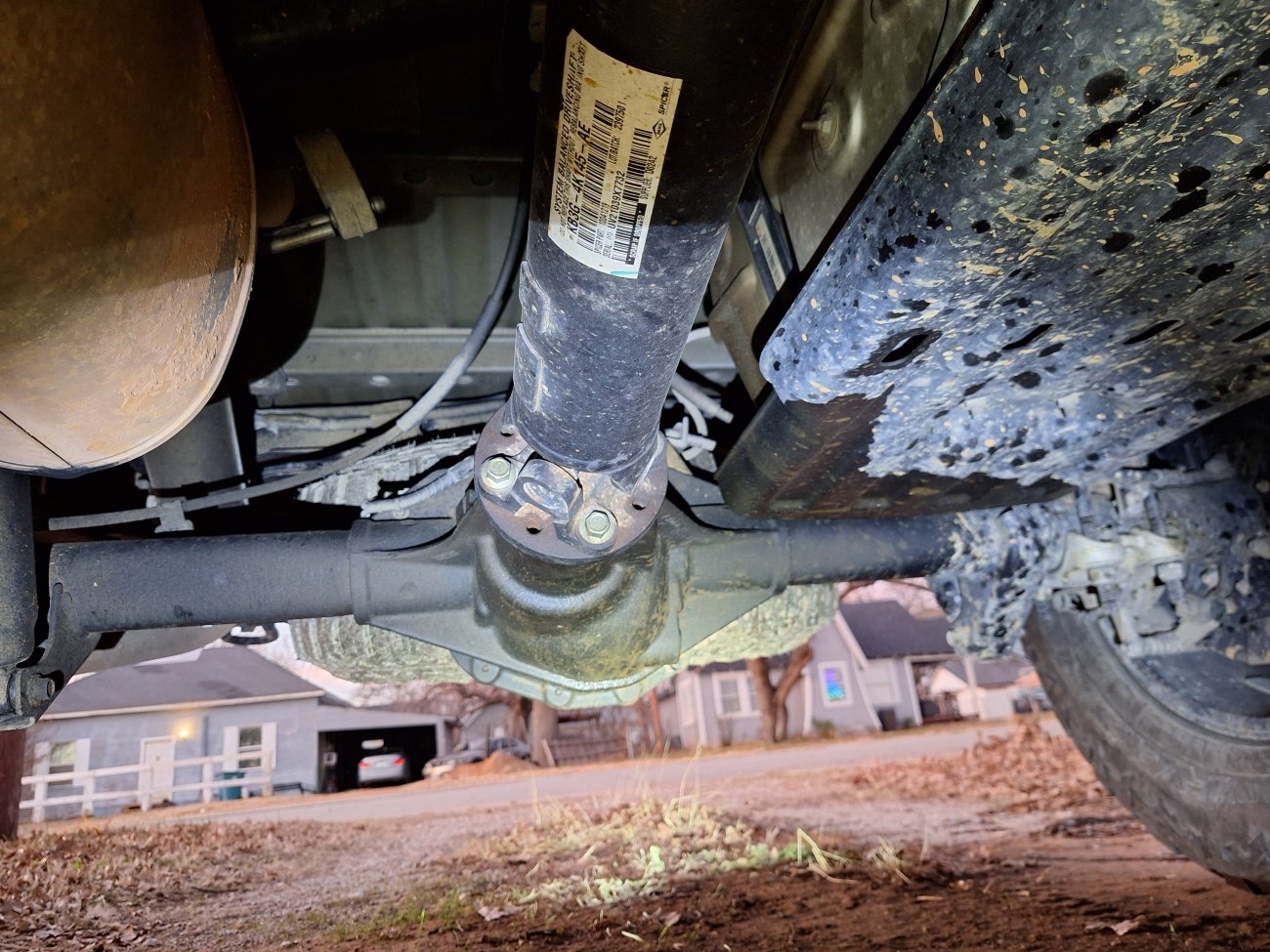

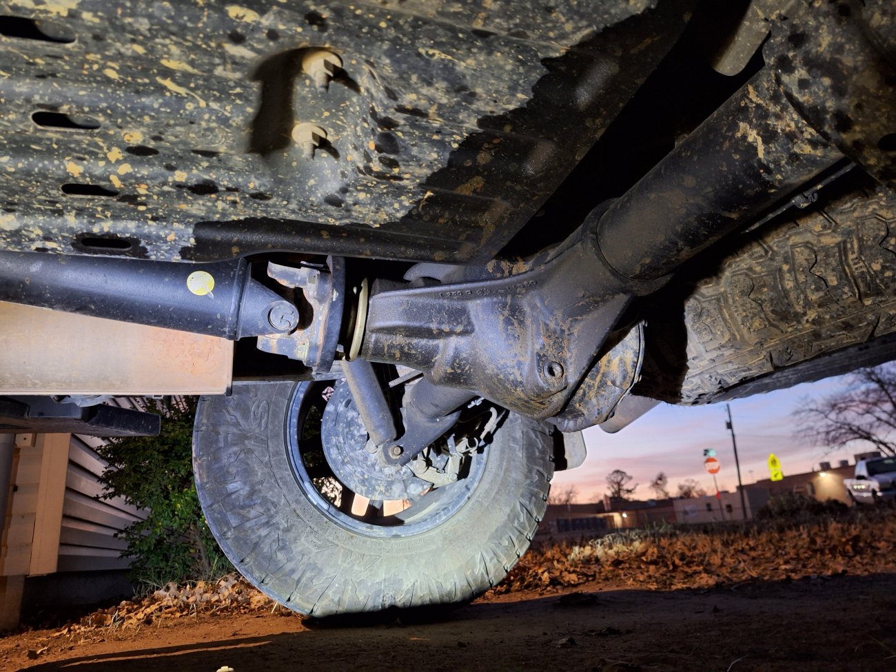

I was looking under my Ranger today and saw that the bottom of my rear differential and the bottom end of my gas tank skid plate is wet, and you can see spots where it looks like oil has been flung, but there aren't any wet spots on the ground under it. It looks like my pinion seal is leaking pretty badly when the driveshaft spins. I had to have the front pinion seal replaced, but it was just wet on the bottom lip. This looks like a pretty serious leak. And unfortunately, I can't find any alternative spots where it could be coming from.

I checked the differential fluid, and it was low. I added 5-ounces. Looks like I'll be replacing a pinion seal. If anyone has any tips on replacing it and nut messing up the pinion preload in the process let me know.

So I had checked the fluid back in December when I drove to Ohio and ended up adding gear oil, but checked it coming back and it was over full. It must not have been level when I checked it on one of those occasions.
A few days I ago I parked it on a level surface and checked the rear diff fluid. As soon as I removed the fill plug oil came out, so I let the excess drain out and screwed the plug back on.
I also checked the vent tube and confirmed that it's not clogged.
Tonight I can home after driving for a couple of hours and when I got out of the truck I smelled something hot. I felt all four wheels and they felt normal. I crawled underneath and felt the diff cover and it and the pumpkin felt hot. I'd say the cover felt hotter. I just got done driving 75 mph for 1.5 hours, so that's obviously a factor. It could also be that gear oil flung on the exhaust pipe and that's what I smelled.
It's weird. There's definitely gear oil coming from this thing, but it's not losing a lot either. I have a new seal but I haven't replaced it yet because:
1) It's not that simple. I have to reinstall the nut back on the pinion and make sure it goes back into the exact position, or I'll end up destroying the ring gear.
2) The premature failure if the seal makes me concerned that there's another issue going on. I'd say I noticed this leak somewhere around 85k miles.
I've abused the 8.8 in my other Ranger and have never had a seal leak.

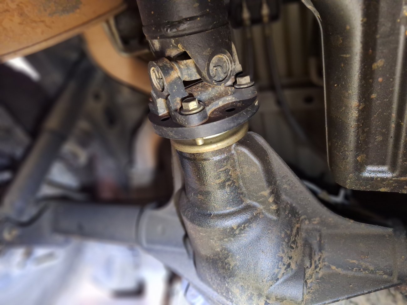

On other Ranger pages and FB groups I've seen more people complain about seals going bad in the front axle than the rear axle, so check the front too. Unless you're sure it's the rear.
I had front pinion seals leak on both my 02 Ranger and 08 Sport Trac, both early enough that they were still on warranty.
