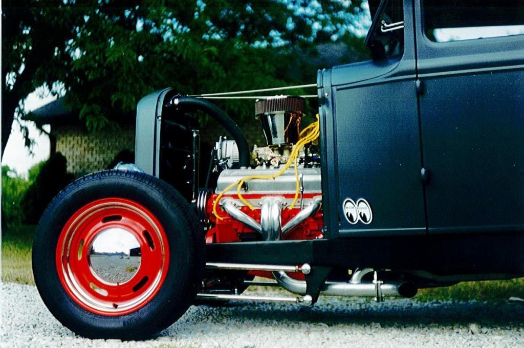

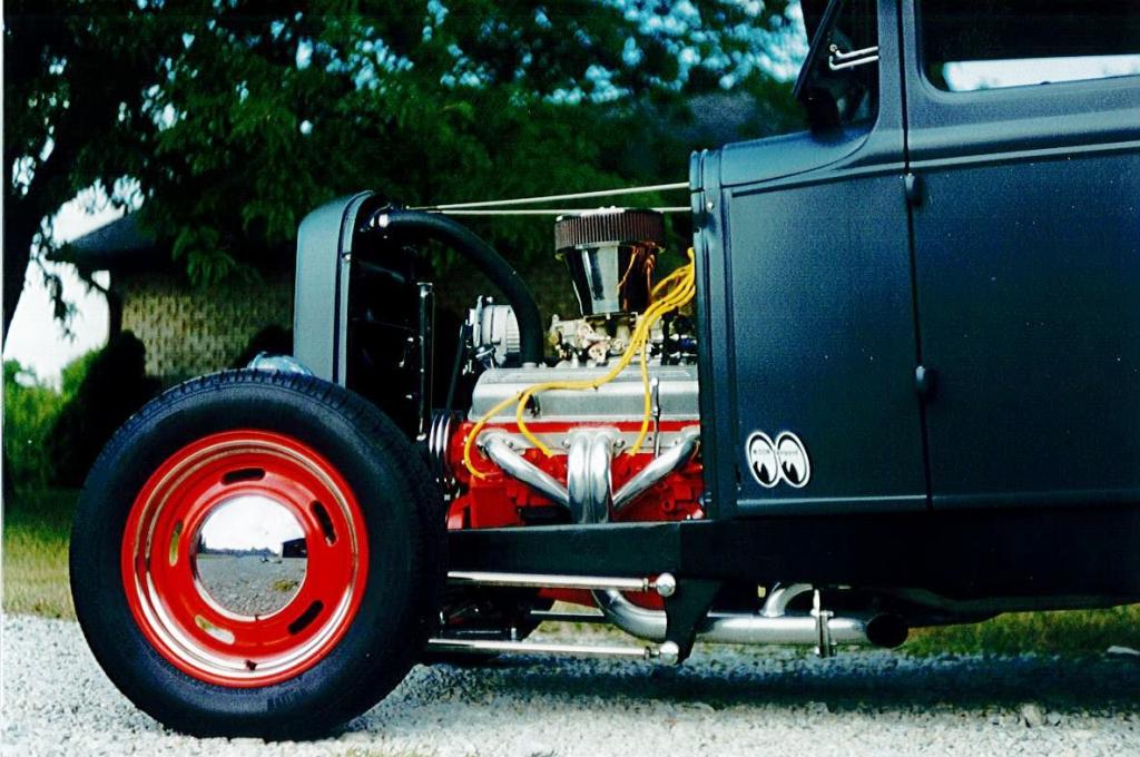

That being said I still use Valvoline (dinosaur based) Racing Oil in my (2) non roller cam Hot Rods (both 350 Small Block Chevy's) just because Valvoline Racing Oil has a high zinc content... I don't want to wipe out a cam.

That being said I still use Valvoline (dinosaur based) racing oil in my (2) non roller cam Hot Rods (both 350 Small Block Chevy's) just because they are high in zinc... I don't want to wipe out a cam.
View attachment 52953View attachment 52954
High zinc oil is well worth doing with any flat tappet cam, especially a SBC since they ate cams from 1955 until they went to roller cams. My 2016 Escape AWD 2.0 EcoBoost gets high 20's for mileage using Mortorcraft and the 351 in my Ranger is a fresh rebuild so I'll stick with Motorcraft during the break in period.
