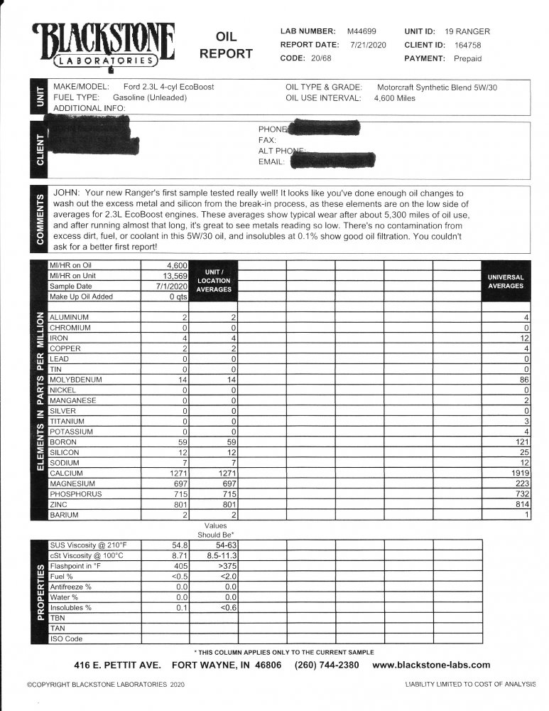

Oil changed at 4600 miles--13550 total miles, at change--Blackstone report attached--Motorcraft Synthetic blend 5W-30 used--Reg 87 fuel run always, from Sam's Club. All city driving on this crankcase oil--Temps this summer, are REALLY HOT!!
