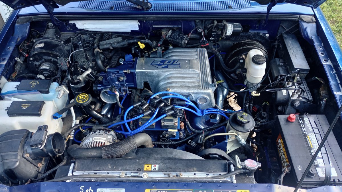

I figured I'd make a little write up about my 2009 Ranger 4x4 V8 swap since as far as I know nobody has done this to a Ranger this new. I've seen it done to an 04, but there are some more differences between the 09 and the 2000 explorer.
First of all I'll get into the basics that have been discussed at length elsewhere. I purchased a complete 2000 explorer limited AWD to cannibalize for this swap.
I started by swapping over the rear axle, and while I was at it I had the whole thing rebuilt, an Eaton True Trac installed, and regeared to 4.10s. I also bought a used dana 35 SLA with 4.10s already, and had it resealed. I did this part of the swap while my 4.0 was still fully installed and running. In retrospect I probably would've waited until the engine swap was happening to do the front axle because I had to drop the front axle again to swap out the motor mounts for new 5.0 mounts.
I pulled my 4r70w from the explorer and had it rebuilt and upgraded a little bit. I purchased a bw4406 electric shift transfer case from an 03 f150 at this time as well, and had my transmission guy reseal it and check out the condition of the case.
I pulled the 5.0 out of the explorer, tore it down to a short block, and found out that despite having 150psi compression across the board, I had pretty deep scoring near the bottom half of the stroke of one of the cylinders. Ended up purchasing a rebuilt short block off marketplace and putting all the explorer stuff on there, cleaning and painting as I went. I installed a 35-351-8 cam and the TFS valve springs for gt40p heads. I gasket matched the lower intake as well.
Mechanically, the installation went very well. I had no issues dropping the engine in and bolting it up to the 5.0 mounts, and the transmission fit on the ranger crossmember.
*** I heard elsewhere on this forum that the entire drivetrain must be shifted slightly to the passenger side in order to fit a bw4406 case without hitting the frame. This information turned out to be incorrect in my case, and I ended up moving everything back to the stock location after realizing I had plenty of clearance. This may not be the case for older rangers.***

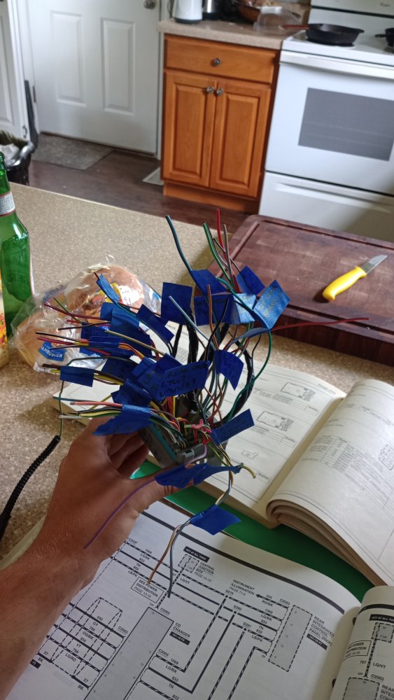

To solve the wiring harness issues I decided to use a lot more of the explorer wiring than has been done by others doing similar swaps. I used the engine harness, engine bay harness, battery harness, main battery fuse box, abs module, dash harness, and instrument cluster. I chose to "marry" the harnesses inside the cab, primarily on the floor along the transmission tunnel. To do this I clipped the 84 pin connector out of the explorer on the side that goes down the driver's door pillar, and proceeded to study the wiring book for hours labeling all the wires. Turns out the explorer is way more complicated than the ranger, and only about half of the wires actually do anything for us. I identified what was important and started building an adapter harness to overlay the dash harness and ultimately splice into the remaining ranger wiring.

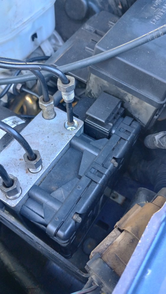

The abs module from the explorer has to be installed because it handles the vss signal and because it plugs into the explorer engine bay harness. Fits in easy enough but I had to buy one adapter fitting and I had to bend the brake lines from the master cylinder.

I'll post some wiring diagrams with my notes later in case anyone can use them someday.
Marrying the harnesses has been a trick for sure but the good thing is that none of the splices I had to do are in any super critical circuits except for the fuel pump. Everything should work just like it did on a stock truck, except for some explorer-only features I deleted.
