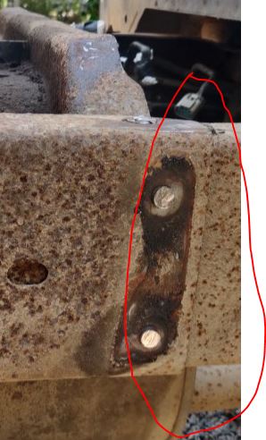

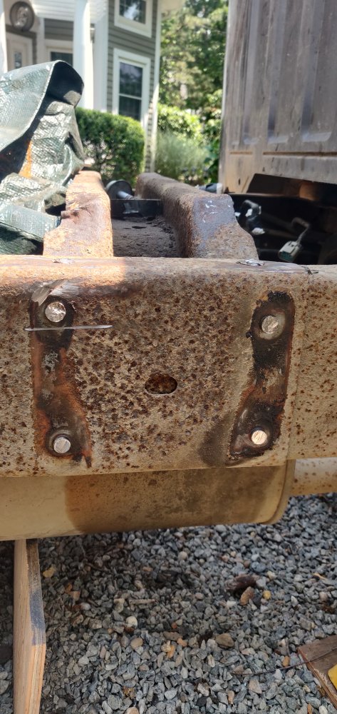

As you can see in the first photo, the rear leaf spring shackles are completely detached from the frame. I had been driving like this for a little over a year before I found a replacement frame locally, and was able to pick it up.

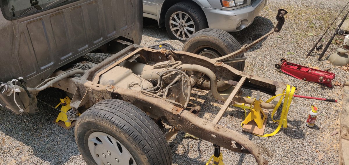

After taking off the bed (all bolts broke), rear tail lights, filler neck, vapor canister, assorted wiring/brackets) I started by taking the leaf springs off. After they were off, I removed the gas tank (definitely be empty when starting, makes the whole process easier; also, take pictures along the way, even if you never look back to check.)
With the gas tank removed, time to start grinding off the rivets. I fortunately had someone with experience working exclusively on Rangers on speed dial, and he recommended to start with a grinding wheel, take off the majority of the material, give it a few taps with a mini-sledge and punch, and then grind more. Not much to add to that, other than wear the appropriate PPE, especially goggles. Buy 2-3 wheels, as when they wear down, they start to become harder to maneuver in tight spaces.
With all of the rivets ground down and punched out, the rear section slides off without issue. (I did the majority of the project by myself, but with proper jack stands/pumps, this can be done with one person).
With the main sub-frame removed, the cross member can be slid/tapped out.

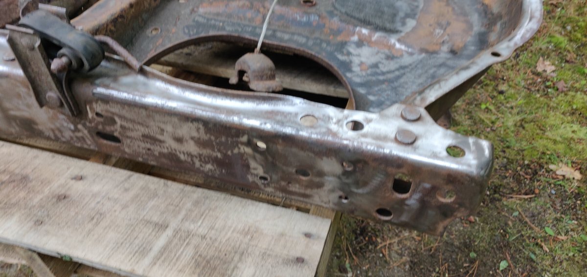

Ideally, prep on the new frame should be done beforehand (wire wheel/brush, rust converter, enamel, etc), but I wasn't able to.
Beginning with the new frame, grind out the rivets the same as before if the place you bought it from cut right on the cab rails. If you need/want to replace the leaf spring hanger or shackles, along with the shock mounts, now would be the time to do that.

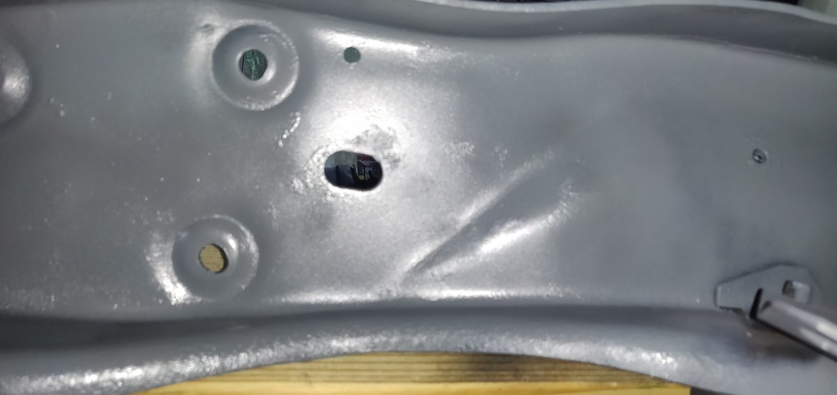

Now, the worst part of the entire project: frame prep. With an angle grinder, metal brushes, and wire wheels for a drill, it took roughly 5-6 hours to get the frame, cross member, and exhaust heat shield to a place where I felt comfortable beginning rust-proofing. Harbor Freight has a variety of wheels/discs (the polycarbide disc is very effective, and removes little, if any material other than rust). I tried using a cut off wheel to take the head off of some rivets before grinding, but didn't notice it being easier to punch out. If a rivet was very stubborn, I would take small drill bits and work by through the center of the rivet so that I would have something to set the punch in, and also allow the metal to 'cave in" and push out. I did also use heat, mainly on the cross-member bolts from the new frame. Tip: try not the bend the wings of the cross-member, as when you go to intall, it may create a gap that will close when torqued, but overall makes it harder as the holes do not line up as they should. If they do get bent, do your best to flatten then out before you slide it in the frame.
After everything was wire wheeled, I took acetone and wiped the frame 3-4 times (until the rag was clean) and used a shop vac set to blow to speed up the drying process. After waiting an hour for the acetone to evaporate (overkill, but at this point, what isn't?), I used three cans of Rust-Oleum rust reformer (https://www.amazon.com/Rust-Oleum-Automotive-248658-10-25-Ounce-Reformer/dp/B003HG48AC/ref=sr_1_2?keywords=rustoleum+rust+reformer&qid=1688182821&sprefix=rustoleum+,aps,122&sr=8-2, per Project Farm's recommendation) to base coat the frame, following the instructions on the can.

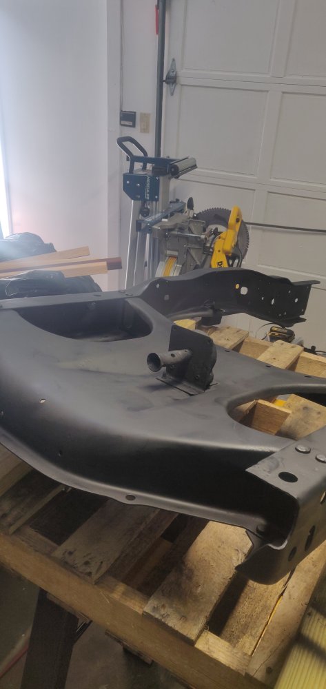

After waiting a day or two for the paint to dry, I covered the frame with Dupli-Color grey enamel (I chose grey so that I would see the black WoolWax coverage after). For good measure, I also covered all the new hardware I bought with a light coat of the Rust-Oleum and Dupli-Color.
As the paint was drying, I purchased Grade 8 hardware (nuts, bolts, lock washers), making sure to purchase bolts that had shoulders that would clear the washers. A lot of frame repair that I saw online used shorter bolts, and that may be okay short term, but ideally something with a shoulder that isn't digging into the threads will be better for the frame, hardware, and strength long-term.
As per Ford's recommendations, I went to the next size up, 1/16 of an inch, for the bolts (3/8 to 7/16, and 7/16 to 1/2). Spend the extra money and get a drill bit that will not bind in the hole and get dull. This was by far the most nerve-wracking part of the process, as making the holes bigger without a reamer is possible, but requires some level of precision. What worked for me was getting the bit going as fast as possible, touching it lightly to the hole to get centered, and then pushing in with even pressure all around as not to cause it to oval out, as eventually this would cause the oval to widen over time. Out of the 30 or so bolt holes that I widened, only one or two were not "perfect". You will also need to make the holes on the new hardware the same size, which I did by taking the piece, placing it on a piece of wood, stepping on it, and then repeating the procedure (fast bit, even pressure).
Take your time; this is the most important step.
With everything enlarged, I hit it with a quick coat of Rust-Oleum and enamel (one coat before, touch ups after, as they will get scratched during installation.)

If you look at the picture you can see where the front and rear halves of the frame are riveted together.
No cutting or welding required.
