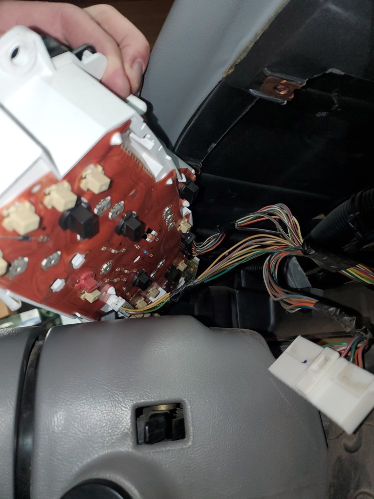

7) Now you can remove the instrument cluster itself. It just has four 7mm screws around the perimeter - remove the ones on the white plastic structure. The trick here is demating the three connectors on the back side - they are not too tough but the PCB is a flexible film that you don't want to push off of too hard. Each connector has a tab that you push down to release and then you sort of wiggle it side-to-side. Be patient here and make sure you aren't putting any force on the resistors mounted to the back of the PCB. This is probably the most actually difficult part of the whole job, but the cables themselves are mercifully long so you can move it around if you need.

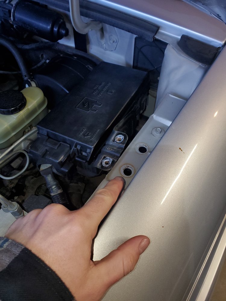

9) Next move to the engine compartment, and remove the two 8mm screws that secure the relay box. You'll need to move this aside to gain access to the two main bus connectors that go through the firewall.
2002 Heater Core Replacement Guide
It gets easier to move if you also unbolt the massive ground strap coming out of the front of the relay box, and the clutch fluid reservoir (if applicable).

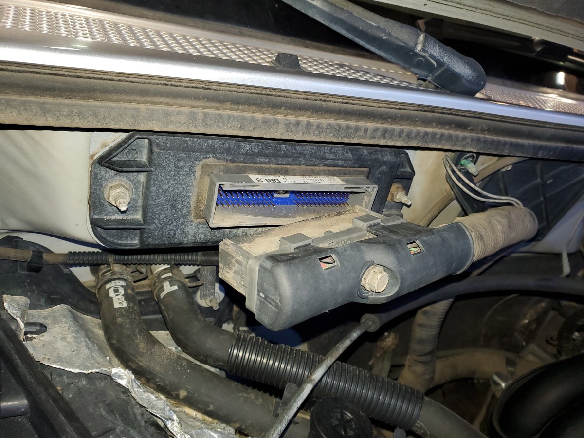

11) I'm not sure if you have to do this, but I also demated the PCM connector and removed the PCM. To do this you back the jackscrew in the center of the connector out to demate the connector. Then remove the two 11mm nuts off of the studs on either side of the PCM.
It slides out of a housing that protrudes into the dash - you may be able to remove the dash without this step, but the Chilton guide included it so I did it.
12) Now is also a good time to disconnect the coolant hoses that that go to the heater core through the firewall... they are right under the PCM. Squeeze the hose clamps with some pliers and move them down the hose. I find channel-locks work well for this. You may have to patiently twist the hoses back and forth to break them free if they have never been replaced. I didn't bother draining the coolant since this is near the top of the system, but a little bit will pour out when you take the hoses off. Try to catch it since it's very toxic to pets, etc.

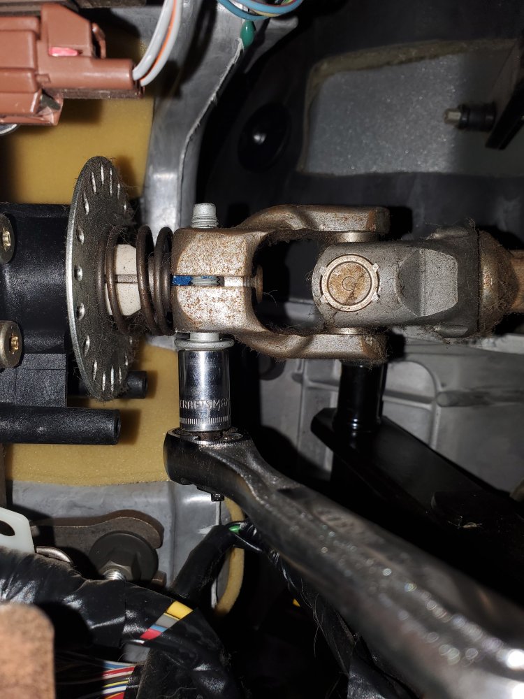

13) Move back to the cab, and remove the steering shaft pinch bolt under the steering column. It uses a 10mm socket. This will allow the steering wheel and column assembly to move away from the steering shaft when you move the dash back. You take the pinch bolt out, and then there is enough play to push the U-joint side out and down to disconnect the column from the shaft. You don't have to remove the wheel itself, or any of the plastic around the steering column.

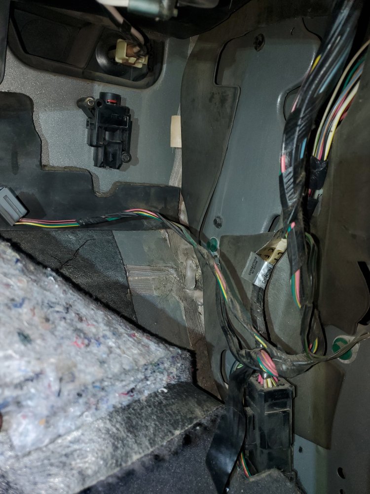

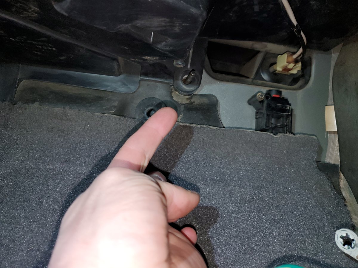

15) While you're disconnecting things, move to the passenger side and unplug the fuel pump's crash sensor reset thingie... this is right up under the glove box and you might have to pull the carpet back a bit to get at the connector on the bottom. To the right of that, under the kick panel you removed earlier, is another connector that needs to be unplugged along with two green ground lugs. Here is what the passenger footwell will look like with everything disconnected (the carpet is pulled back some):

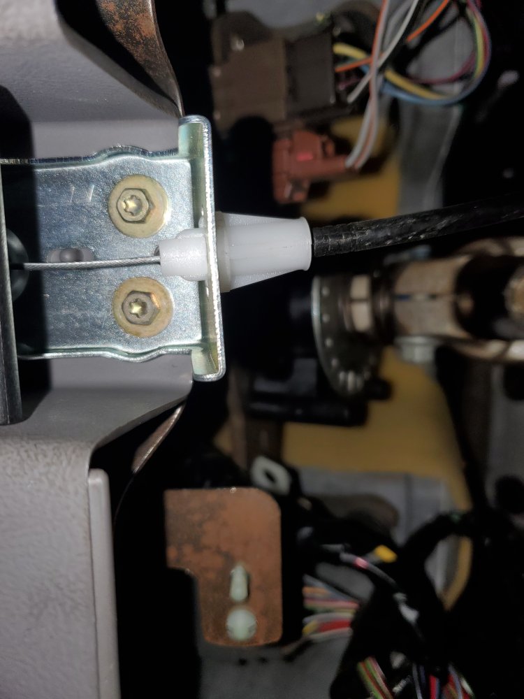

16) Disconnect two multi-line vacuum connections next... One is visible in the last image just above the fuel pump crash sensor thing we unplugged. The other is inside the dash behind where the glove box would go:
They are flexible silicone and if you look closely you can see tabs on them that allow them to disconnect. You'll also want to disconnect the heater blend door control from the top of the heater box in the cab... this is a cable loop that comes from the heat/cool knob on the HVAC controls and runs to a black connector behind the glove box. The connector is easy to remove, and once you do you can see the neat little shaft it uses to move the blend door. The connector is visible in the top right of the last photo.

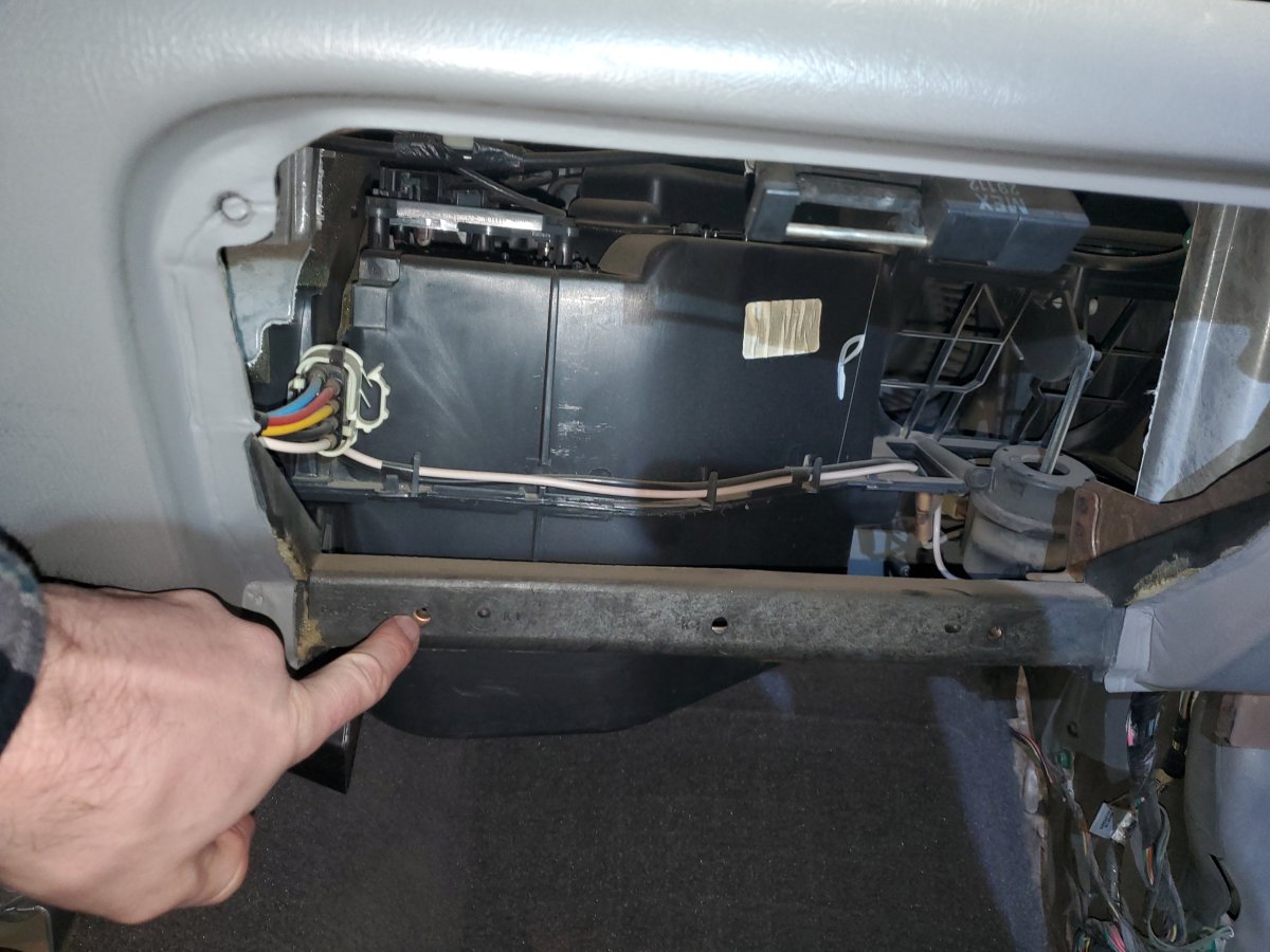

18) Now it's finally time to loosen the dash! There are two large (I think they were 13mm) bolts by the fuse compartment (pop the cover off this if you haven't yet), three on top under the defroster bezel, and one on the bottom right by the fuel pump stuff we were disconnecting. The ones on top are not as tricky to reach as you'd think, but a universal joint extension helps a lot. Also be careful not to put your wrench/hand through the windshield when they let go! Keep the two lowest bolts backed out almost all the way, so they can support the dash as you pull it back a few inches. When you're ready, lift and pull the whole dash backwards to the two remaining bolt heads. This is a good time to check for any wires or vacuum lines that are being stretched.

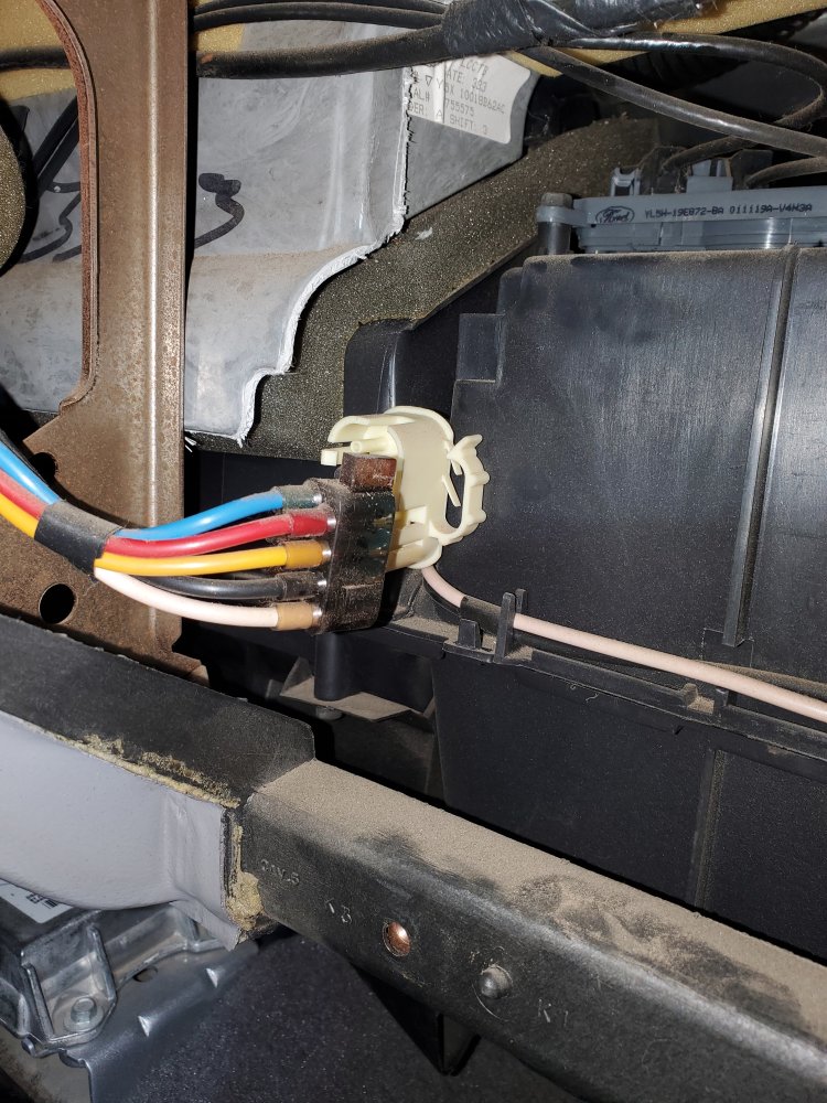

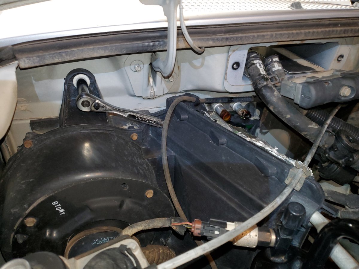

19) Before you fully remove the dash, move back to the engine bay. The assembly that houses the blower motor and AC evaporator blocks a few of the heater box fasteners, so you need to partially remove it. I'll call this the HVAC housing. You can do this without disconnecting any AC lines or anything like that; there is enough play. Remove the three 11mm nuts (they are on studs) along the top and inboard side of the HVAC housing.

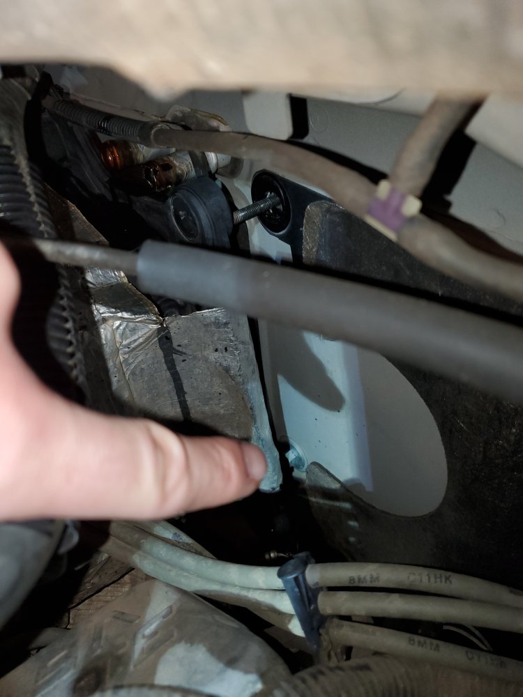

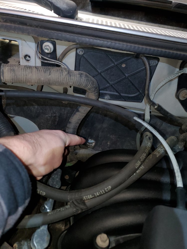

Remove one 11mm nut from a hole in the insulation on the firewall right behind the engine:
Finally, remove one more 11mm nut from a stud on the INSIDE of the cab, back near the fuel pump sensor thing you disconnected earlier:
NOTE: apparently on some models, I think after 2003, this nut is on the other side of the firewall and requires removing the black plastic inner fender liner around the wheel. This isn't too bad to do, but it's worth checking to see which side yours is on because it takes some time.
20) The HVAC housing in the engine bay can now be pulled (with some effort) back a few inches. Pull it back enough that it slips off of the threaded studs that the nuts were on. Now, you'll remove three additional 11mm nuts that secure the cab-side heater box to the firewall. Two are on the same studs that the previous nuts were on, and the third one is obvious under the top center of the HVAC assembly in the engine bay. These are the nuts that hold the heater box (in the cab) to the firewall...
