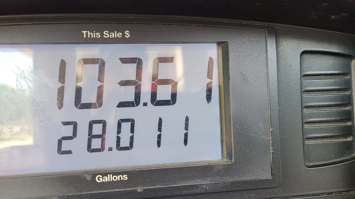

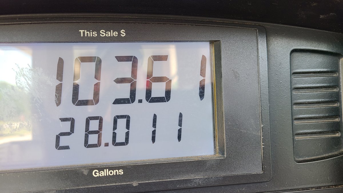

Speaking of fuel, I filled up to the top today. Bought almost 3/4 of a tank. See photo below. So, how big is the tank on this thing? I'm guessing somewhere between 38 and 40 gallons. Didn't get an owners manual. Going to have to order some books.
I believe they have a 40 gallon tank

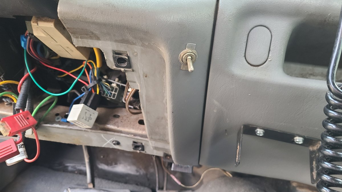

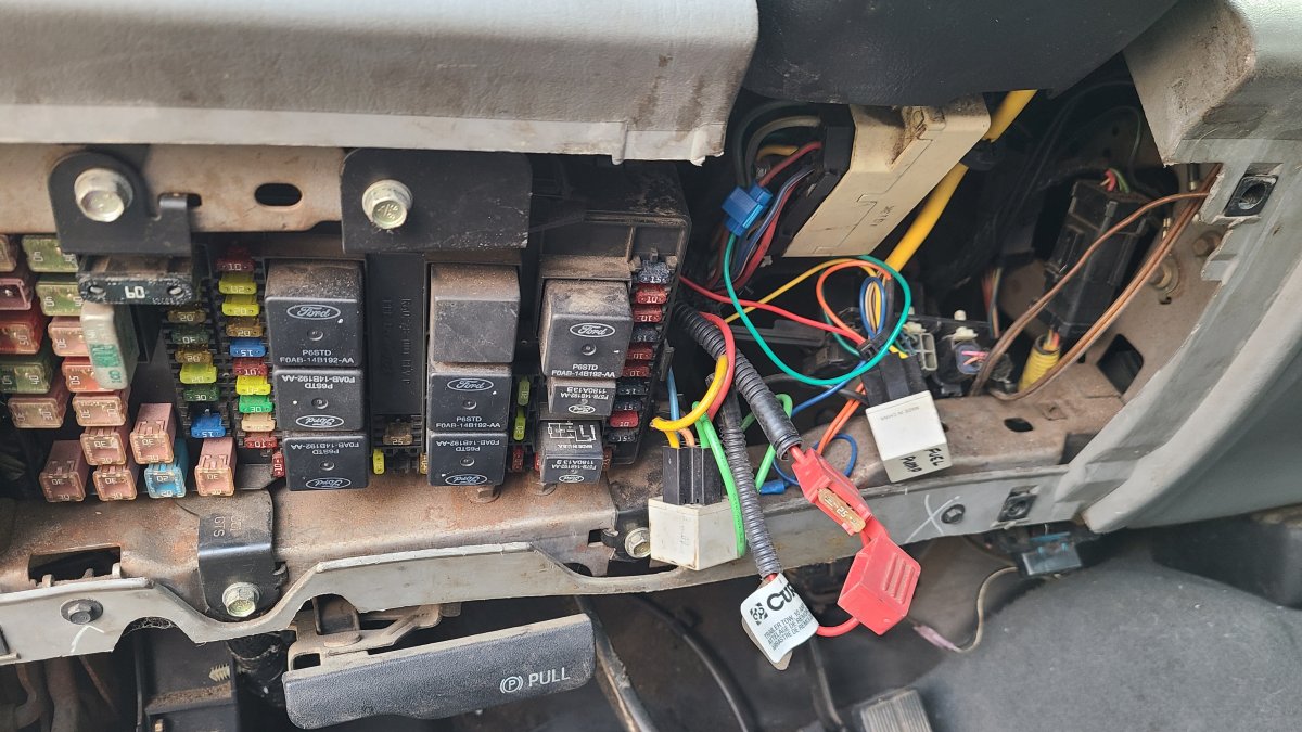

Tonight, after dinner, I went out to tinker around with it. Decided to start moving stuff over from the Fun50. Pulled out my CB radio, Ram ball mount for the phone and bracket for the gmrs radio. Carried those over to the ship and sat there trying to figure out where and how to mount this stuff. I also want to put my good Tekonsha trailer brake controller in there instead of the El cheapo one that it already has. That's when the fun began. There was a rocker switch/fuse/cigar lighter power outlet thing mounted down low on the dash. Not connected electrically. Looked for screws and discovered that it was velcroed on with adhesive backed velcro. Rip. It's gone.

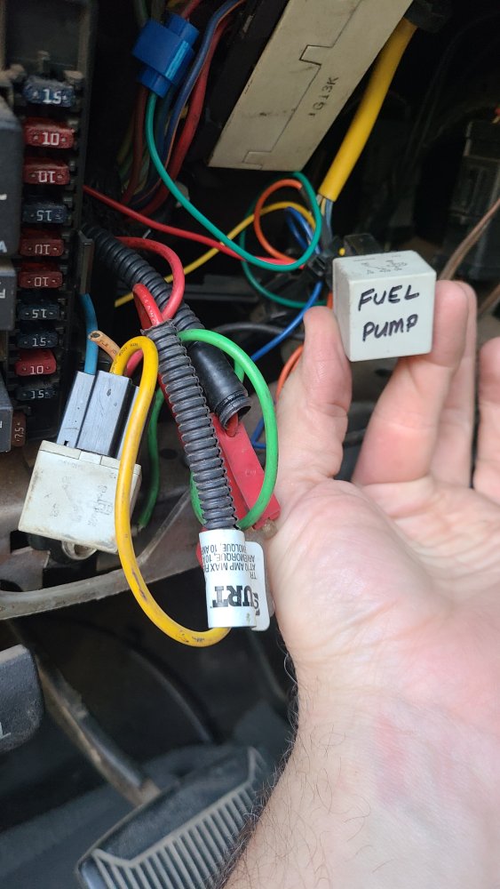

Next, I unmounted the cheap trailer brake controller. The wiring looked ugly because they had wrapped it with electrical tape that is old and was unraveling. I removed the lower valance from the dash so I could unplug the controller. That went OK. But the electrical rats nest that fell out of the dash is a source of entertainment. I'll just post the pictures and caption each one now.
Fuel pump?!? If this truck has an electric fuel pump, Ford would have put it's fuse and relay out in the engine bay. Is this a bad repair? Or was there, at some time in history, an auxiliary fuel tank in the bed of this truck with an electric pump to transfer fuel?

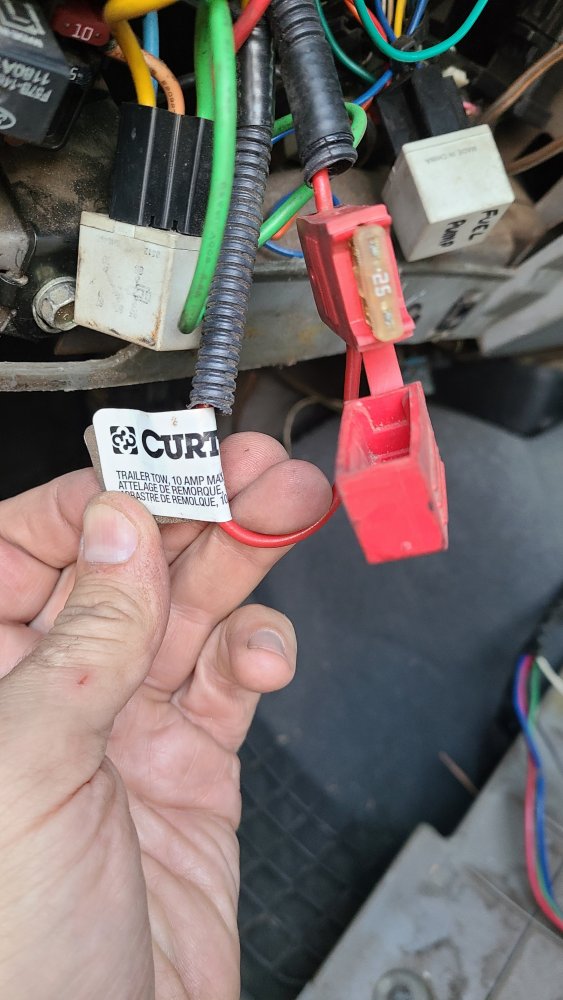

WTF? The brake controller was wired into the OEM trailer brake harness. There should be no need for this foolishness. Note the tag says 10amp max. But the fuse is a 25. These are wired into the light gray relay on the left.
Found the fuse for the mystery fuel pump. Note; I suspect that a lot of this leads to abandoned wiring. But fuses are still installed. Yikes!
Just an overall view.
What is this toggle switch for? Double pole, double throw switch wired to speaker wire going "somewhere".
Ok. The speaker wire travels under the carpet to the passenger side and through the firewall. I also discovered a red wire and black wire here that go through the firewall. The black is somewhat grounded by the screw to the left. The Red is cut and ends here.

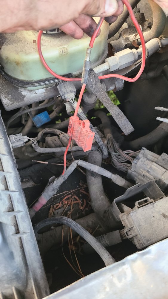

Out in the engine bay, the speaker wire traveled toward the passenger headlight area and ended. Here, over on the driver side inner fender area, we find the origin of the red wire. Note the exposed splice. Remember the other end was cut and laying jnder the carpet in the passenger footwell. Fuse is installed here. This is tapped into a fairly large wire.

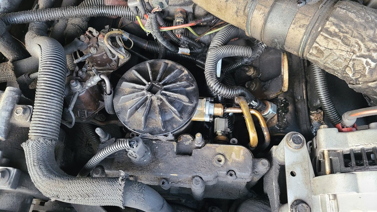

Enough electrical. This view shows where I have a fuel leak. I sprayed most of a can of brake cleaner on this stuff earlier. Maybe I'll see where it starts getting wet and dirty again. I know the black round thing is the fuel filter bowl assembly. Not sure what anything else is, yet. That rectangular thing between the fuel bowl and coolant hose is something fuel related. Brand new alternator lower right corner.
