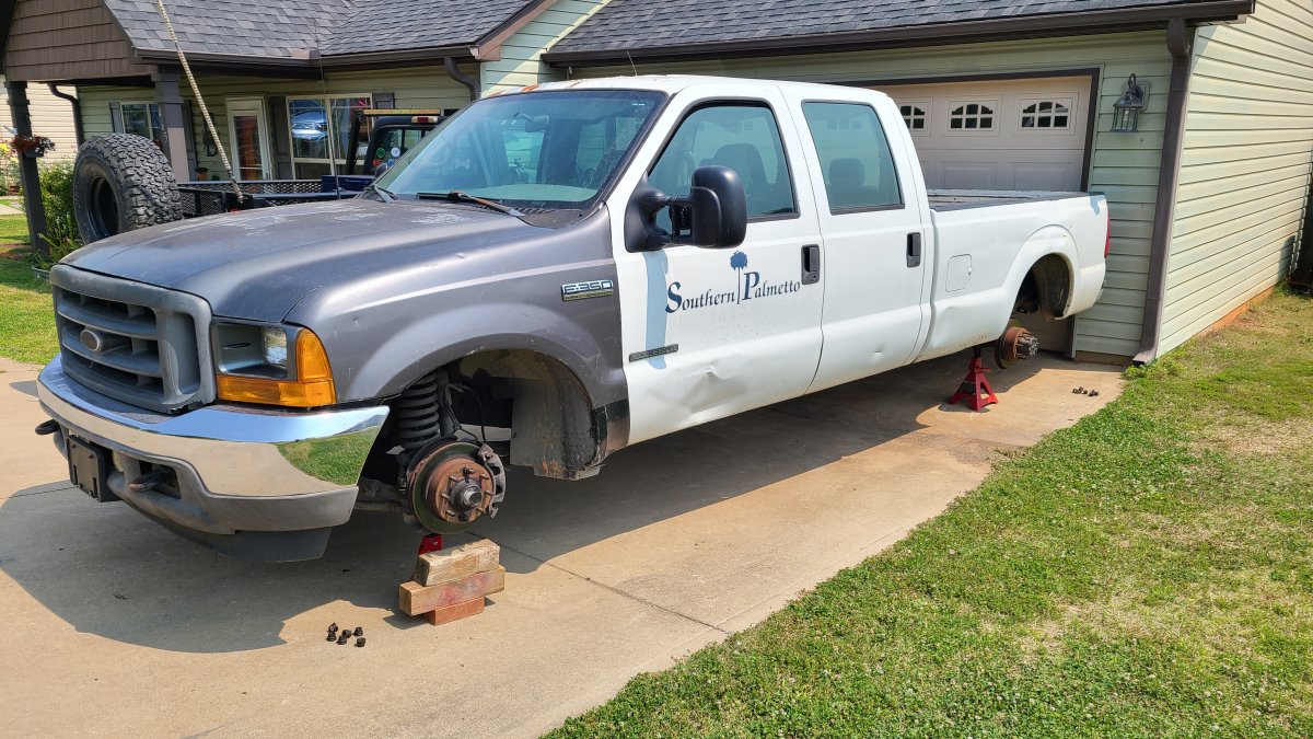

Got the wheels off and took them to get tires put on. Woodhaven them back for a few days. Decided on BFG KO2's. 4 tires, mounted, balanced + road hazard and with a BFG rebate will be around $1078 out the door. I still need a spare.

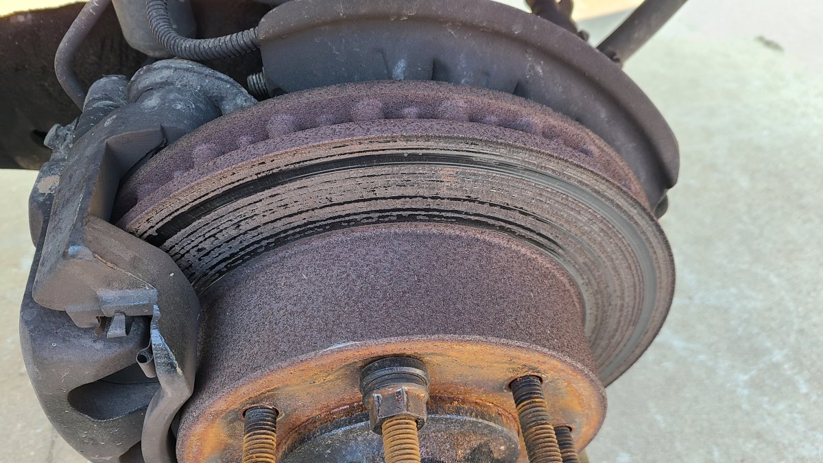

Brakes look OK except front passenger side. Needs rotor and pads. It might just get a set of pads temporarily until another paycheck or 2. Back side isn't scored at all. I'm thinking the slide pins need to be cleaned and lubed.

I don't see that much of a ridge on that rotor, could probably be fine to have them turned. If you know someone that still has a lathe.
I could check on that. I'll measure the thickness. I wonder if NAPA still does that.
I should probably buy some cement blocks. Jack stands just don't look rednecky enough.
