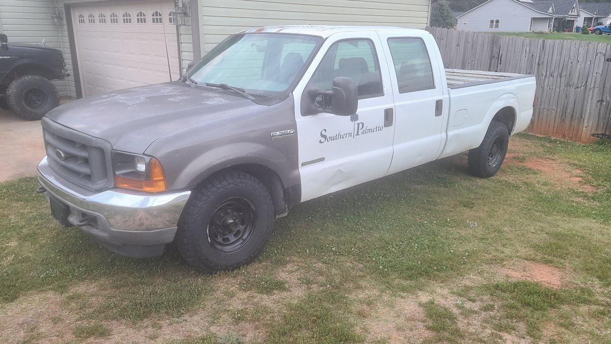

The tire shop told me they had to order my tires and they should be ready Friday. I was delighted when they called at 11:00 this morning and said they were ready for pickup. That's the part of my day that went well.
I had gone to the junk yard yesterday to get a spare tire and maybe a front brake rotor. Found several. But some I couldn't get because the trucks had fallen off the stand and were putting weight on the wheels. There were a couple that looked right that were on an E350 van, I forget whet year, but just a few years newer. Measuring with my tape measure, best I could, they seemed right. But I needed a 22mm socket and only had up to 21mm with me. Plus, 5:00 arrived and they closed.
So today, I went back, figuring it was worth the trip to save the money as opposed to buying new. I got a wheel and the rotor behind it was in decent shape. Just packed with mud and a light coating of surface rust. Went to pay and told them I didn't want to pay for warranty. It's a wheel and a disc brake rotor. Why would I need to return it?
Because when I got home, I found out that the lug pattern had gone metric. The wheel doesn't fit my current rotors and, of course, the rotor doesn't fit my current wheels. The difference is miniscule. But they don't work. Thr stud threads are metric, also. Mine must be 9/16" - the lug nuts won't thread on. So, $50 down the drain because I didn't pay for warranty and can't return them.
I bought a cheap set of pads from Autozone so I could put everything back together and drive it until I get a rotor. The bad wear was as I expected. The bottom slide pin for the caliper was stuck really bad. Had to take it to a vice and beat on it for a while. Got it cleaned up, lubed, re-assembled with new pads and it's good til I get the new rotor.
I also need a beefier torque wrench. Mine goes to 150 ft-lbs. The lugs are supposed to be 150-165 ft-lbs.

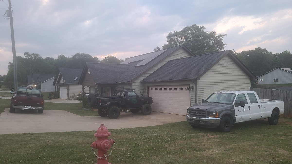

I keep my place decent. The trucks are all registered and insured and in running condition a majority of the time. I move them around to keep batteries charged and to make sure people can't accuse me of having derelicts. I have to watch how I park everything right now. I need to leave room to get the motorcycle in and out of the garage. I also hope to extend the driveway/parking area over to the side street with gravel or concrete.

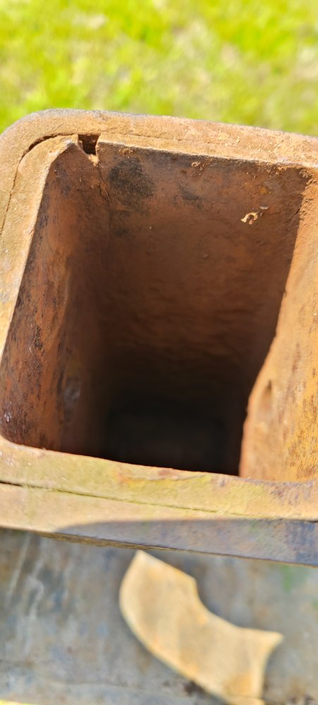

I should probably be doing something more important. But decided to refresh the trailer hitch this weekend. I told you earlier that the hole for the pin was severely wallowed out. I also discovered a crack in the bottom corner of the receiver tube. I do believe this thing towed a heavy equipment trailer every day of it's life with the landscaping crew. An 8" receiver tube from Northern is much, much less than a new hitch. I have also decided to go ahead and build a simple rear bumper for this truck. I have the material. So, I might as well freshen that up, too.
Cracked receiver tube
Can see it from the inside, too.

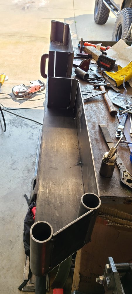

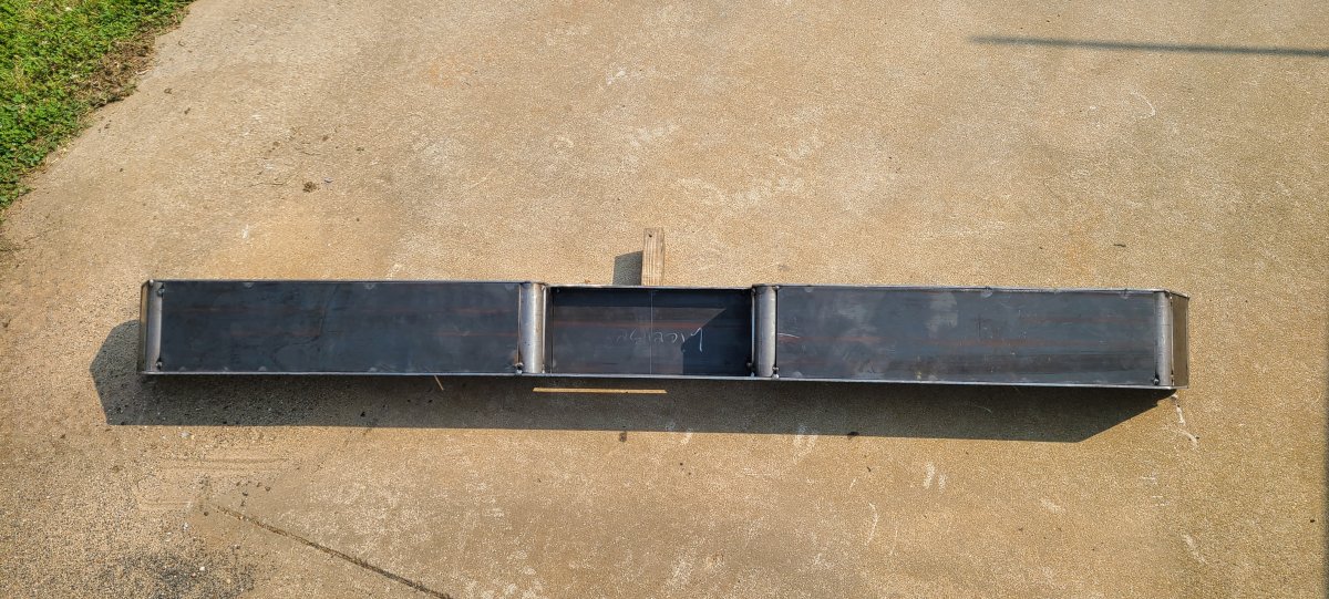

This ought to last the next 20 years or so, especially if I slap some paint on it. These views show it upside down, of course.
Bumper is tacked up. That's enough for one day.
Dang, you've been busy! That bumper looks good, I like the tube for the corners... I really should do something similar for my F350, I think it has a cheap Chevy repop chrome bumper without any chrome left, and it's twisting from me putting the rear camper tiedowns to it... not to mention the Warn winch bumper up front is only held on by like 3 bolts and well just don't look how it's attached, I try to avoid it :) (I didn't do it...) come to think of it I think it's a Chevy hitch in the back that I made into a home brew super hitch...
