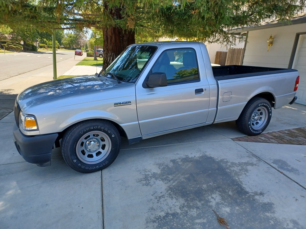

My 2010 Ford Ranger suddenly began losing power, then it would come back, then loses it again. It never died, just could hardly move. It threw a check engine light and the code said the right back was lean? It is a four cylinder. We checked everything we could reasonably check and could not determine a cause since it was intermittent. I went to Ford and purchased a new coil pack, new plugs, new injectors, new thermostat, new plug wires, and new O2 sensors. While we were at it we changed the intake and valve cover gaskets and cylinder head temperature sender.
On completion, it started right up and the problem was gone. The little Ranger runs very much better than it did. It was having some long crank start issues. All issues are gone. It runs like new. All the parts from Ford cost a little over $900 and I figured It is a 14 year old truck that has never had an issue and I am not about to buy a new truck.This little truck is in perfect shape and is our daily driver. Do dings dents scrapes or scratches. The AC is still cold as ice. When I first got this truck it was a dog. Rear end gear was way too high. I changed it out to a 410 rear end and it made a new truck out of it. The little rander scats and pulls a trailer just fine.
