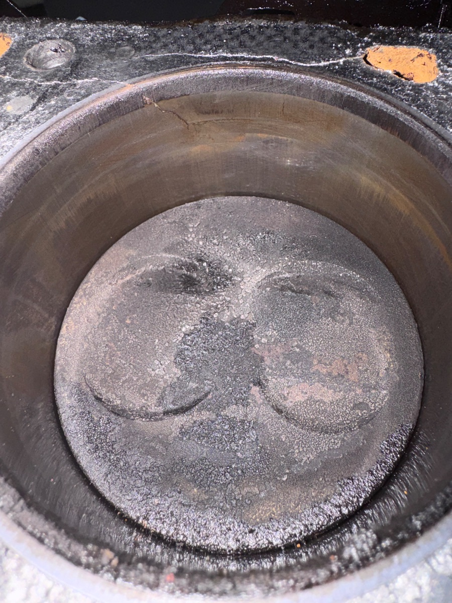

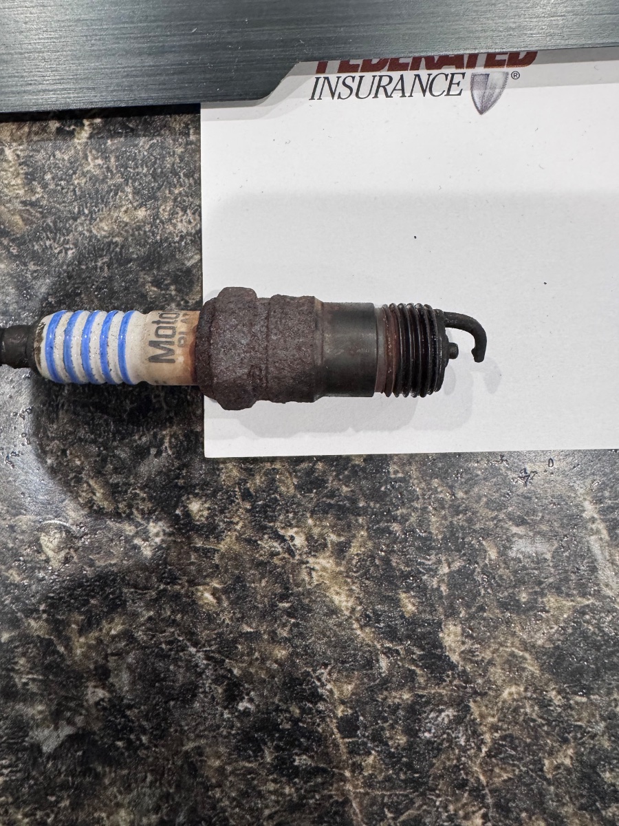

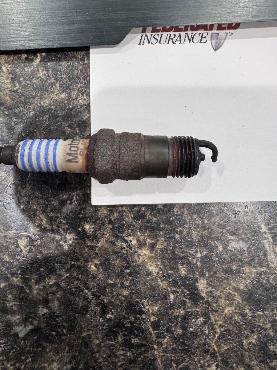

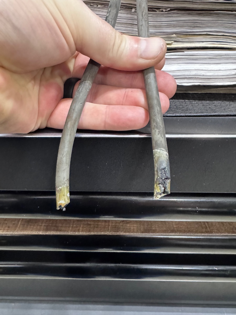

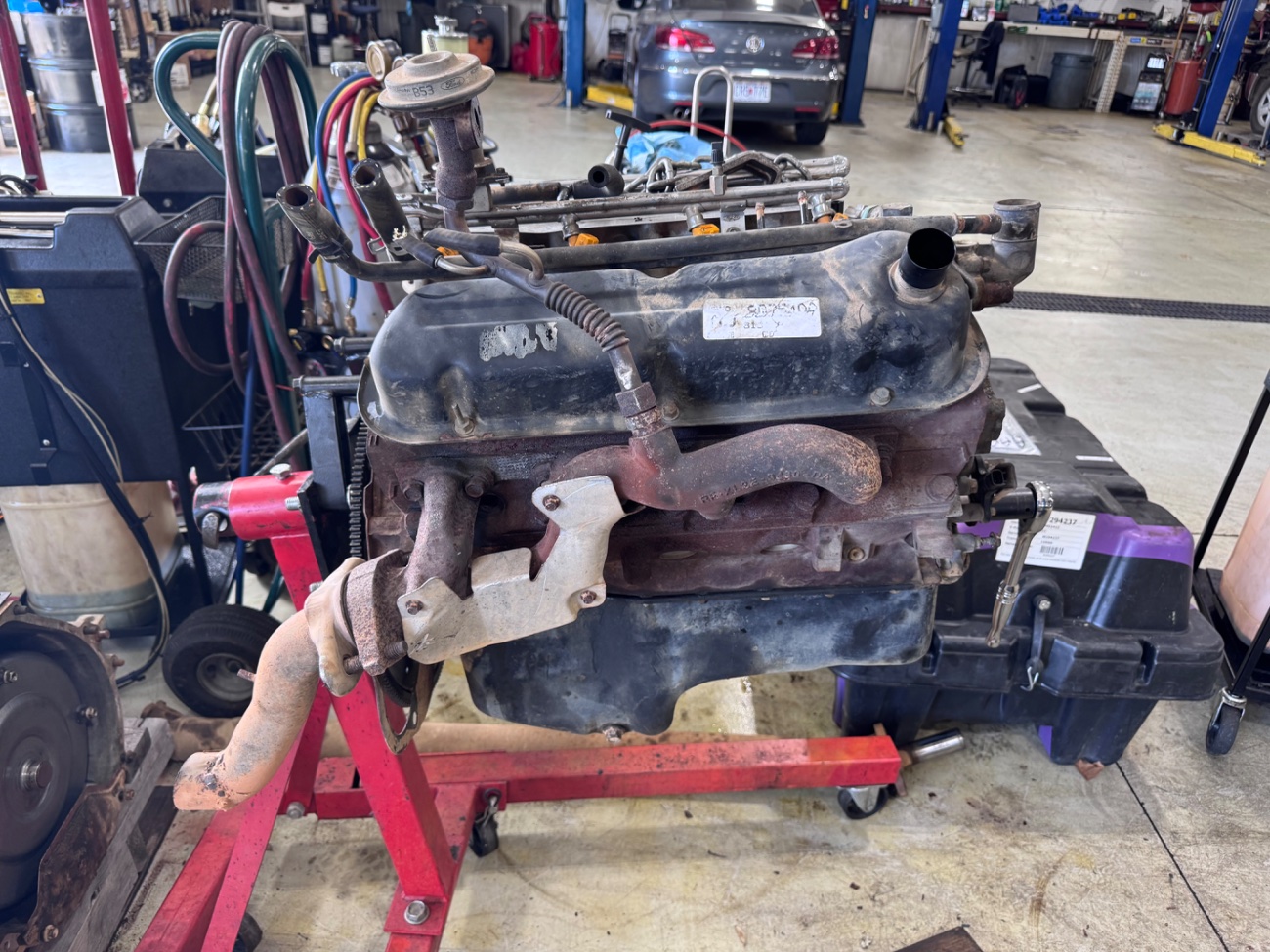

Ended up doing a leak-down test on the engine. Found it leaking from almost every valve and rings. Engine oil looked like diesel, burnt plug wire, plug gap ranging from .076 to .090. Looks like a full rebuild.

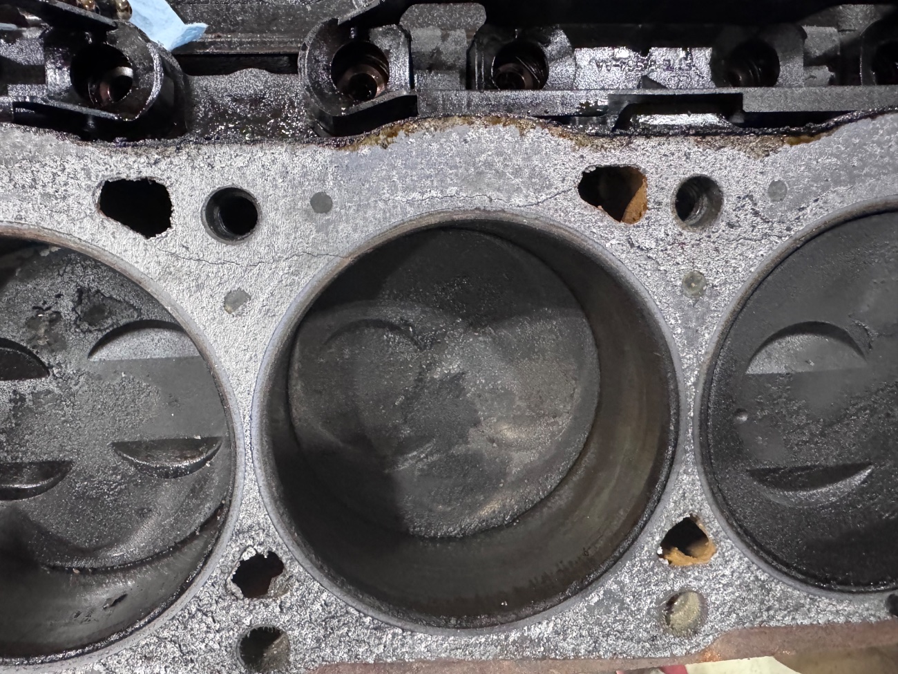

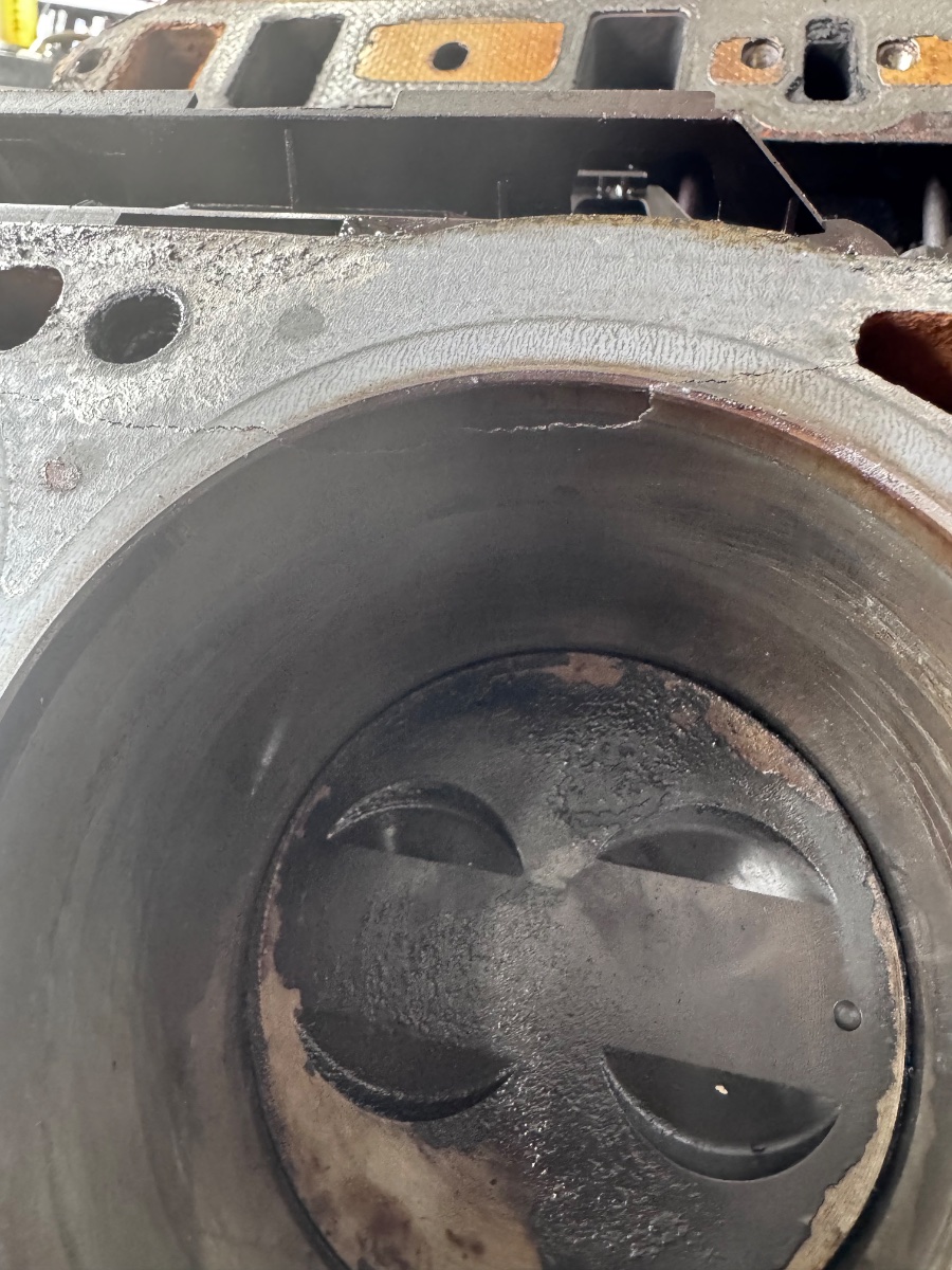

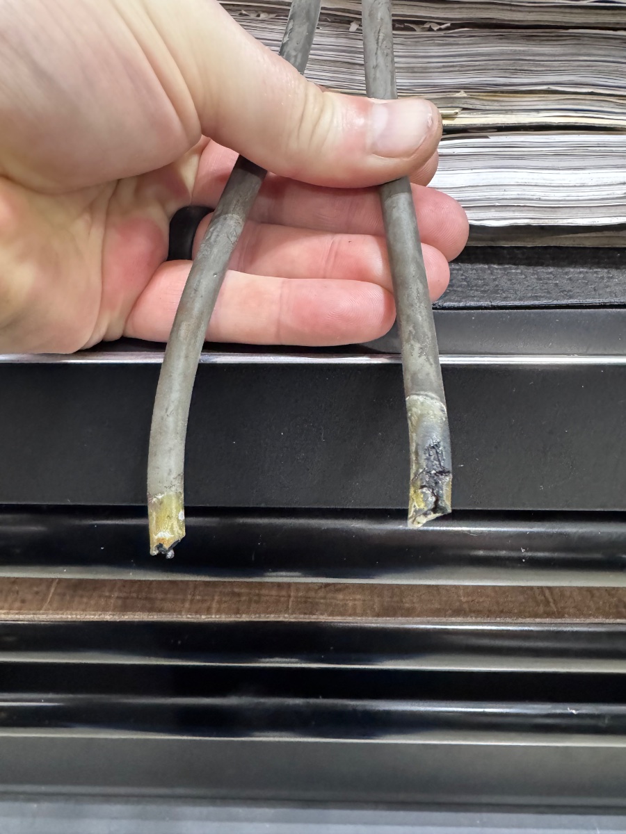

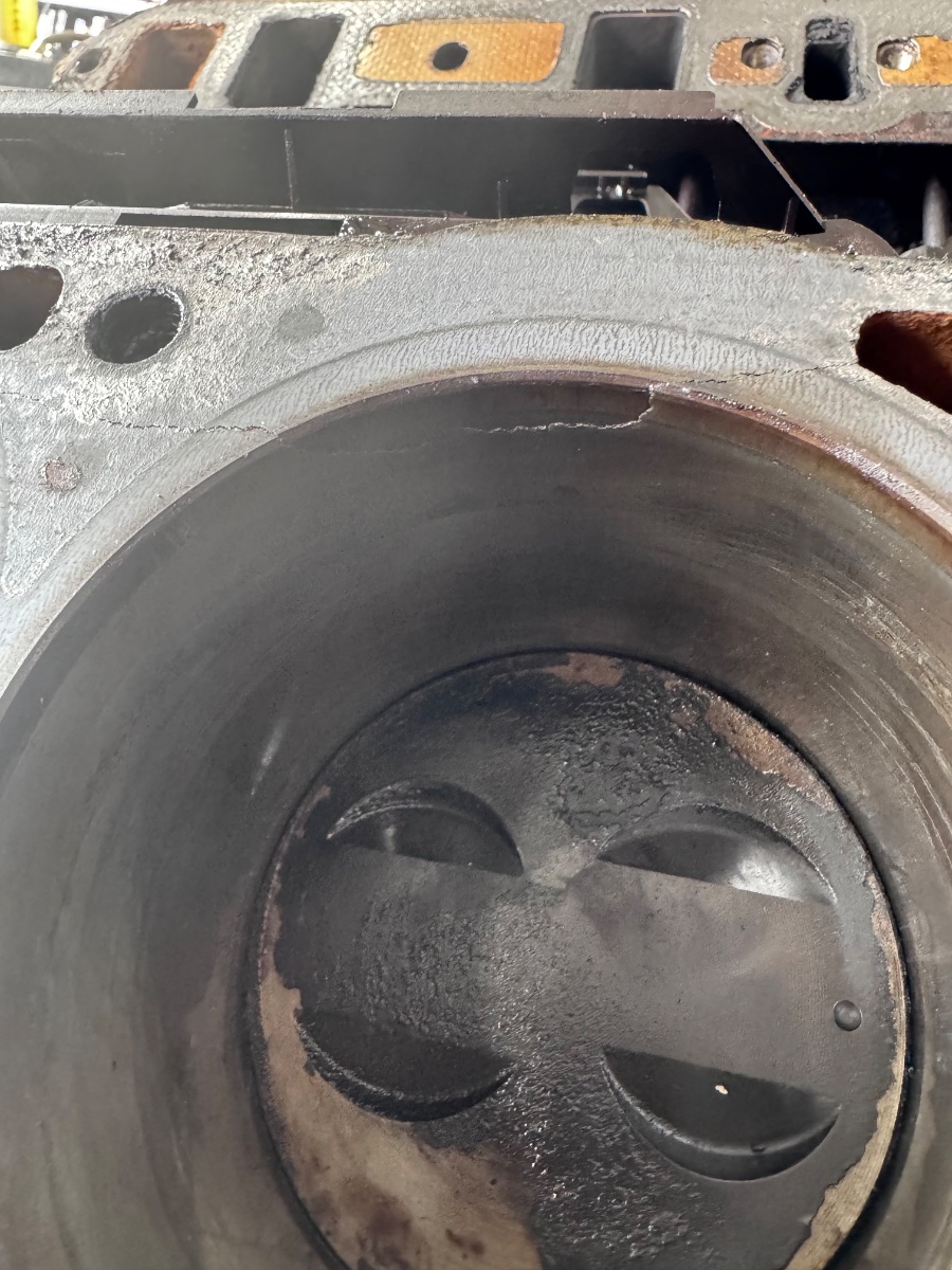

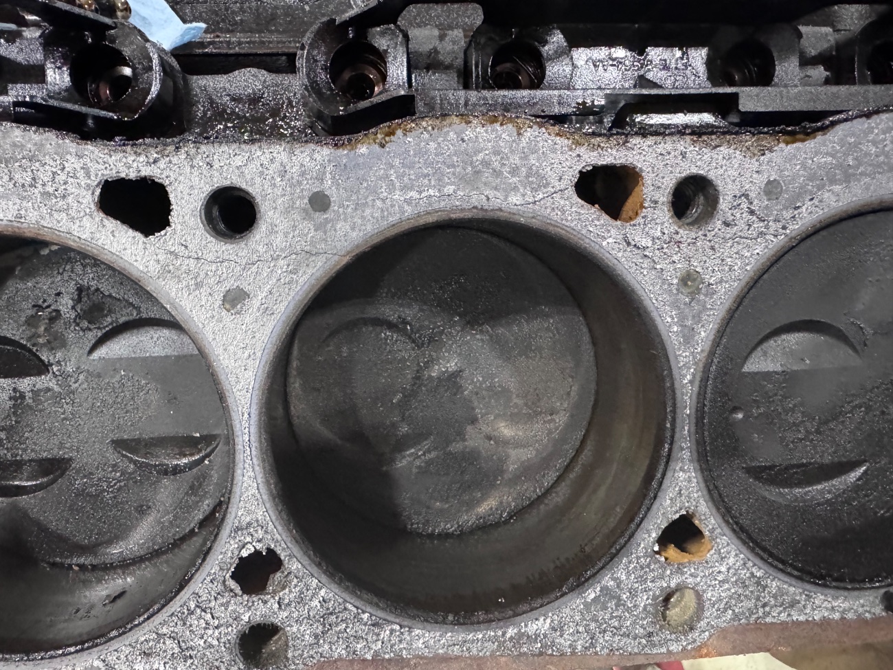

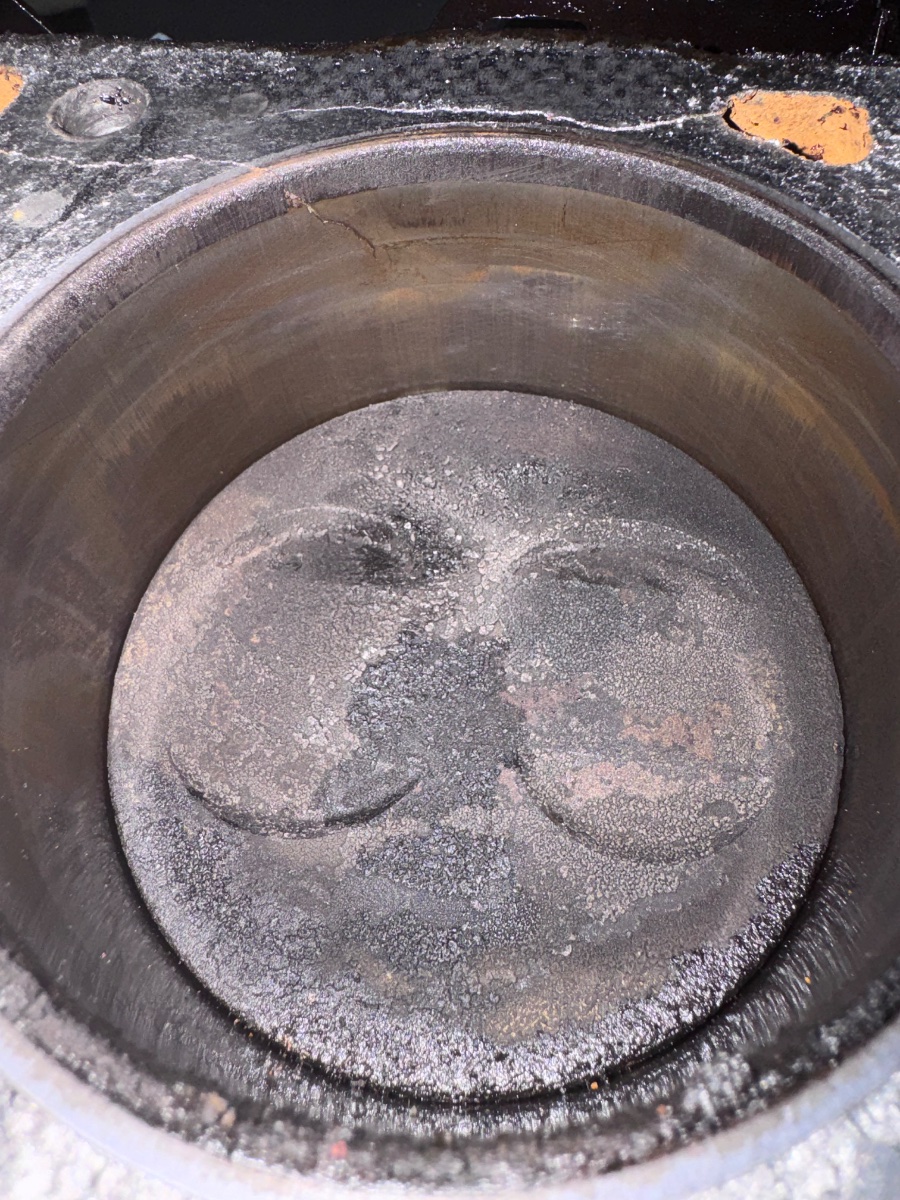

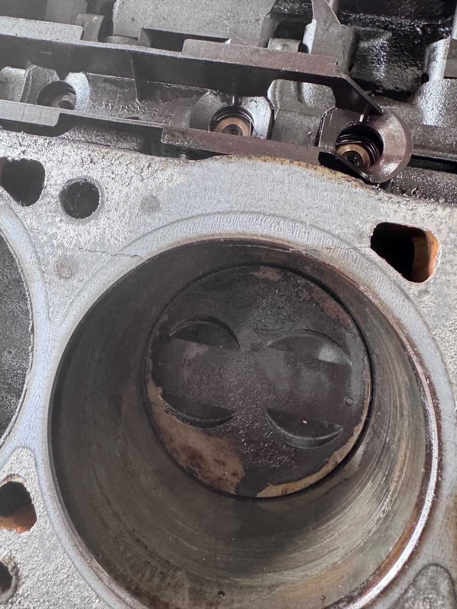

I pulled the cylinder heads. I ended up finding the block is cracked in 2 places. I have no idea how this thing ran. The heads look fine, though I am going to have them cleaned and checked. Looks like I’m now looking an engine block.

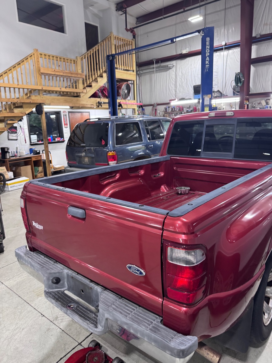

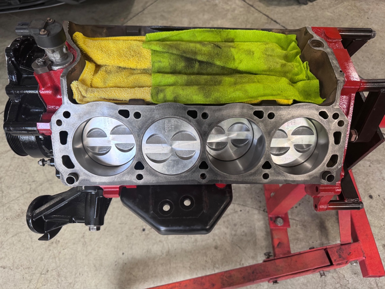

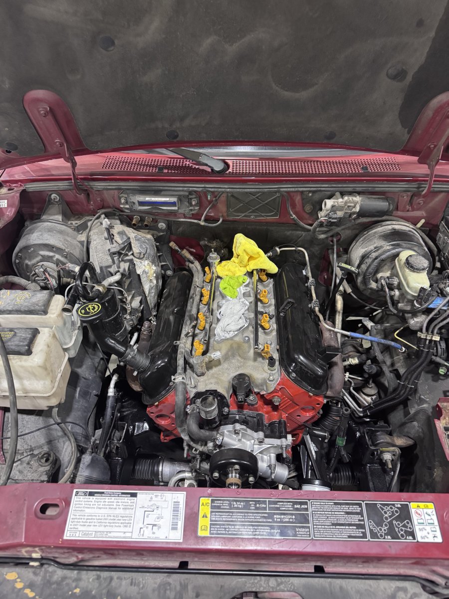

A few things have happened, causing me to slow way down (25th anniversary, kids, other vehicle problems). I have swapped the Mercury rear differential to the Ranger, giving me rear disc brakes and lowering it. I have bought another block, had it bored, and started assembly. Hoping to have the engine ready for install next week. I will post more pics as I get them.
