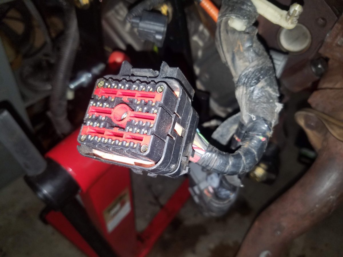

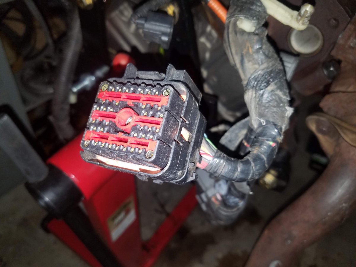

The main wiring harness has a large 42-pin connector right above the intake, and is completely plug-and-play.

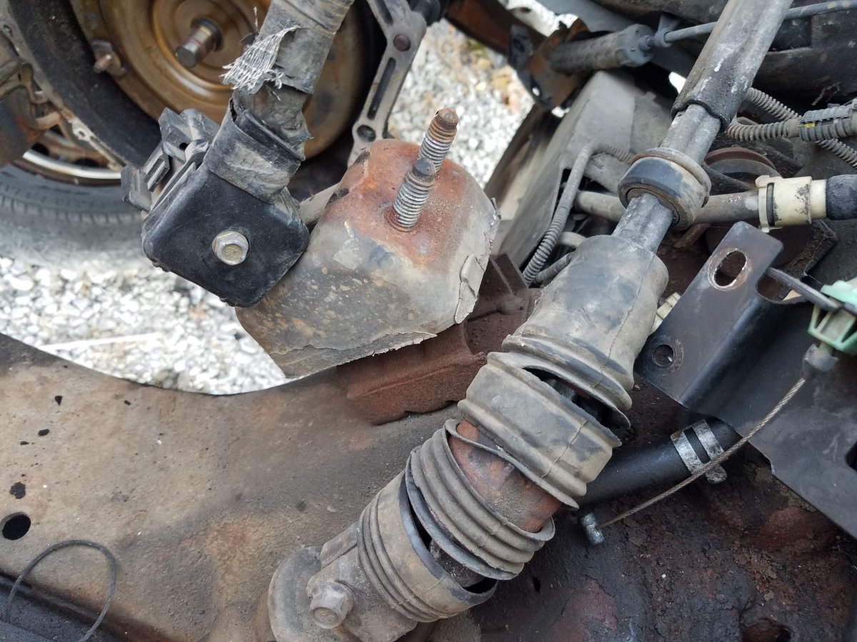

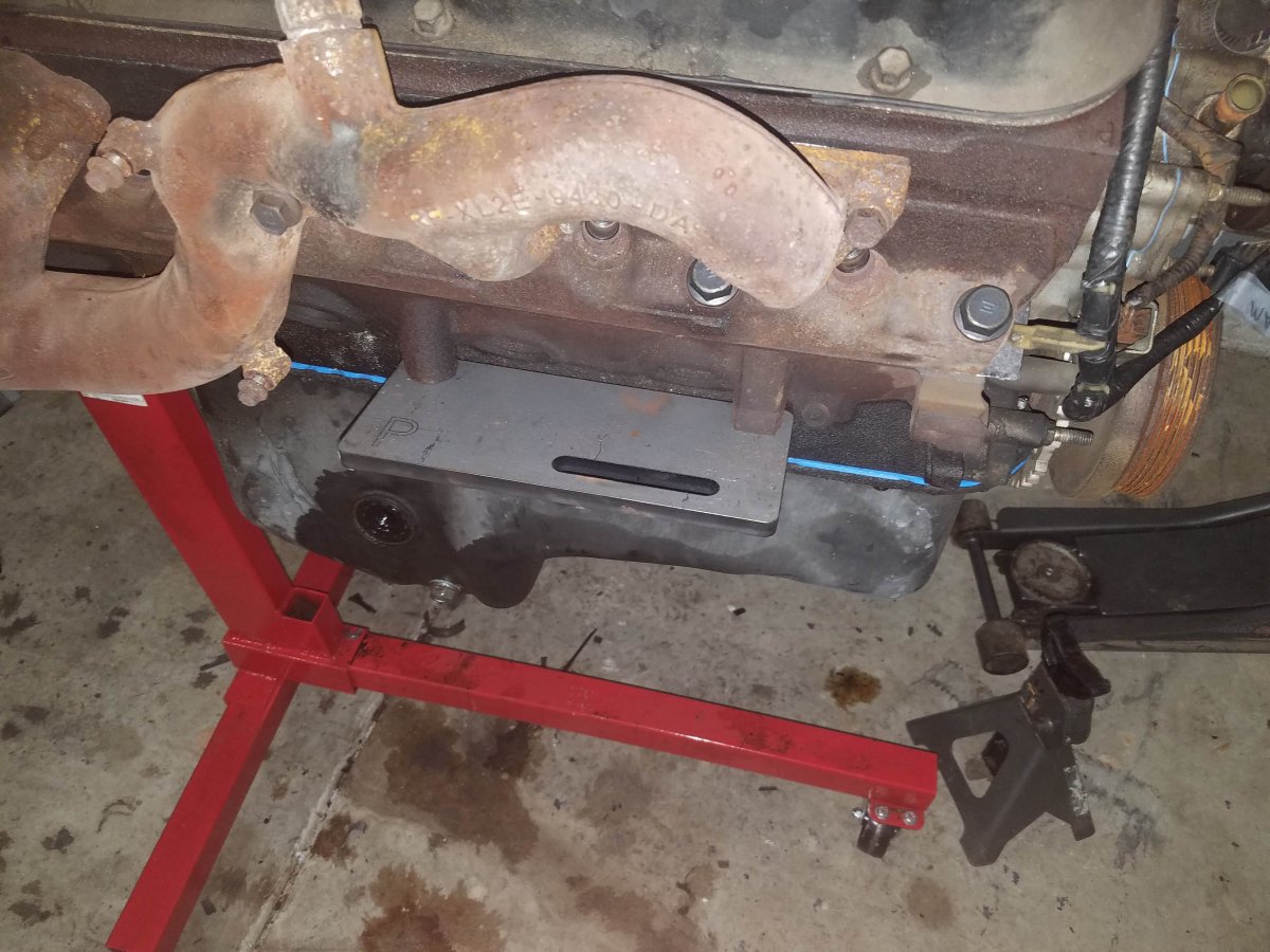

The motor mounts on my 3.0L V6 can be used with RicksRangerz Motor mount adapter plates. Really you just need to make sure the studs on your motor mounts are perfectly inline, and not staggered. https://www.ebay.com/itm/98-11-Ford...882412?hash=item2366b34e6c:g:qIMAAOSwN7BdMOyq
48458

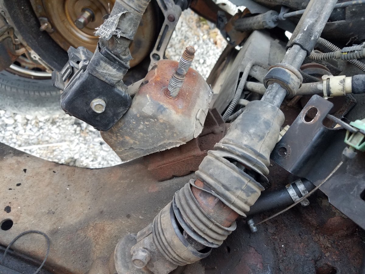

The Drivers' side motor mount for the 3.0L V6 has a spacer block on it, and the drivers' side coil spring needs to be removed in order to remove the spacer block. Then the front crossmember needs the alignment hole drilled out slightly to fit the motor mount into.

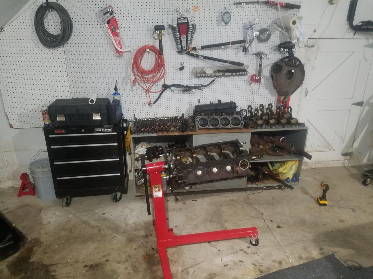

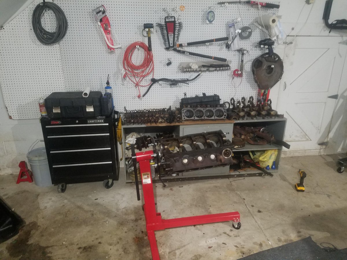

My 5.0 got a near full rebuild, Same piston rings and it was not machined, but all the bearings were changed, all the seals were replaced, and all the gaskets were replaced. When I put it back together, I left off the upper intake, but I installed the wiring harness, just to have it routed properly before installing it.

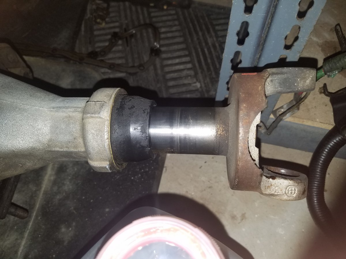

The output shaft on these is 28 splines, and the stock 3.0 ranger's driveshaft spline is 25, so you need to scavenge the slip yoke from the same explorer (which uses the same size u-joint) or from another compatible ford driveshaft that uses the same u-joint (Dana spicer 1330 series in my case)
My driveshaft was 1" shorter than expected, which caused vibrations at highway speeds, I fixed this by adding 1" spacer to the differential flange. I've come to understand that many driveshafts might not be compatible at all depending on your ranger's configuration. Just do some measurements beforehand.

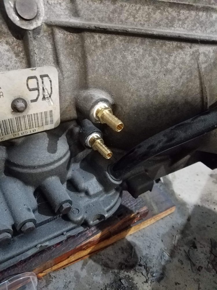

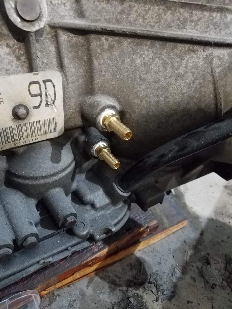

The transmission cooler lines were made by using 1/4" NPT fittings off the transmission into some oil hose, then, I used the old hardlines, cut short, and then the hoses clamped to the hardline.

Now the motor mount problem. I had to completely disassemble my drivers' side front suspension in order to reach the bolt that holds the mount in. This just took a floor jack and some patience to carefully remove the coil spring from the control arm. After removing the mount, I removed the spacer bolted to it, and used a dremel to notch the crossmember and allow the alignment pin to fit. After that I just reassembled the suspension and was ready for the 5.0 to drop in.

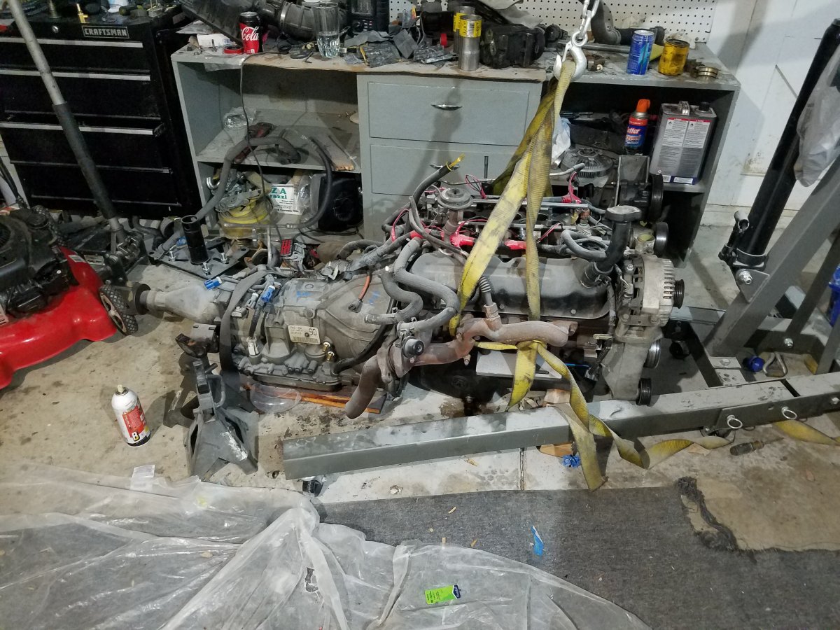

Putting the 5.0 in

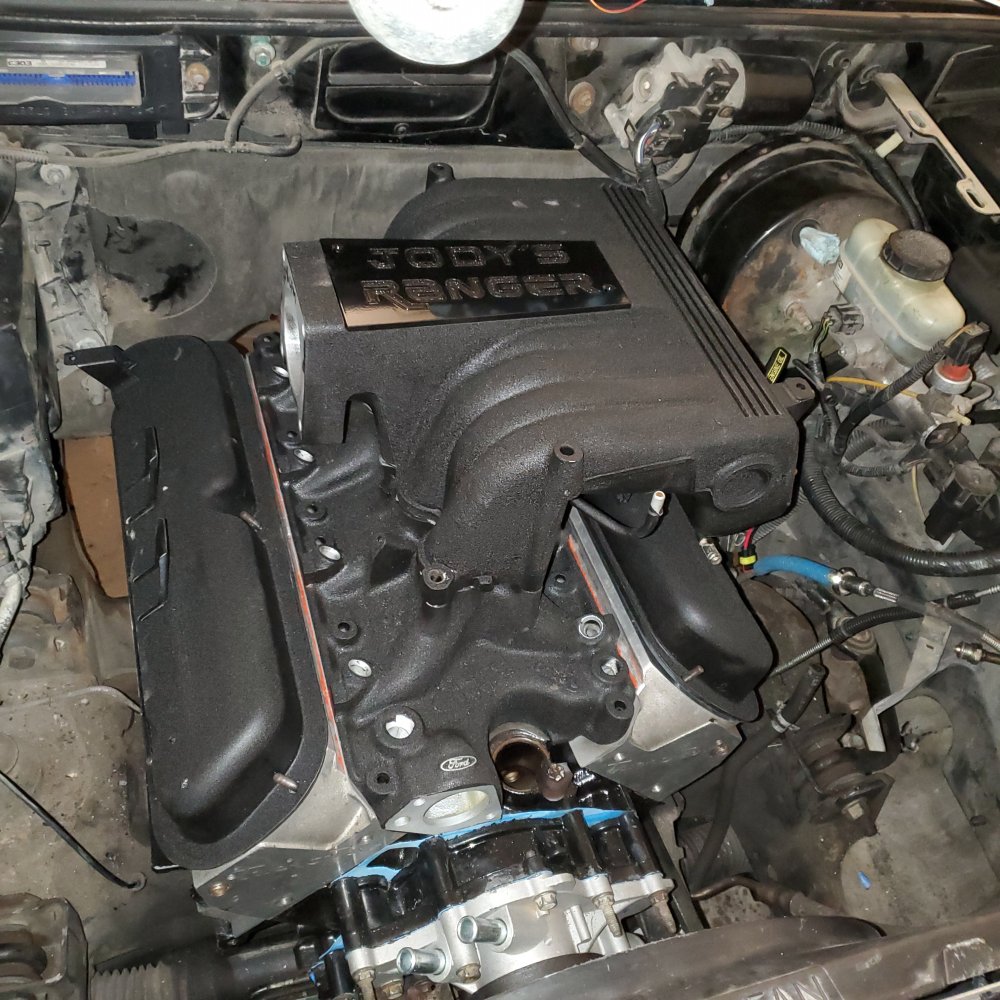

I strapped my 5.0 to the lift and made sure my plates were bolted securely, then lowered the 5.0 into the engine bay. The plates fit perfectly and I bolted it firm but with some give (since the motor mount plates were slotted instead of just having holes in them.) Once it was In it was just a matter of getting the transmission in and mounting it on the crossmember.

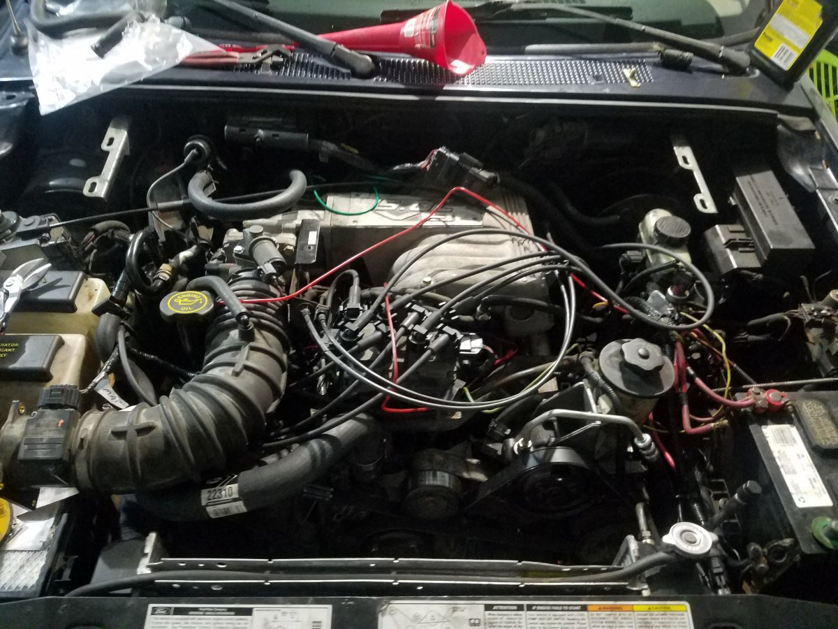

Ran fine for no oxygen sensors, so after hearing it start I just started fabbing the exhaust and getting the rest of the engine dialed together. As for the oxygen sensors, the grey connectors are the upstreams and the Blue connectors are the downstreams. I was able to get a functional exhaust system with some random pipe and a flux core welder from harbor freight, and I filled the engine with coolant, filled the trans with fluid and took only one lap around the block as a test drive... because I was in a hurry... don't do what I did. Make time for this stuff. I spent the next several days having to fix dumb issues because I didn't have enough time, like a vacuum leak, loose fuel rail, and my exhaust welds failed.
This is the result immediately after running it for the first time.
