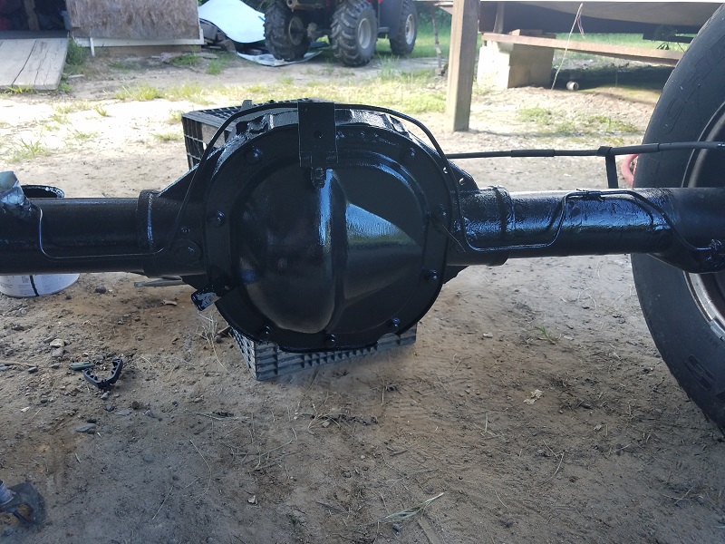

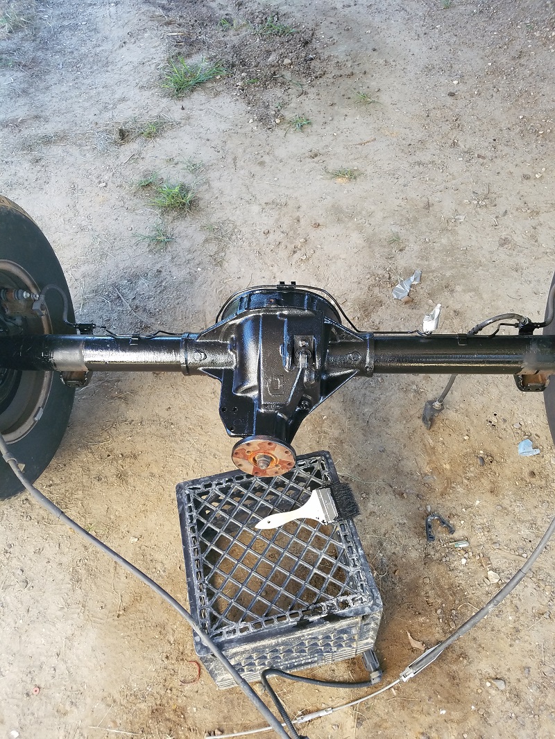

2000 5.0 Explorer Swap Into 98 Ranger 4.0
I need to install this in my ranger. Got it painted up today.
  • 2000 5.0 Explorer Swap Into 98 Ranger 4.0

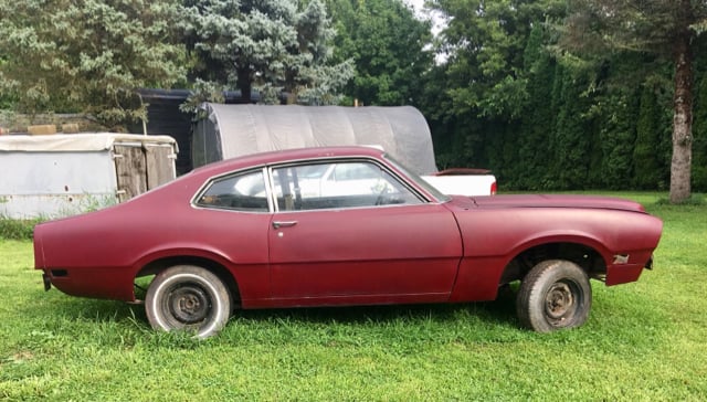

As if I didn’t have my hands full with the V8 Ranger project, I picked up another V8 project......
A 74 Mercury Comet, I know a guy that’s parting out a 94 Mustang GT and I can get the 5.0 & 5spd for a reasonable price. It’s going to make a fun little car![emoji41]

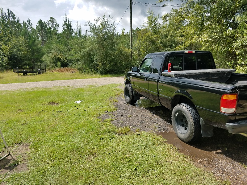

Well I decided to pull the plasti dip off of the old girl today.
