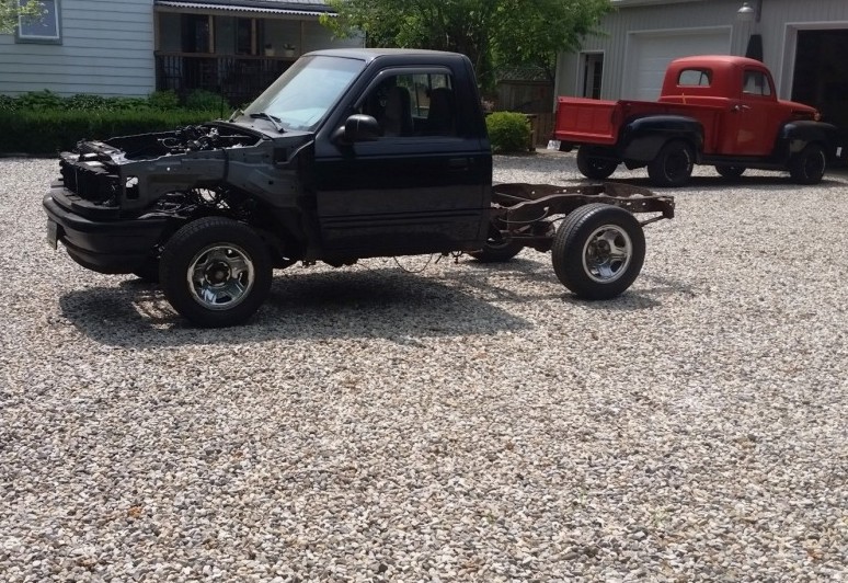

Me and a buddy swapped the explorer rear end into the ranger today. I used the axle swap kit from ruffstuff. Everything went smooth and it only took us around 3 hours to get it done Ranger has more power and NO MORE WOBBLES. I also custom bent an egr tube for my obx headers and got that working. No more check engine light. I'm gonna put a windshield in it and fix a couple small things then put it up for sale or trade.

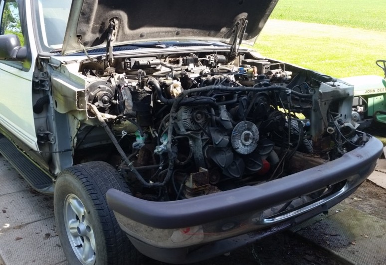

Well I just finished swapping a 2000 ford explorer 5.0 with 54,000 original miles on it into a 98 ford ranger 4.0 automatic 4x4 extended cab. I used a BW4406 manual shift transfer case out of a 03 f150.
