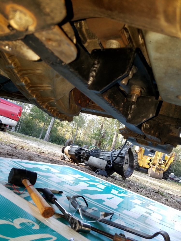

I had a 4wd output shaft installed into the 2wd 4r70w so I could use the bw4406. Transmission guy only charged me 75.00 with parts.
I attached the transmission with transfer case adapter attached and chain the motor with two chains at a hard angle and walked the whole package in. It went in pretty easy. I would lower it and move back a inch or so at a time.
Transfer case install
After the engine/trans were in the first thing I did was install the transfer case to see where my clearance issues were. I found out it hit pretty much everywhere.
So I cut and ground all the casting ears and tabs that were on top even with the case bolts that hold the case together. I got the transfer case adapter and front/rear driveshaft out of a 98 f150.

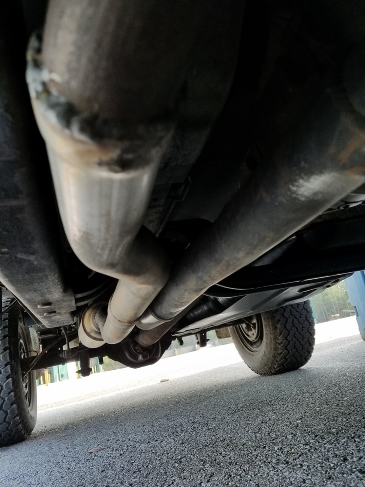

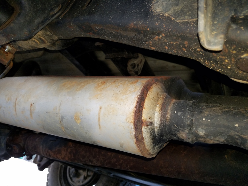

Exhaust from manifolds to the back cats fits perfect. After the last cats you will have to get a custom exhaust put on.

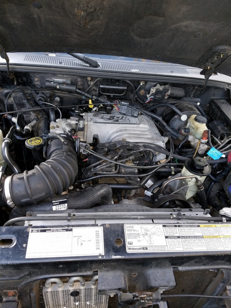

After I finished the drive-train of the truck I tackled the engine. Everything plugged right up. There is only a couple of items to wire up.
