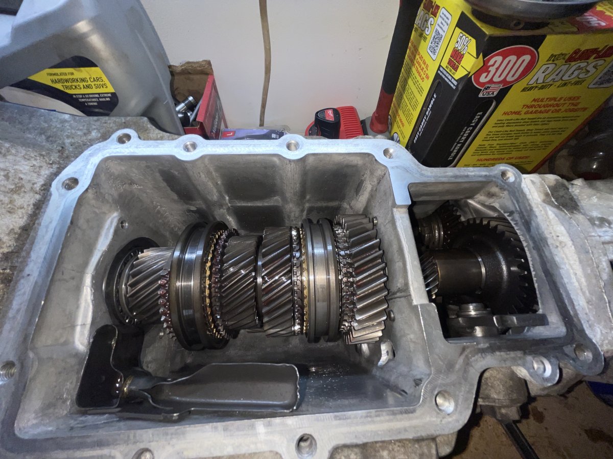

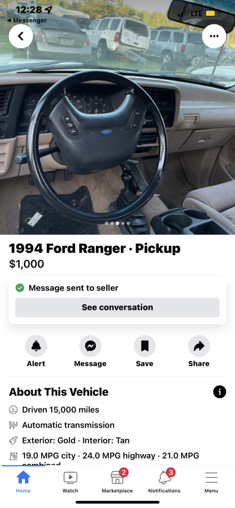

i found a 94 ranger 4.0 auto 4x4, i see the difference now, it has the same interior as my truck but different exterior, and has buckets + center console so i can snag those too, hoping to get it for 4 or 500, also, would a m5r1 from a 95 truck be fine for swap into my 90? it’s the 4.0

For manual transmissions, it’s a good one. Just replace the shift rail plugs before you put the trans in.

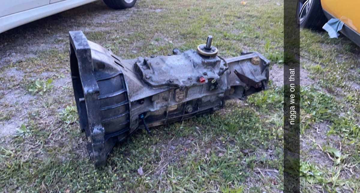

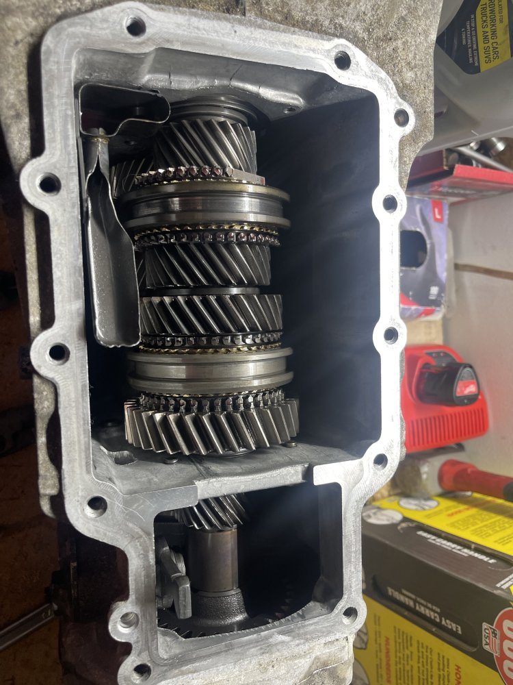

got on recently, i can’t wait to put it in and i’m 100s sure it’s been rebuilt because it has the plugs in the shift rail, rtv in a couple of the hard to find gasket spots and shows no characteristics of a 105,000 miles trans, this was a fricken steal dude. also what does each of the connectors do? there is a red one on one side and another one on the other side that has a connector coming off of it? i’m assuming it’s reverse lights and NSS? which ones which?
