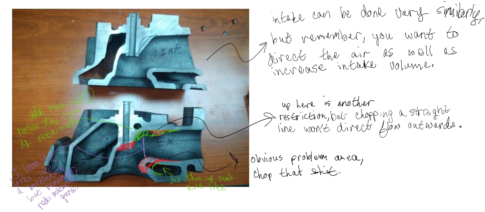

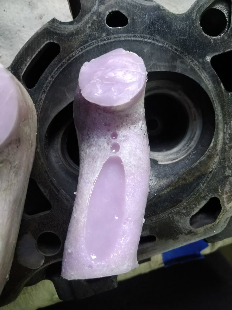

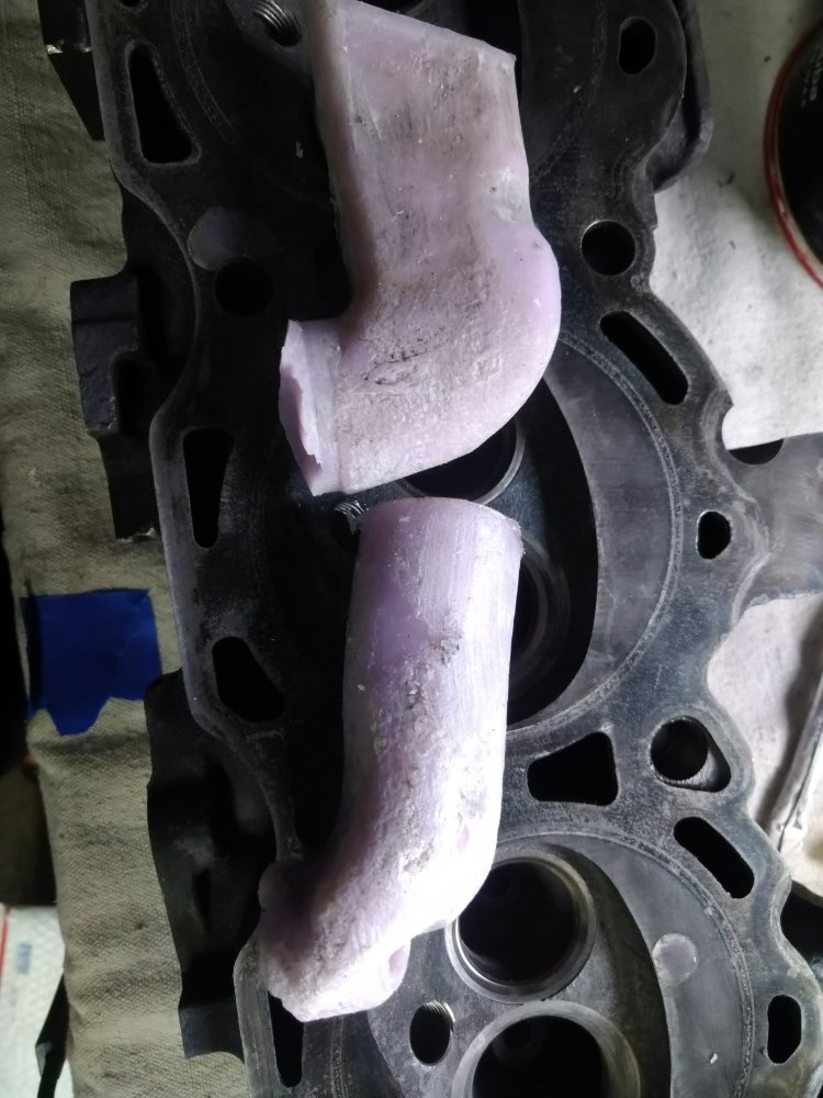

Maybe it only makes sense in my head, I don't know what I'm doing so who knows. Click on the image to get full resolution.
