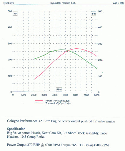

So, as it turns out, it's also because the 3.5 stroker is much higher output than the 4.0...
We should have been building these things years ago....

It's not. In the US with all the 4.0 engines around I don't know why you would want to build a 3.5.
Because there are a few on here (NOT ME!) who believe the 2.9L is a better engine then the 4.0L?!?!? The fantasize that the 2.9l is the greatest engine ever made.
