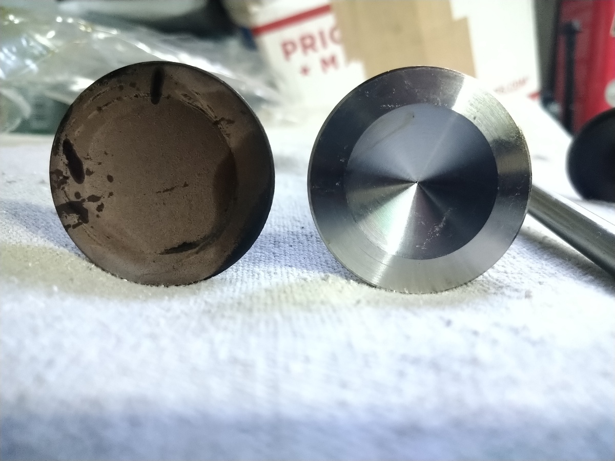

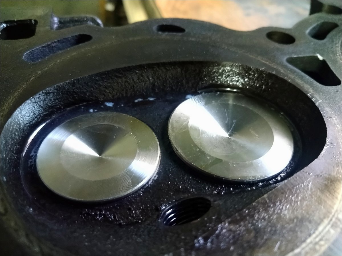

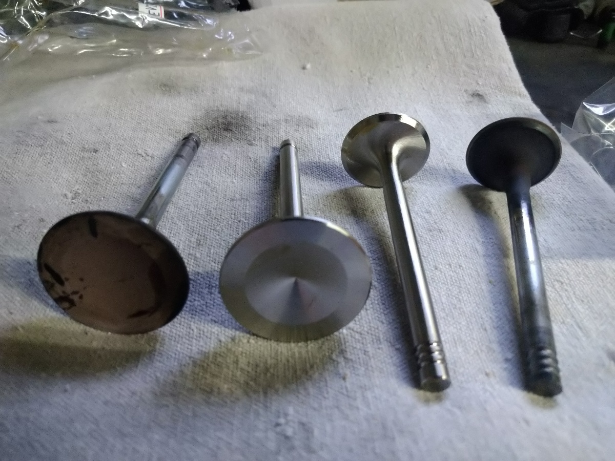

Valves are already purchased, SI Portflow Valves

Nice valves..already undercut to boot.

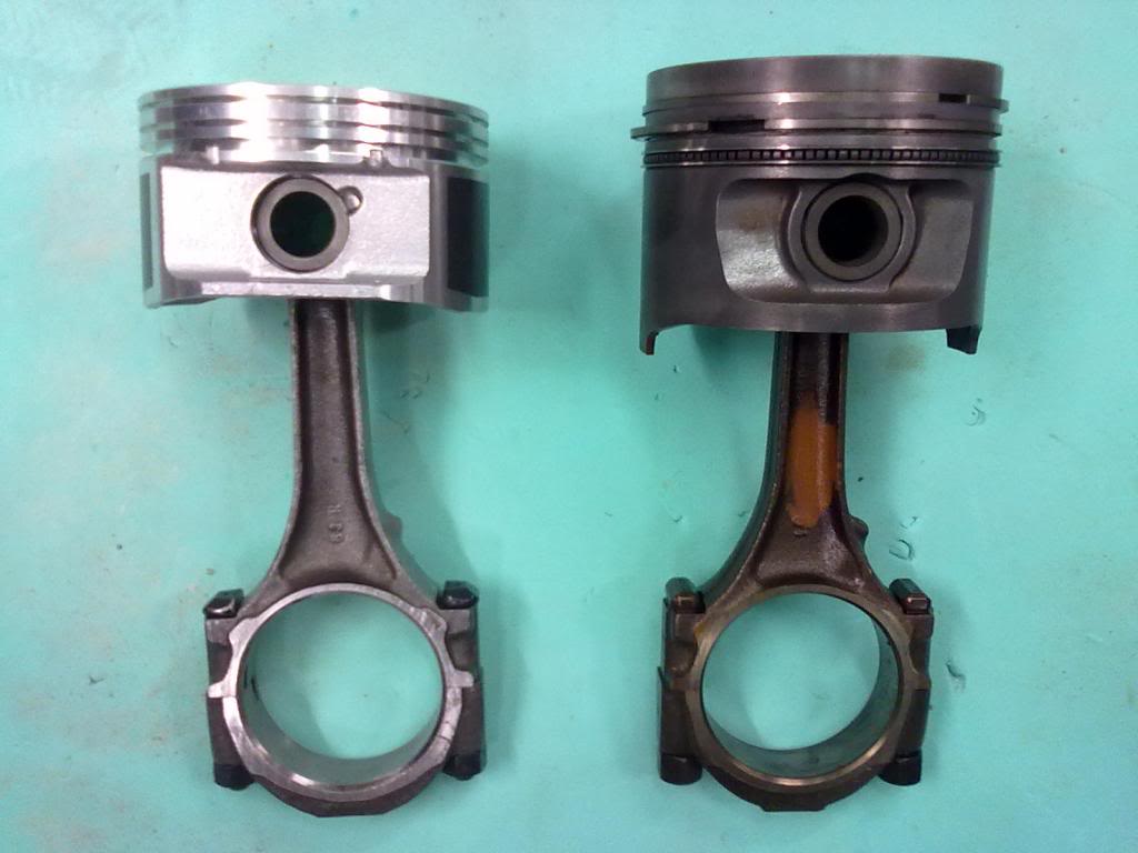

Interesting. I had considered the Chrysler piston because if similar bore. Can't remember their comp. height atm. I think they need to be shaved, correct?
Trying something new with my build. Using 5.8 Trinity pistons and looks like a 302 rod.
Tracked down a set of the forged trinity pistons on ebay, motor threw a rod at 2k mi. With same bore as 2.9 when over bored to 93.5mm, they're drop in dish tops for bore. Compression height is 1.222, so need to figure out rod length. I think ford 302 is correct, but want to see when they get here.
Have scoured for a drop in combo, but couldn't find pistons anywhere that would ship to the USA. Was working with machine shops on alibaba to get a run made before I rolled the dice on this.
Chrysler/Dodge/Jeep same piston, 1.252" compression height and I had to remove 0.032-0.035" off the block deck height to have the pistons flush with top of the bore. Isn't the 302 rods 0.050" shorter than the 2.8 rods?
The Jeep pistons I used wouldn't be any good for a boosted engine, compression would be too high and they have a weak top land.
A friend over here on his 2.9/3.5 used custom pistons with modified Ford 5.4" rods.
5.4 on 2.9 crank?
