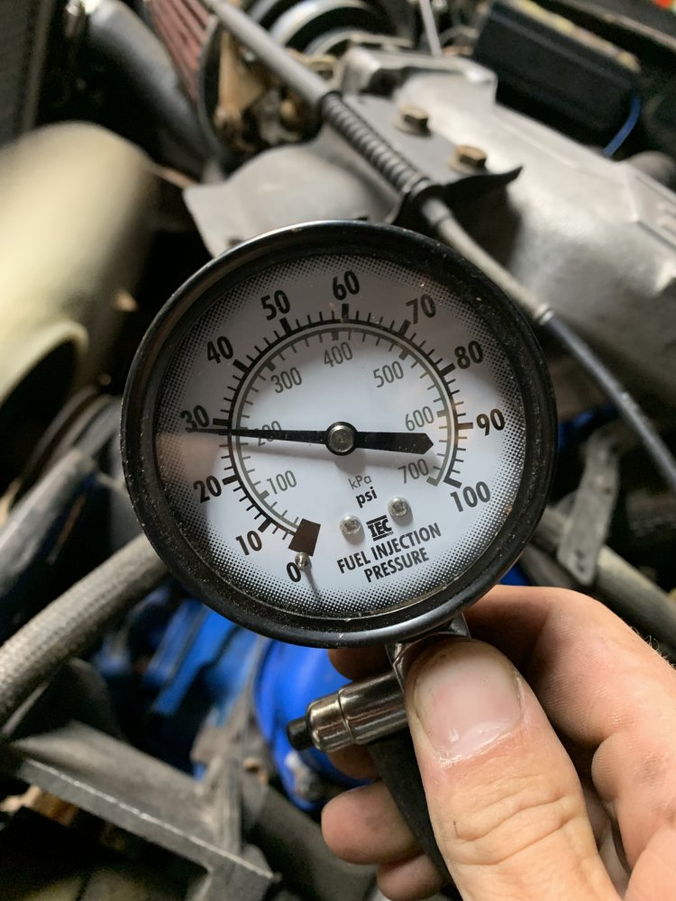

I haven’t tested the fuel pressure when the engine is running but I did hook up the gauge and primed the pump a few times last week. I got roughly 40psi which is good. The truck does rev up when I start it, it always rev’d higher than it should, 2500+ for a second but it’s been like that for years. I’ll test the fuel pump while it’s running and get back to you
What was fuel pressure to start with?
Should be 15-20psi engine off after a few MONTHS
So if its dropping to 0psi after a few minutes or hours then you would only have 10psi with 1 key on, so engine would stumble on startup after REVing
Ok so KOER pressure is roughly 29-30 psi which is below spec….hmm. I’m going to leave the gauge hooked up over night and see how far the PSI drops in the morning
  • 2.9 intermittent spark and stalling
Initially when I hooked up the gauge and primed the system I got 10psi BUT the gauge had to purge the air, after a few more cycles of the key I was at 40psi. So I’ll let it sit over night and try priming it again in the morning. I am noticing now watching the gauge with the engine off after it ran that it has crept up to 45 PSI and it sitting there.
Checked the gauge this morning at it was at 0, primed the truck for 3 seconds and it was back at 35psi. Hm wonder if I just need a fuel pump.
