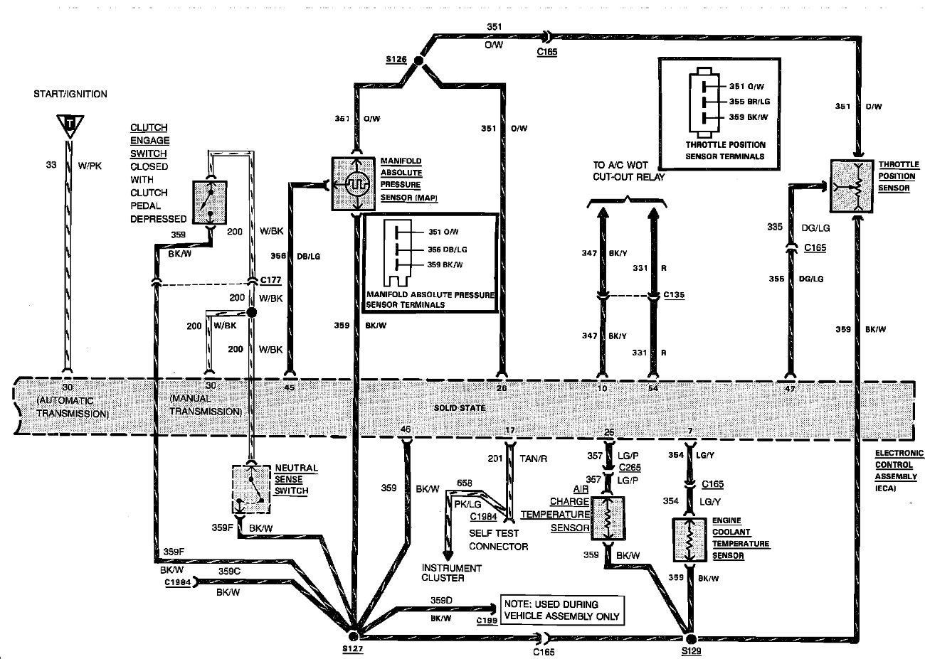

Now that I figured out that my wiring to the 02 sensor is good and it has nothing to do with pin 46 getting fried on my eec. The only thing I can see is that 12v from the ignition switch is making it's way ether from the neutral sense switch or the clutch engage switch.
The map, act, ect, and tps all run on 5v.
Can someone correct me if I'm wrong and tell me how to check to see if I'm getting any back feed.
Looking at the diagram more carefully, pin 46 is not a "ground" at all. That may be a term you would commonly use, but according to the diagram it is a "common" or "return" for the 5v. This is interesting, I don't know if you can take a meter and go from the 5v supply to any ground and get 5v, but looking at the diagram, I am thinking you can't. Unless pin 46 is tied to ground inside the computer.
This would be something to check with a meter. Is pin 46 tied to the real ground inside the computer? If it is, this could be a problem if in all your black/white wiring, that the wiring was tied to ground somewhere. That would give other components the opportunity to use pin 46 as a ground when they shouldn't.
Your next step might be to unplug the computer plug, and take a ohm reading from the black/white common 5v wiring to chassis ground. According to the diagram, it should not be connected. If it is, you will have to find out where. If you find it, this may make your problem go away. That connector "C1984" in the diagram is the EEC test connector ground. So it's just a place to test things, and it would be a good place to check and see if the black/white is tied to chassis ground somewhere.
