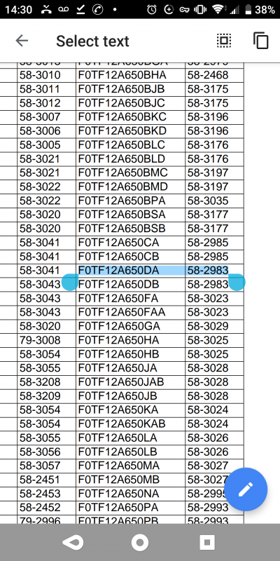

Photo of ECM I was sent.
Which translates to...
So the seller is insisting that I have a 2.9 MAF computer. Homework is showing that it's for a 4.9 or 7.3... No idea at this point.
