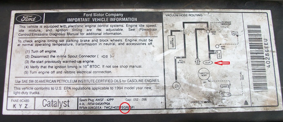

They also keep asking if it has an EGR valve.
On the older Rangers like I have, the vacuum diagram and emissions sticker on the radiator support shows the EGR if it's equipped. Maybe your 2000 has a similar sticker?
Beyond that, sorry but I don't know any particulars of the Fed versus Cali differences.
Welcome to TRS.

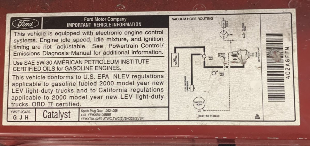

Thanks for the great info. My sticker confirms what my shop manual has been saying. I don’t have an EGR.
I just need to confirm the cam is the same and maybe I’ll pull the trigger in a federal emissions engine. My gut is telling me the cams are the same but when it comes to spending my money poof is nice.
