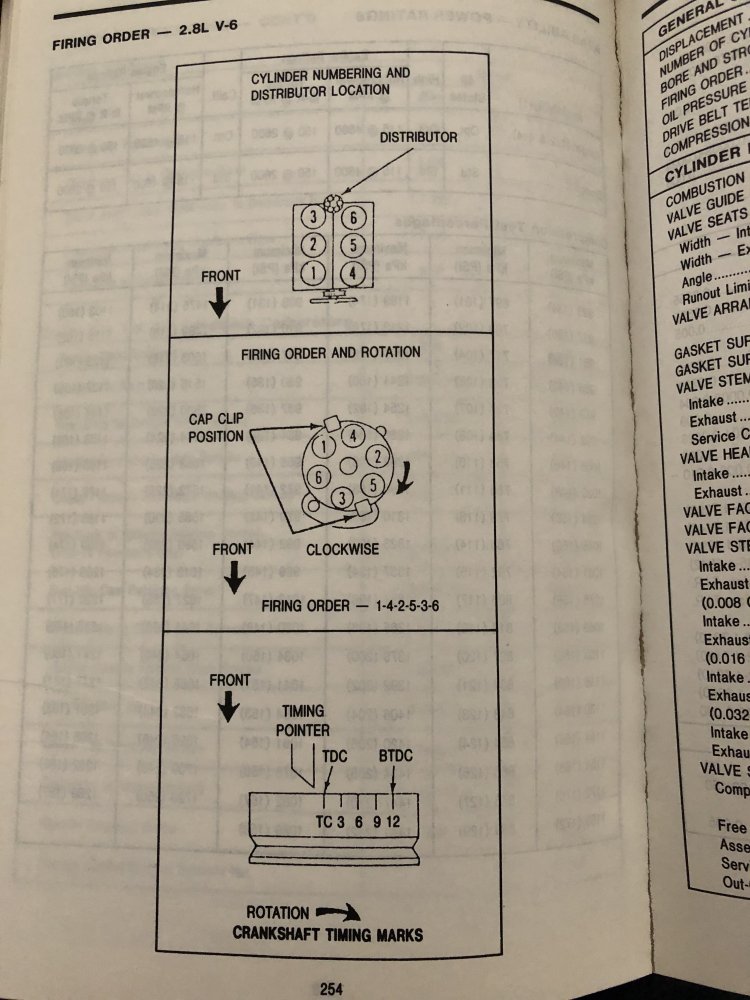

Facing the engine, you are turning your wrench in a clockwise direction, right?
You’ll just be rotating it a small amount until the scale and the pointer go from 20 to 0. Look at where the rotor is pointing, if it’s at the number 1 post on the cap, you’re on the compression stroke—if it’s pointing 180° from it, you’re on the exhaust stroke.
Keep in mind, the entire point of this is to get the new distributor installed so the pointer is pointing in roughly the same direction as the old distributor (when it was removed). Nothing special happens when the engine is at TDC.
As franklin2 pointed out, the crankshaft turns twice for every single camshaft rotation. So you actually have two TDCs: one on the compression stroke (both valves closed, air / fuel mix in the chamber being compressed, spark plug about to fire); and then a second one on the exhaust stroke (exhaust valve open, exhaust exiting the chamber). Think "four stroke": intake stroke, compression stroke, (ignites here), power stroke, exhaust stroke.
If your distributor is still undisturbed, if the crank is at the 0 mark, and if the rotor button is at the distributor cap #1 spark plug wire, you should be good. Confirming compression stroke by pressure in the #1 cylinder spark plug hole simply takes the guesswork out it.
You probably already know all of this, but just in case...
