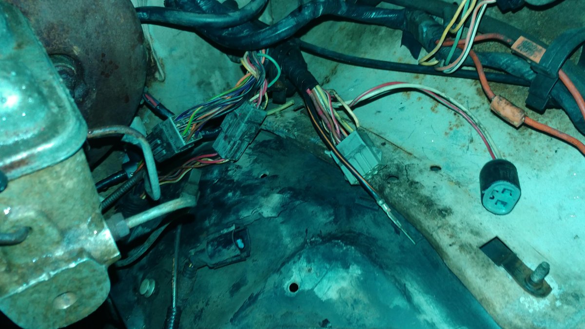

Why is that large grey plug laying there empty? You need all those wires. They go to the alternator and your sending units, everything you need on top of the engine.
To run the GM ignition, you need the white looking wire on the round plug, and a red/green on the square plug.

I basicly just unplugged everything from this side to be able to bring the harness out. That cable that looks like its just bare metal was the one that was fused/melted together. It broke like that when I was trying to unplug it. The alternator cables are stll hooked up to the alternator.
Which is all wired into the harness. I havent started to mess with the harness (Cutting stuff. Ive left it like it was when it was hooked up.)

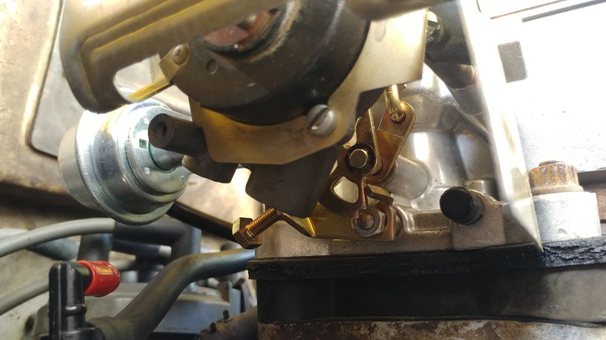

See that brass fitting sticking down in the picture below? That is the hot air fitting for the hot air choke on that carb. I don't know how that choke is working without it hooked up, it's probably not working very well. That is definitely different than the stock carb, hopefully your new carb has a full electric choke. If it doesn't or you need to still use the carb below we can help you rig it up to work.

Yeah but I converted it to the hot amiant temp thermostat. So It has no need for wires to be hooked up to it. Ill shoot a photo of it now. The feedback carb had the choke system I put on the new carb.

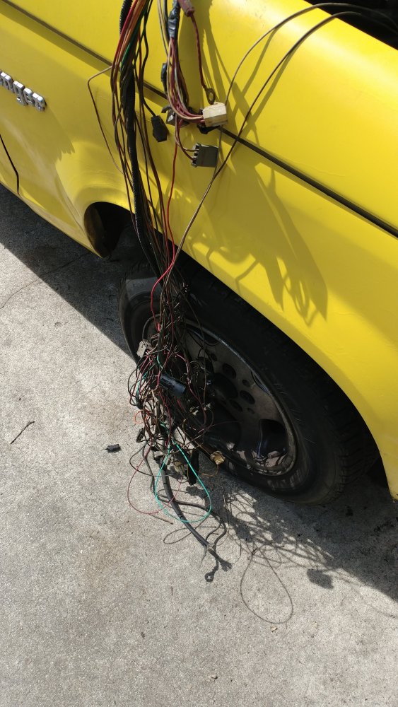

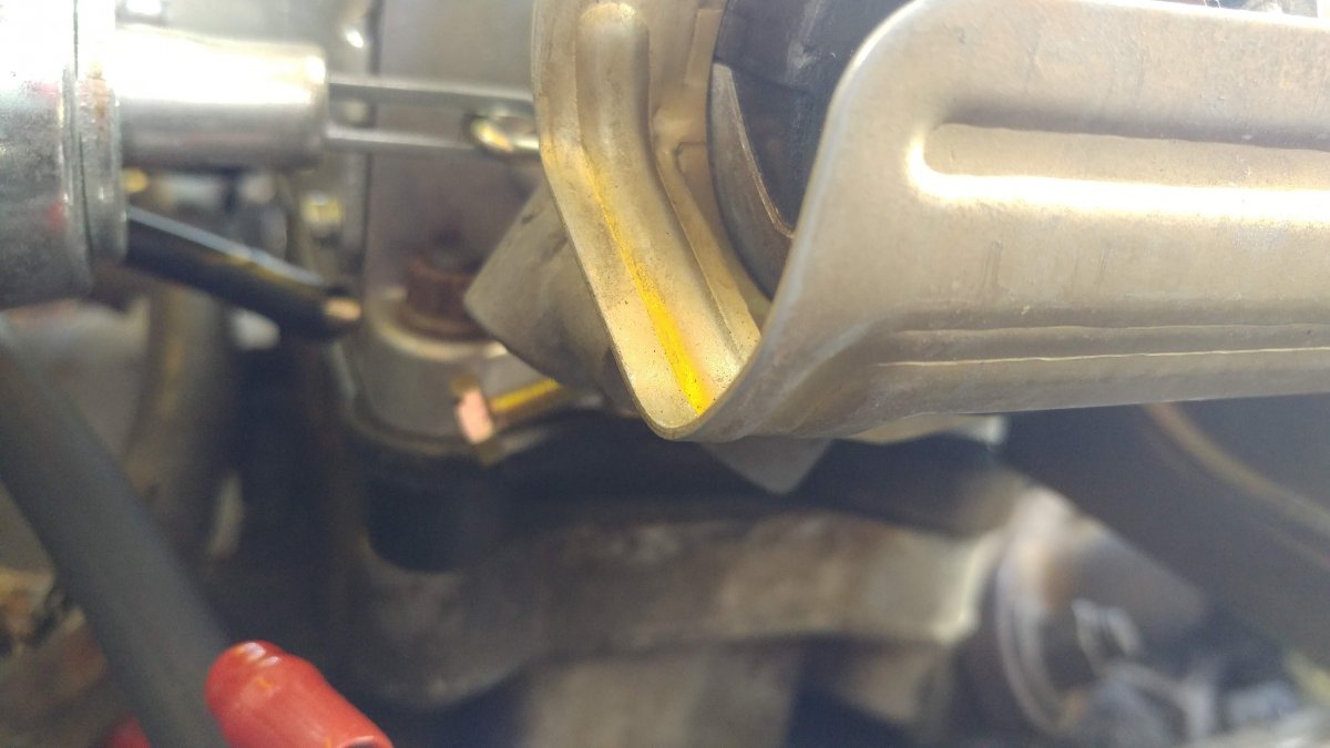

These are photos of the harness while its laying over the fender and what the choke system looks like.
Choke: The choke doesn't have any vacuum ports or any of of holes. The thermostat gets warm/hot off ambient temp from the motor. Its never given me any issues after I fine tuned it.The two ports on the back are sealed.
Harness:
I see you swapped in the black choke cap from the old carb, but it's not even hooked up. I can't explain how it works when it's not even hooked up. That large silver can to the rear of the choke. Did you hook it up with a vacuum line?

Yeah, the choke works perfectly. Its got a thermostatic spring inside it and the head thats generated from the engine comes up off the engine and warms the spring up. My uncle told me that was the original type of choke. The one that just heats up off the engine and cools down as the underhood temp lowers.

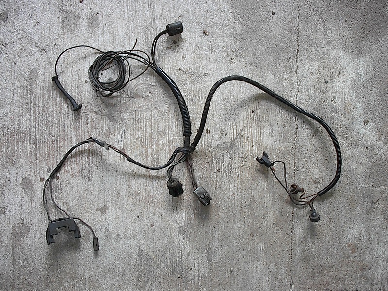

OK, cool. When you get your parts, we'll want see the wiring diagram for the HEI, and again, we'll be modifying this harness, which was originally plugged into the gray 8-pin connector (and the black 2-pin connector) on the driver's side rear corner:

What we'll need will be the truck's original harness, that used to be plugged into these connectors of yours:
40359
That harness, which will look like the one I posted in post #69 (except as you say, the coil connector), is where you will be doing your wiring connections, so that the modified harness will then plug in between the truck and your new ignition components. Additionally, there are a couple of wires in that harness which need to be kept as-is (alternator field, alternator stator, oil sensor and temp sensor).
