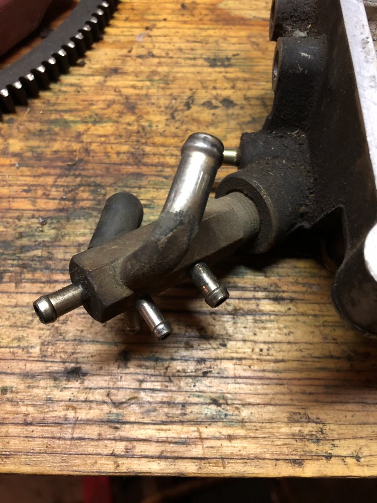

You are looking for the "tree" shown below, which screws into the manifold behind and below the carb.
Follow @AndyB. 's advice, and remove the hoses and cap the open tubes on the tree. In this picture, pointing toward the camera is an open tube, left, and a capped tube to the right of it. Caps would be best, but for temporary testing you can wrap electrical tape around the tree to close the tubes. An open tube is a vacuum leak.
I capped them off, or tried to cap them off. I started the truck up and no change. Not that I was thinking there would be. The caps I had were either too small or too bit to fit over them.
One open 1/8” port will pull enough air to cause the engine to stall at idle. You can get a variety pack of caps at an auto parts store in the help aisle for a few bucks.
As suggested earlier, try some electric tape to cap them as a diagnostic step.

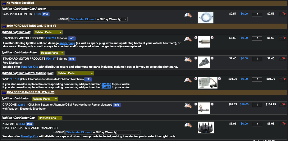

Rock auto list for the mod.

I also posted the list of the parts I found on rockauto for the duraspark mod. So if im missing anything yall can chime in.

I didn't buy the distributor from Rockauto. They did not have the best price believe or not. I think I got mine from Oreilly's. I just did a google search and put in cardone 302691 and O reillys has it for $74.99 and a $5 core charge. So that is $80 versus $104 at rockauto plus shipping.
You did say you wanted to do this cheap, money is tight correct? I am a total cheapskate.
Cheap way to do it;
Distributor from OReillys for $80
Cap adapter from rockauto for $2.57
Rotor rockauto for $2.40
Cap rockauto $5.05
GM HEI ignition module rockauto $13.17
If you use the GM HEI module, you do not need the duraspark II module and you can keep using your original square coil. If you want to look up the module, just plug in a 1979 chevy monte carlo with a 305 v8.

Thanks! Did you have to order the distributor at ORilies? Im sure they dont carry it in stores.
Also, Whats with people using the GM HEI module? Ive seen ane heard people say to use it with a heatsink and some dont use it with a heatsink. Ive also heard the Ford modules are CRAP. Like a friend on youtube went through like 4 of the ford until he switched to the GM and another guy on YouTube said he had issues with the GM not working right.

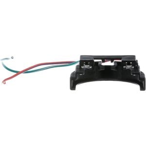

Here's the coil connector. Autozone has it for $6.99. Part number 252. It has to be ordered. Yes the distributor will have to be ordered also. I have found almost nothing for a 2.8 in any local store, it all has to be ordered. You are a pretty weird person to still be running a 2.8 Ford v6. I will re-word that. You are a "special" person to be still running a 2.8 cologne v6.
