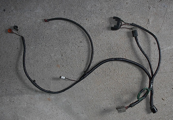

I am really torn right now which ignition system to recommend. I was going to recommend you stick with the Ford duraspark II system, because it will plug right in to the plugs sitting over there on the driver's side inner fender. But I just realized something I have forgot; You will need the short harness that goes between the distributor and the Ford module. Do you have any junkyards local that keep any old stuff around? That is the best place to get this short harness. If you had this short harness, it all would just plug in, no wiring fabrication at all.
If you can't find this harness, then you might as well use the GM and make your own wiring. It does require some fabrication.
This is the short harness I made for mine (Ford ignition module). I'm trying to remember if I had to come up with any extra Ford plugs that weren't originally on the truck. I did use the pigtail connector (as mentioned in a previous post) for the round can coil that I originally ran.
Mines an '84, too, and this was done 10 years ago (so that's why it's a little hazy to me now). I'm pretty sure I could reconstruct how I did it, and write up a step-by-step.

To get the short harness from the module to the distributor, it doesn't have to be a ranger. It can be any Ford/Lincoln/Mercury car or truck, from the late 70's to the mid 80's, any engine size that had the duraspark II system in it, which is what most of them had.
Painless wiring sells this harness, but I think it's like $80 for it.
