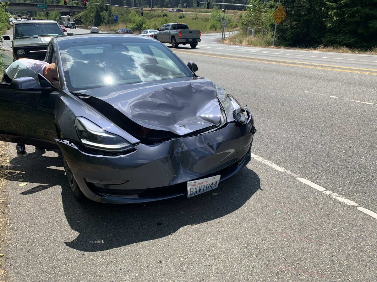

So, last weekend (July 3rd) I totaled my truck by landing, yes you read that right, on the hood of a Tesla. I’ll share photos below… still waiting on dash cam footage from the Tesla owner.
How it happened is I lost my brakes at 70mph exiting an interstate. I decided to hit the ditch on the side of the road, jumped the truck and landed on a brand new Tesla… thank God for full coverage, eh?!

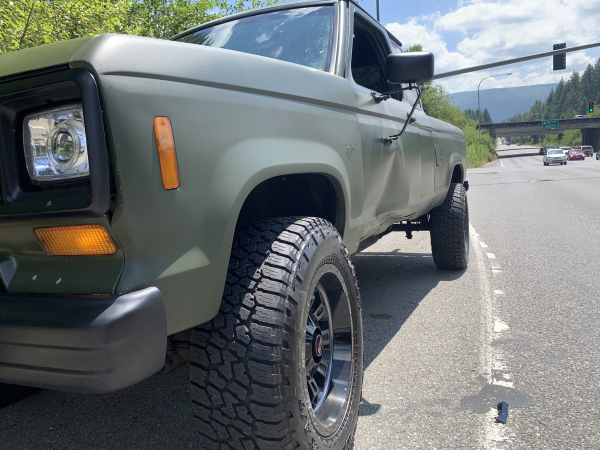

pics of wreckage
  • 2.3L to 2.9L Swap
  • 2.3L to 2.9L Swap

Damage doesn't really look THAT bad? Straighten out the floor and rocker panel and throw a different door on it.

the problem is my frame is twisted from the impact. If it was just body damage, I’d be game to fix it.
