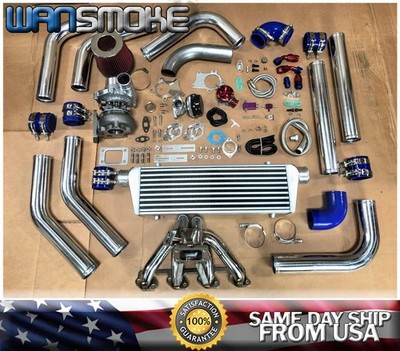

anything you do for the low hanging fruit is a waste of time and money. cams port and polish intake ect... it is the most amount of dollars for least amount of power.
simply put....just put a turbo on it with a size up injector and live with 4-5 pounds of boost.
Yeah, that, would be the most bang for the buck... not recommended to exceed that boost level though on the stock cast pistons...
