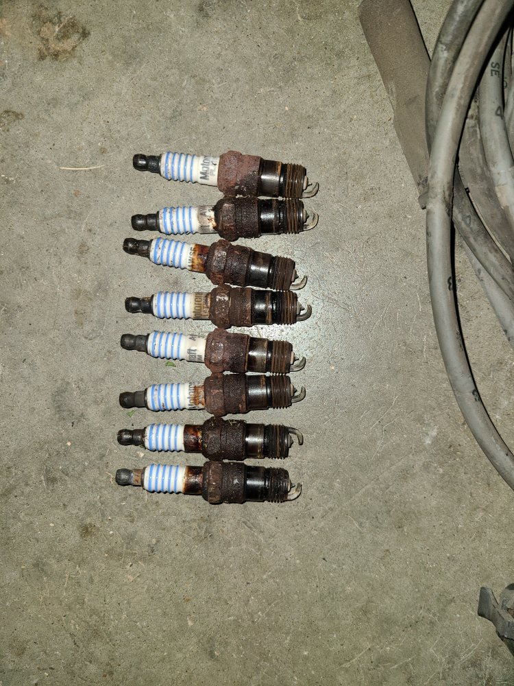

Just recently picked up a '97. Finished swapping plugs n wires today, and it's stunning how perfectly it starts/runs. It was running decent when I got it, but figured it needed a tune up just n case. Old plugs were rough, but all came right out without issue

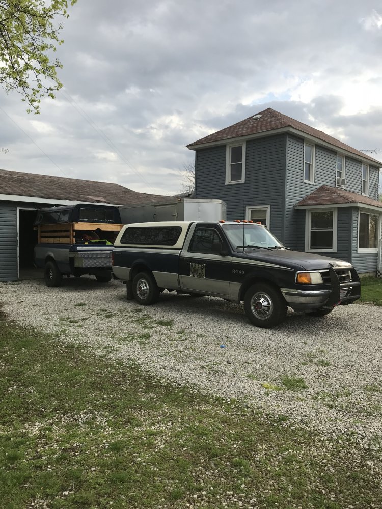

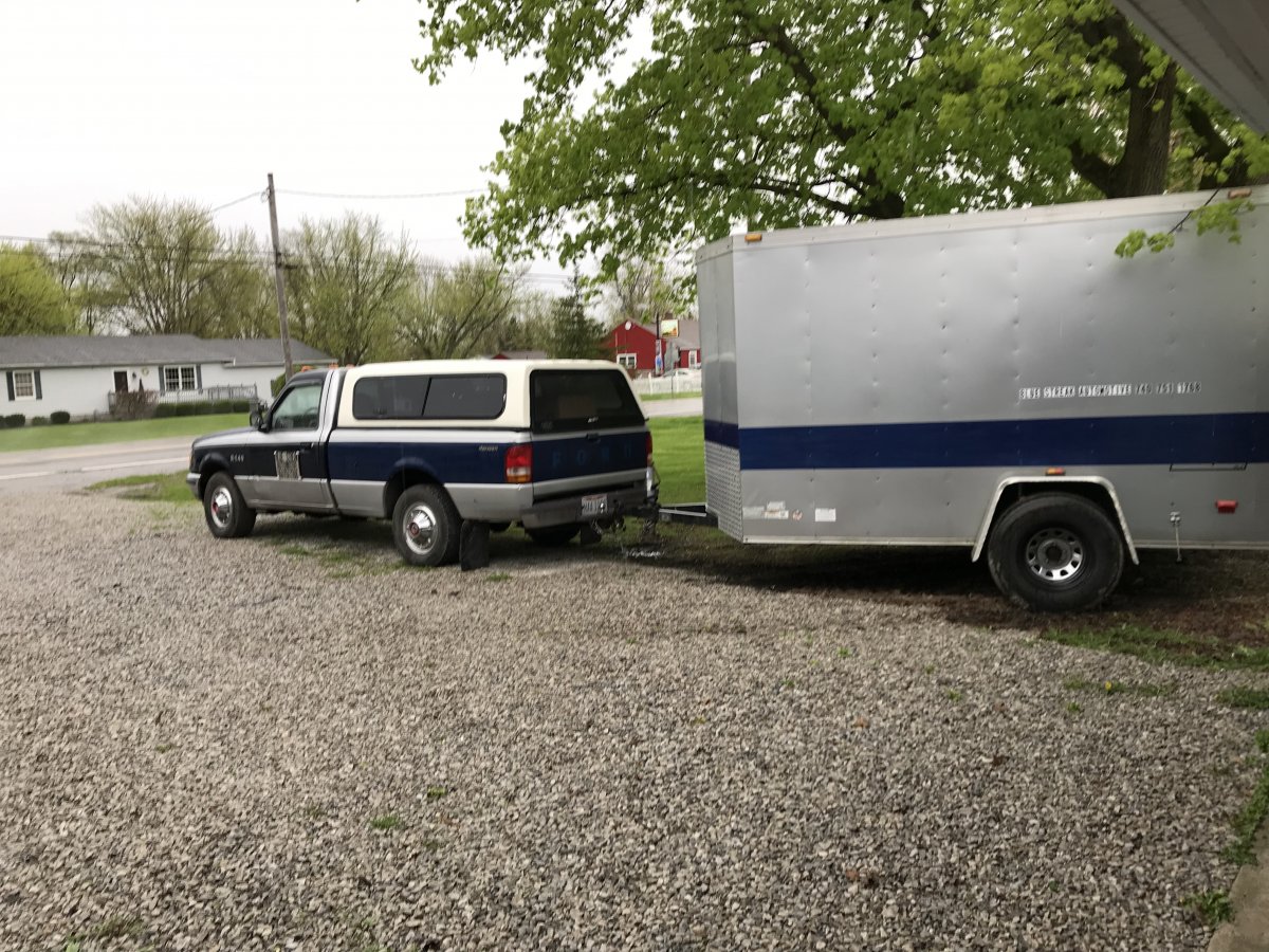

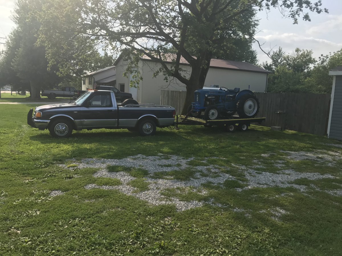

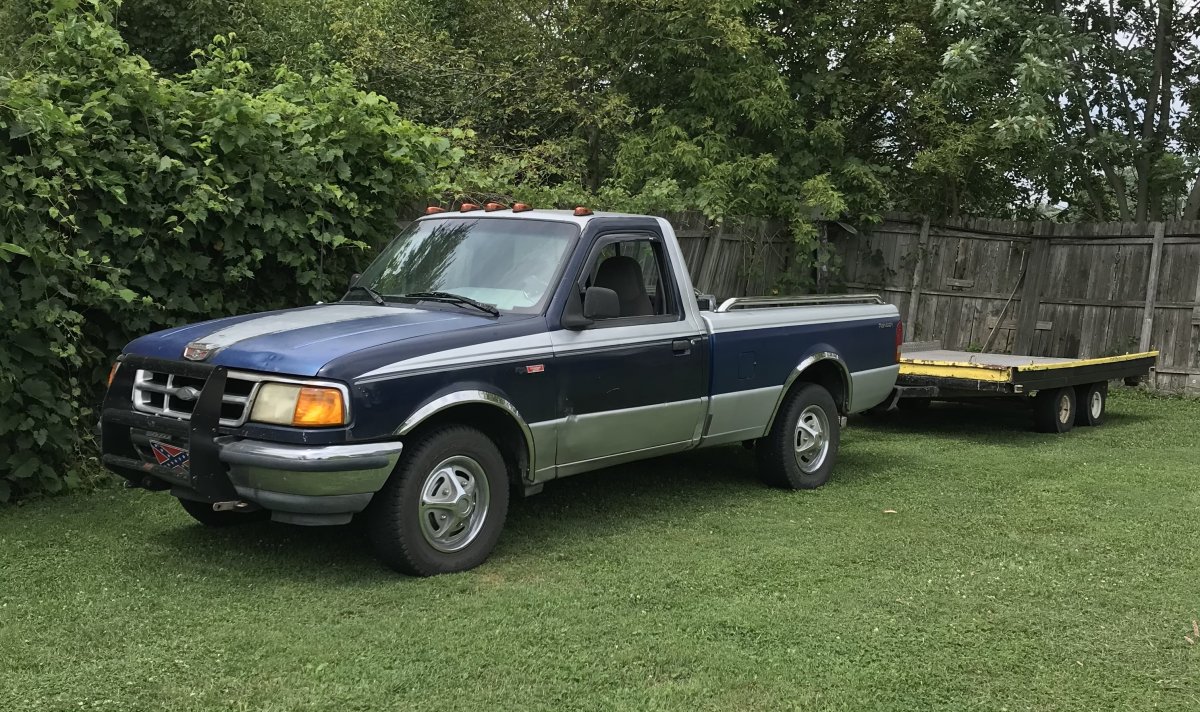

dual-plug heads are bad about cracking , but other than that its a timex watch, takes a licking & keeps on ticking. (though I never had one that ticked) Ive pulled my 6x10 box trailer many times , 65 mph is not possible, loaded its 50 at best, 4rth gear & foot to the floor. 4.10’s help but its still only 100 hp.

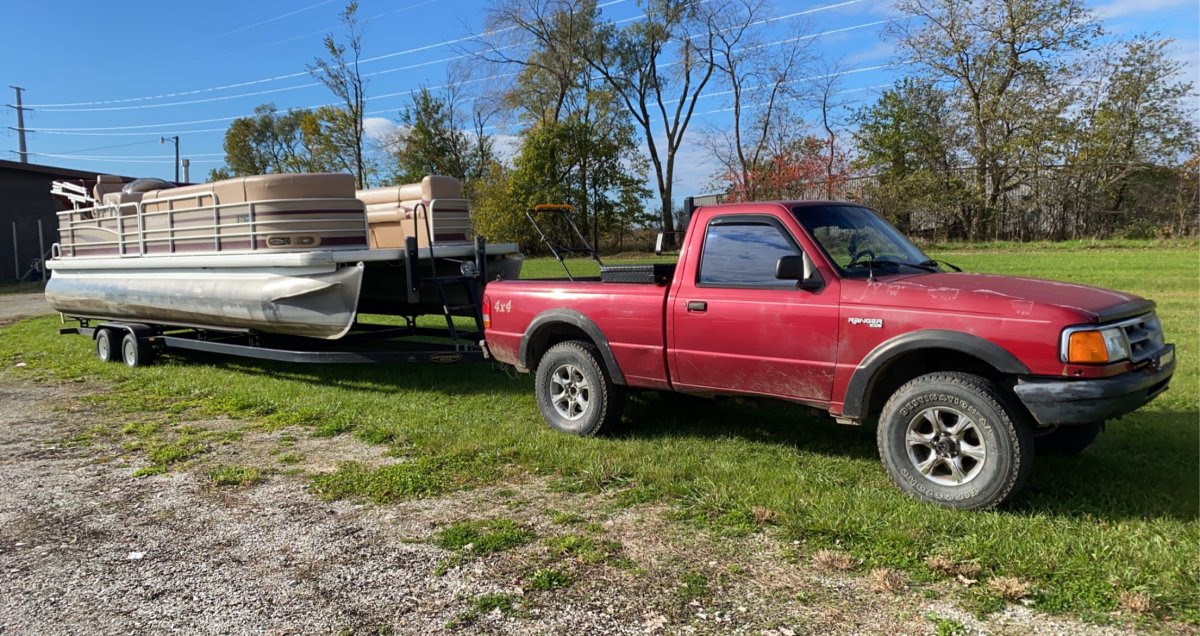

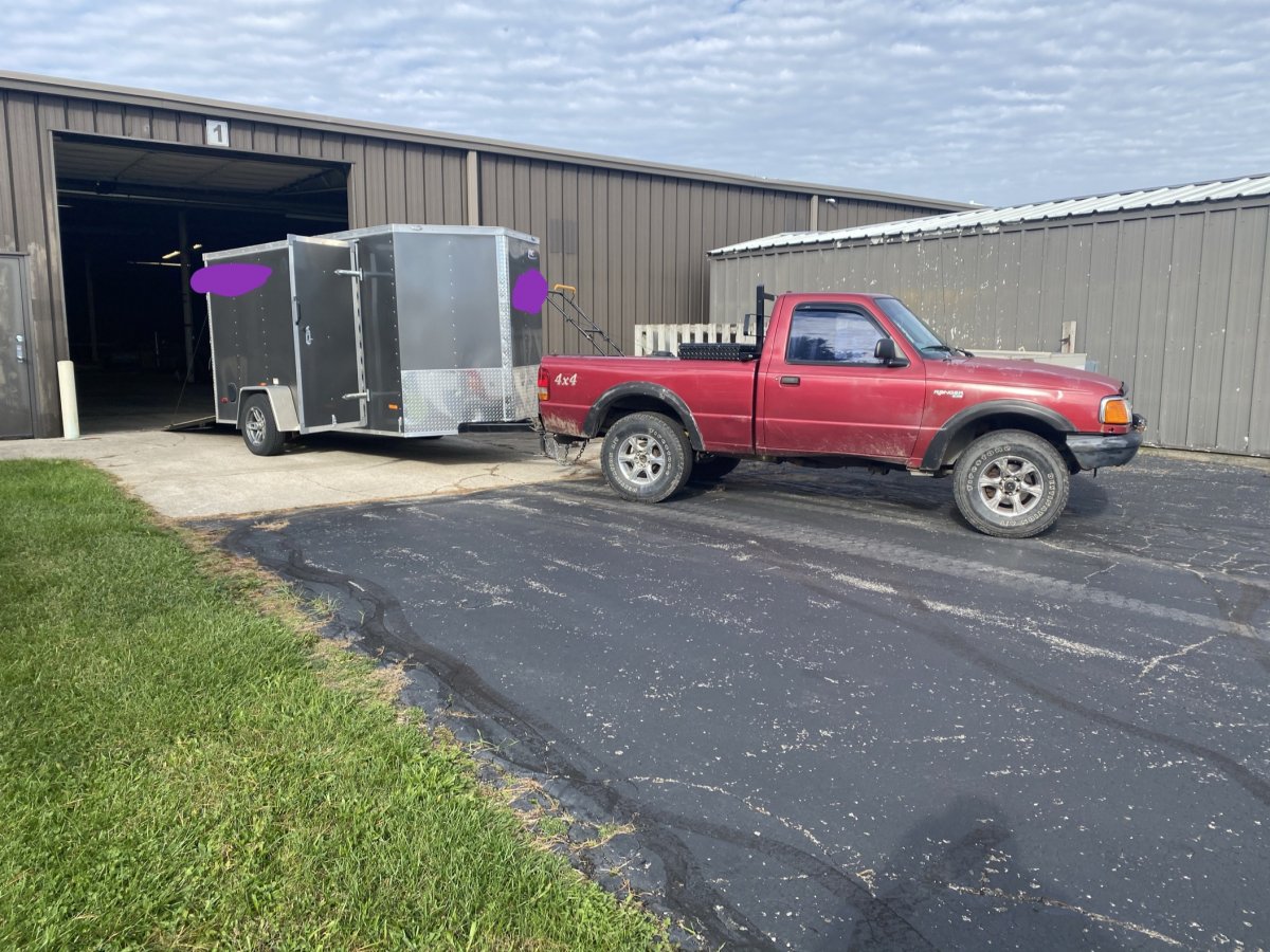

It depends on how roasted the engine is... the 2.3L is a pretty stout engine... The first time I rebuilt my 2.3L turbo engine I took a couple too many shortcuts and a few years after I rebuilt it I lost a rod nut at WOT ~5000rpm and lost the #3 rod which took out the block, piston, rod and crank so I had to start over. Using mostly what I had on hand, some rock auto rings and bearings and a junkyard oil pan I scabbed another together in 2 months and it's been going decent for a while now other than leaking a LOT of oil from random places, like I just threw it together in about 6 square feet of garage space or something... :). The other engine ran better but it could be one of the sensors or something going out, whatever, it runs and does it's thing... One time I took the work enclosed trailer with a bunch of pallets and my 3 wheeler in it to the yearly guys trip about 300 miles from home. I think there was just over 7000lb total and it did just fine, but the turbski helps in the power department...
Seems odd. Mine pulled my bosses 6x12 loaded about 33-3500lbs at 55 in 4th. Not to the floor but pretty deep into the skinny pedal. Same 2.3l m5od and 4.10s but im on 31s
2.3 the good and bad
maybe you have less miles/more compression? Im at 160K and I dont recall compression #’s (been a few years since I last checked, I think it was around 115/120). Every engine is a little different in my experience. the ‘88 2.3 I had got 28mpg with 3.73’s (2wd supercab) the ‘92 got 18 mpg at best- 3.73 2wd reg cab longbed. Current truck does 21 tops with 4.10’s and is a ‘94 2wd reg cab . Id love to try a turbo but Id need to rebuild the bottom end first.
