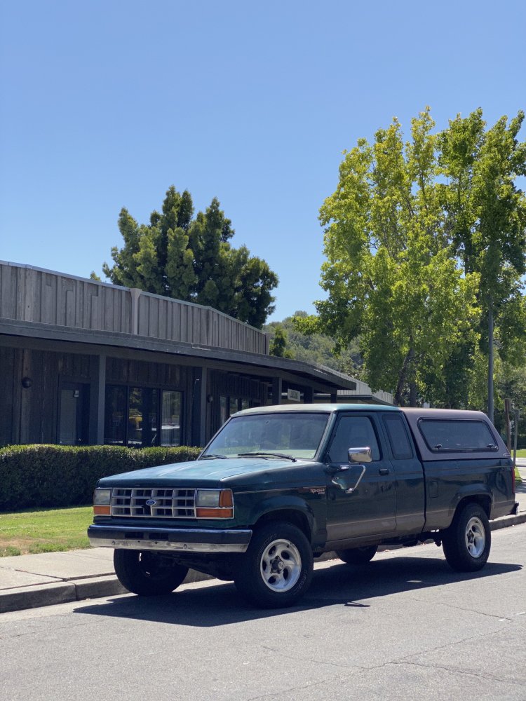

here she is in all her beauty. I love it, but man... she just sits in my driveway right now taunting me everytime I walk outside.

She looks a little banged up... but if you have no rust... it's still a winner. I like that cap too. Wish mine had side access windows.
haha yep! lucked out with the camper top forsure, I think it compliments the green nicely
