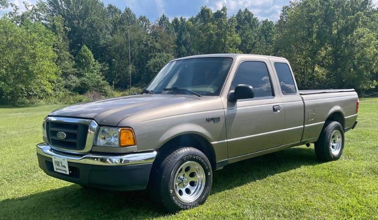

Short story I have a son who is going to be driving in less than a year and wants a truck and not a car. I am going tomorrow to look at a 2004 Ranger Xl that the neighbor of a family member is looking to sell. I haven't seen it yet but my family member knows the owner and truck. No known issues, looks very good inside and out, and has the 3.0 V6. I have been told 6500.00 cash will take it home. It is an automatic and has 115K miles on it. Other than obvious rust on the frame/shackles etc. is there any other glairing concerns I should look for when I go look at it tomorrow? I have never owned a ranger but feel like this would make a good vehicle for a new driver. I know condition plays a lot into the price but this seems to be in line with other trucks I have seen in similar condition but would love to hear any input or price or other aspects.

Here are a couple picks of the truck...
Welcome.
That's a nice looking truck, and I consider 115k as relatively low mileage. The asking price doesn't sound too out of line to me. The market's been crazy.

Rust is in fact the #1 concern, just from the pictures though, looks like this truck is well loved. They're pretty simple and reliable, there isn't too much that I know of with these things that you consider common issues.

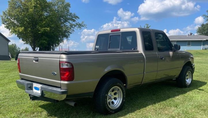

it looks nice and clean.
