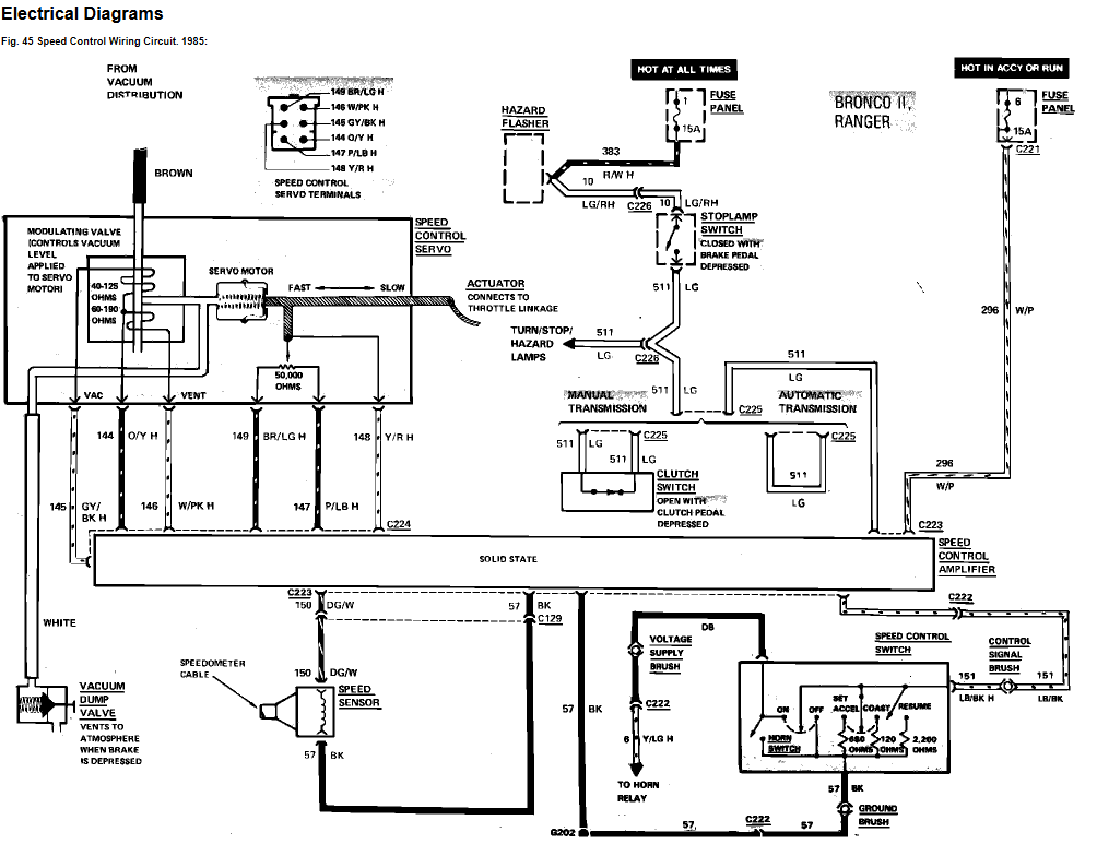

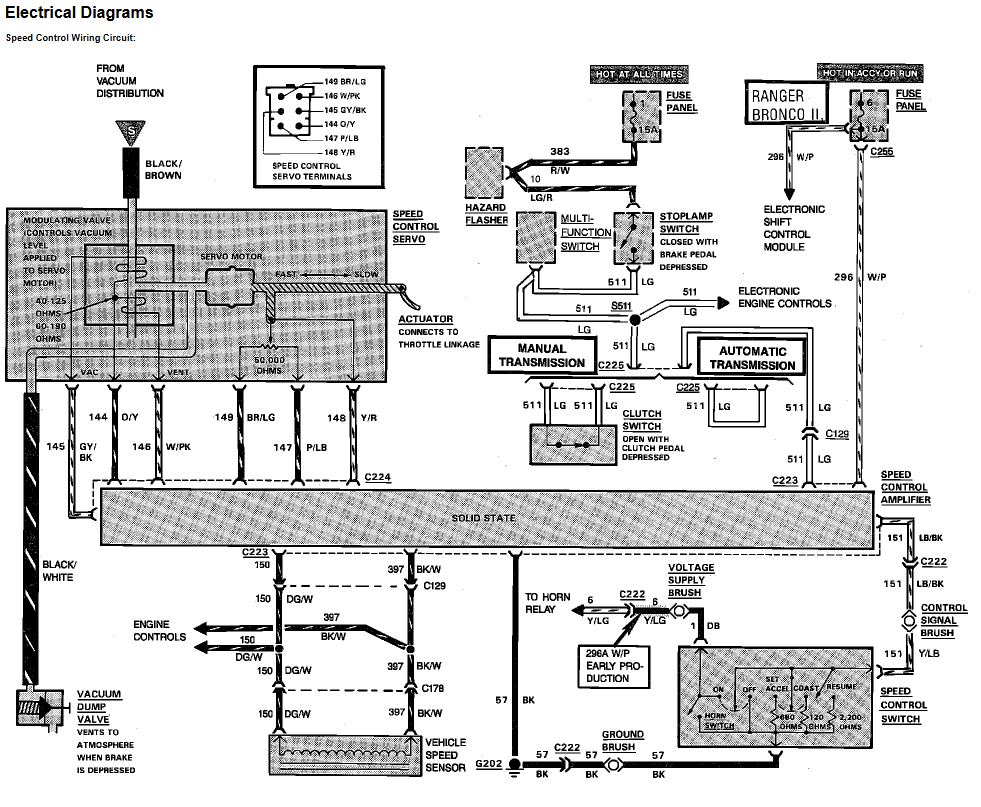

Was wondering about what it'd take to retrofit a factory cruise control to the old gal.
After looking over some diagrams and rockauto, I've identified a few similarities & differences:
1985 & earlier
- Speedo sensor connects to transmission
1986 & newer
- Speedo sensor connects to rear diff
- Switch connector (rock auto)
1988 only
- Release switch? (rock auto)
Cruise Servo/Connector/Transducer, Turn Signal Switch, & Speedo Sensor part numbers all look to be the same across all years.
So I'm guessing the current speed sensor in my TK5 should function.
I'm guessing the deviations on rock auto are related to the fuel injection/engine management?
Aside from a EEC split at the transmission solenoid*? & speed sensor controls, it looks to be a direct swap.
Parts Ito acquire:
cruise module/amplifier behind the fuse box
Entire steering column w/ switches
servo cable?
vacuum vent solenoid(atop brake pedal?)
diaphragm in the fender
associated wiring
- clutch/break switch if different than standard

Thoughts? Figured it might make a fun tech article if possible.
For a first gen the speedo only ever went to the transmission. A EVTM will help you greatly.
It isn't a bad swap using factory stuff, I did it with mine with a V8.
Watch the vacuum hose feed routing, it is a major PITA when it passes all the tests in your driveway but surges terrible on the highway... because the hood hinge pinches the vacuum line shut when the hood is closed.

Did your swap include a crossing of fuel injection and carbureted parts? (carb'd V8 on/from an FI vehicle or vice-verse)
My truck is carbed
I think the only difference between the two is the cable. I used a cable from a carbed 302 f150.
Efi pcm had a wire going to it from the cruise module, i think just so it knew cruise was in operation. I have no pcm and the module doesnt care.
