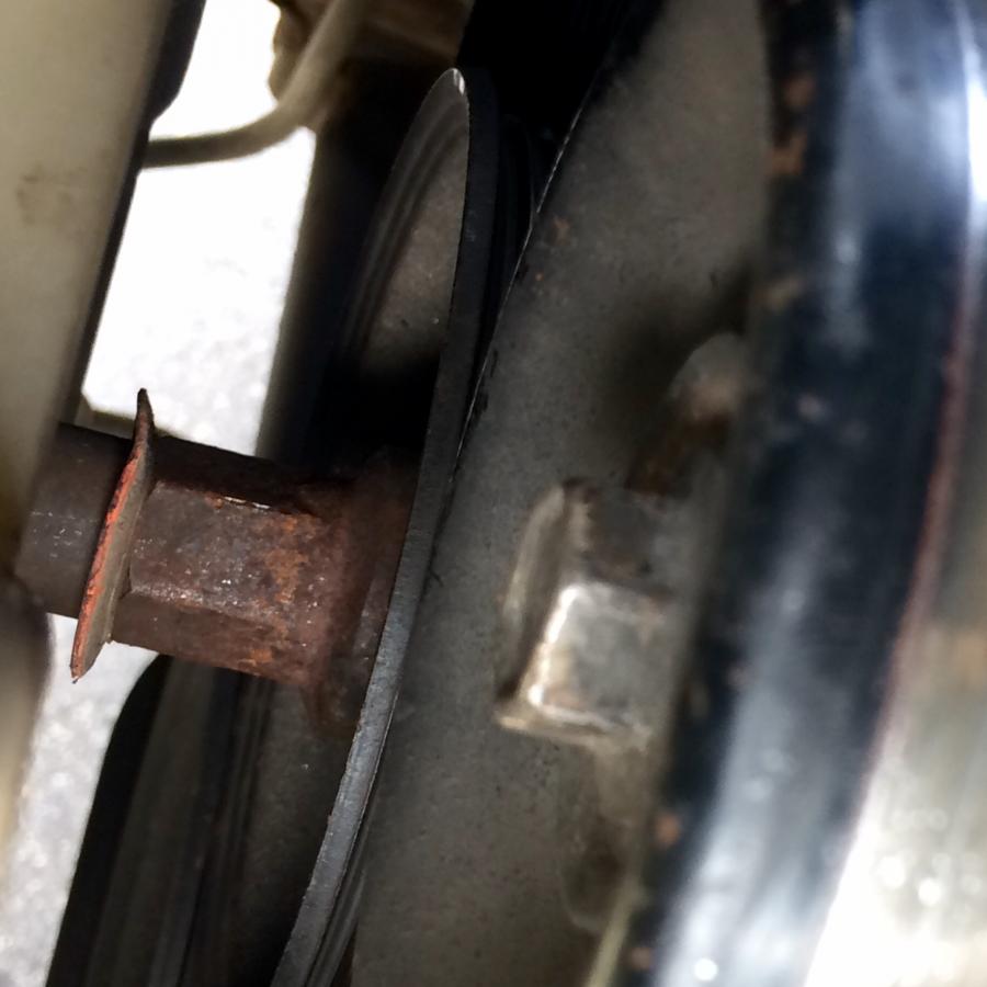

When I started messing with the fan I noticed an orange (washer) on the post, attached. I assume this is supposed to be a seal on the back side of the clutch. Also, it's supposed to spin freely with the engine off, right? It doesn't spin. So when the engine revs the fan spins full speed with the RPMs of the engine right?
I think I developed two separate problems pretty much simultaneously: fan clutch (noise) & power loss (assuming CEL related). I also suspect I need a new idler pulley & should do a new belt while I'm at it.
As for resetting the CEL code...um, no, I don't have an ODB scanner. But I did disconnect the battery when I did it & then the CEL was off for about one commute. Does that 'clear' the code, or does it needed to be electronically wiped?

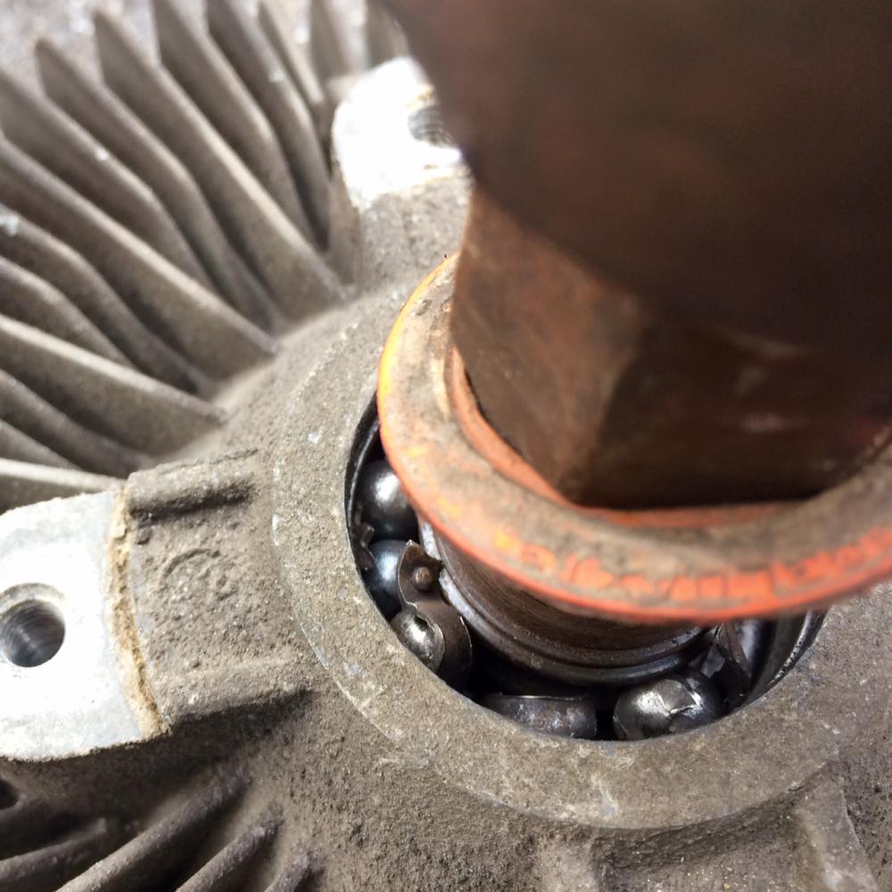

Wasn't on the agenda for this weekend, but I'm taking a small trip Wednesday...so today I replaced the fan clutch, the idler & tensioner pulleys, and the V-belt. Purrs like a kitten now, better than ever since I've owned her! Took her on a long test drive, and what's strange is that 1. performance seems to be completely restored, 2. The CEL never came back on. Could a slipping belt and drag from the fan cause those two problems somehow? I expect the CEL to come back, but it sounds & drives great again.
THANKS FOR THE HELP!!!
Todd
P.S. - attached a picture of the bad fan clutch bearing race. If your bearings look like that, you've got a problem!

Good work :icon_thumby:
I don't know, might have been a bit early to change that fan clutch, looks like it would have been good for another 5 or 10 miles
Fan was "grabbing" air and that does take horse power, so............
