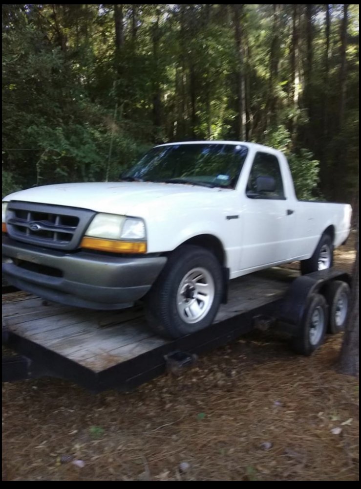

Hi all! My name is Clint. I really enjoy the site, lots of great info here! I recently bought my son a 1999 ranger with a 2.5L that needed overhaul. I am near finishing the motor and getting close to install back into the truck. Has anyone been able to mate the trans to the motor and install as one assembly? Seemed tight coming out...
